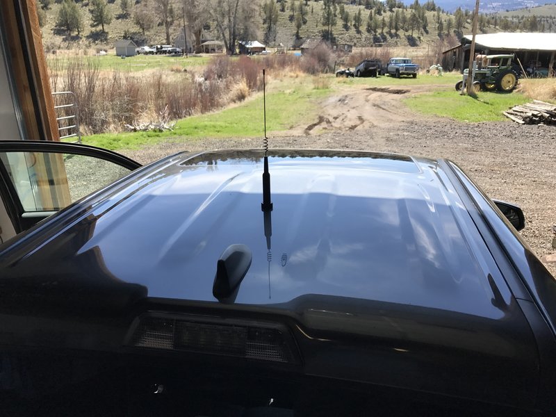

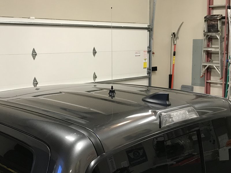

    Here are pics. I'm about halfway between the shark fin and the sunroof opening. No issues. No leaks. I do get some wind whistle however.

    Looks like it is right in front of the dome light. Great job!

    There is a structural beam that crosses. I am in front of that. You should be able to see it if you look between the roof and sunroof opening with the glass open.

    Yep, the structural beam is what the dome light is mounted to. Thanks
