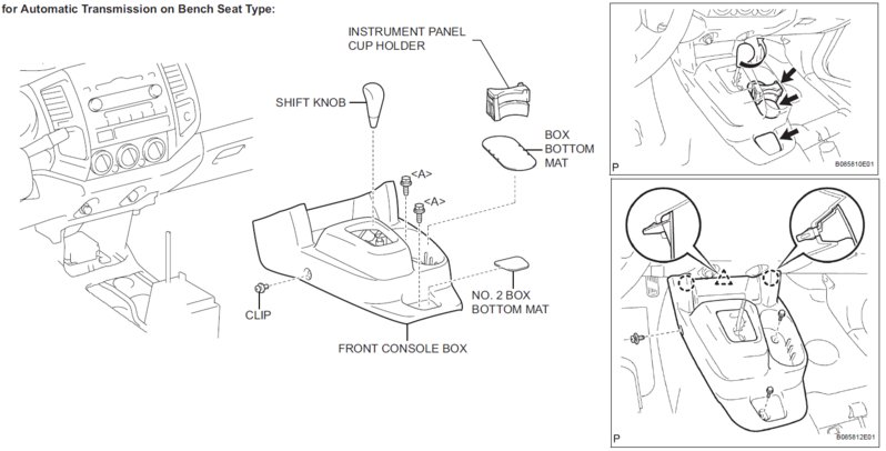

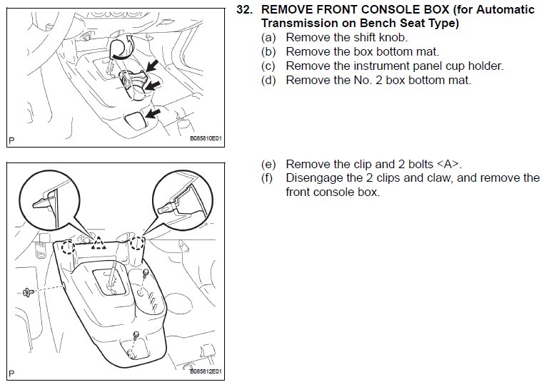

    I don't have anyone I know who has one. Would like a picture of the auto shifter bolted to floor. Researching the bolt location on single cab vs all other cab styles. The console would have to be removed for the pic. Here's what I found for the console removal.
    Shifter knob unscrews counterclockwise, mats cover bolts, driver's side has a pin clip. Console needs to be pop'd back then "slides" back from dash holes then up. We'll appreciate very much the time and assistance provided. Any takers?
