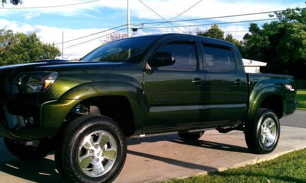

    Tinted windows 5%, sill protectors, TRD stubby antenna, weathertech in channel rain guards, wheathertech floor mats, BHLM, Truxedo low pro qt, DTRL deleted, anytime backup camera, bed storage locks, fog lights on anytime, tailgate theft deterrent, painted engine cover, relocated horns, l.e.d bed lights, l.e.d engine bay lights, l.e.d lights above cup holders, in glove box, rear cup holder, in console storage & cubby next to steering wheel, Grillcraft grill, 17x8.5 SCS Ray10's, 35x12.50 Nitto Ridge Grapplers, Borla cat back exhaust, map & dome l.e.d's, TEQ badge on grill, Redline tuning hood struts, Maxtrac spindles, SPC Light Racing UCA's, Bilstein 5100's front set at 0 with OME 885's & extended length Bilstein 5100's in the rear, All Pro expedition leaf springs & 2" blocks, extended brake lines front & rear, 1.5" 4crawler drive shaft spacer, Beefed Taco carrier bearing drop, 1.25" spidertrax wheel spacers on rear, Kenwood DNX570 touchscreen with navigation, 30" led light bar in lower bumper opening, 1/4" top plate spacer drivers side, Bullet Proof Fabricating skid plate, Cali Raised ditch lights & Rago f Fabrication brackets, Amp Research power steps, smoked l.e.d 3rd brake light, Wet Okole seat covers, under cab LED'S tied to dome circuit
    I dont know if this helps but I got 3" in the front & 2" in the rear on stock 265/65/17. I'm currently saving for larger tires.

    Pictures def help thanks! what size tires are you planning on>?

    that was def helpful the only hard part is finding pictures of ones with the base wheels and tires not the sport ones. I have the 16 in basic rims with the crap dunlops on them not the trd wheels with the 17 in. wheels

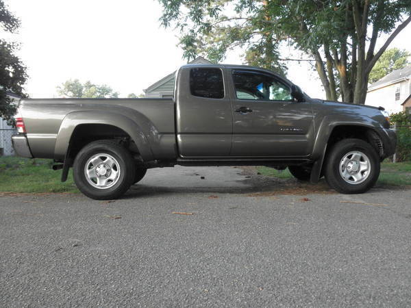

    afe pro dry, weather tech floor liners,5100's on all four corners@ 0, eibach 620 coils. toytec 3/4" spacer driver/s & passenger/s, rear spring tsb w/toytec 1" blocks, 4runner sport wheels, in channel vent visors, 1.25 spidertrax wheel spacers on the front, Wet Okole's, smity tow hook.
    5100's set at 1.75 w/tsb pack and stock tires

    I've heard that the newer taco's come with the upgraded packs. I guess you already have them? I was very pleased with the setup, ride and handling was much improved over stock. I haven't changed anything really just added to as funds allowed. My current setup is 5100's at 0", Eibach coils,Toytec .5" spacers and Toytec 1" blocks in the rear (will be replacing with a progressive aal when funds allow).
    How it currently sits w/275/70/17

    Didn't notice any real change in mpg with the 5100's at 1.75 and stock tires. I did however see a drop when I added the 275/70/17's(32.4")
