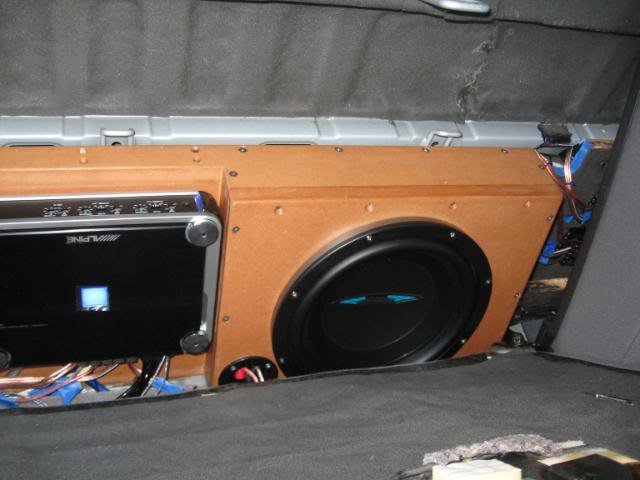

    Final Sub install with Marv box for 10" idqv3
    http://s206.photobucket.com/albums/bb256/aozzens/2006 Taco Sub Install Final/

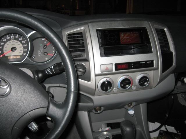

    Head unit install:
    http://s206.photobucket.com/albums/bb256/aozzens/TRUCK AUDIO/
    http://s206.photobucket.com/albums/bb256/aozzens/TRUCK AUDIO/?albumview=slideshow

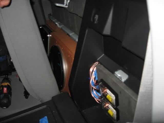

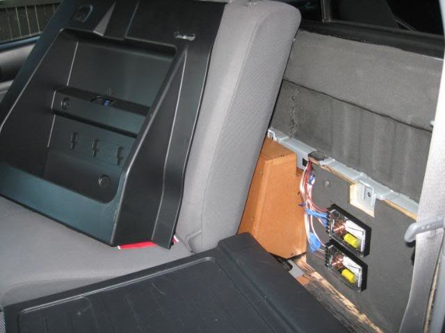

    New-> 5.22.09 Final Crossover mounting, with driver side plastic back wall re-installed.
    http://s206.photobucket.com/albums/...co Crossover Final Mount/?albumview=slideshow
    Detailed writeups would be critical but takes a lot of time. i definitely have some tips, but no time to go through all these. However, hope this helps with a visual though, or curiosity. My final amp install is not the most beautiful, but it hits hard now... Tuning is critical !

    The only thing I would consider changing is getting a 12" sub, for 1 lower note, but I am very very happy, and also proud that I did all this myself. I'd say this took me 40 hours at least.

    • jvc kdavx44 HU
    • Harness for JBL system-> Metra Axxess TYTO-01 I cut the hell out of this device. ONLY needed the plug in to the head unit cables. I ditched the lil black box and additional plug for signal cables because I ran my own... basically all I needed was red/yellow/black
    • alpine pdx5 amp
    • image dynamics ctx65s front components
    • polk audio 6.5" db651s rears
    • Custom ghetto rear baffles.
    • image dynamics 10" idqv3 sub
