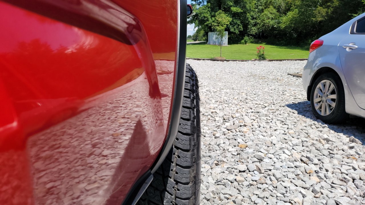

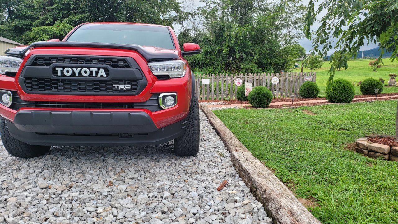

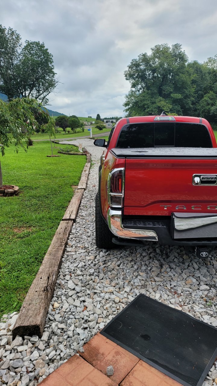

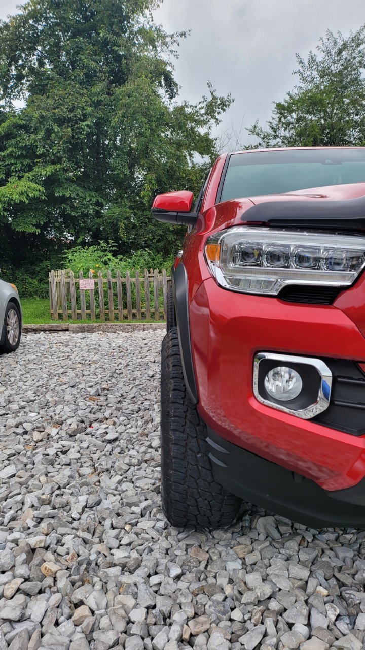

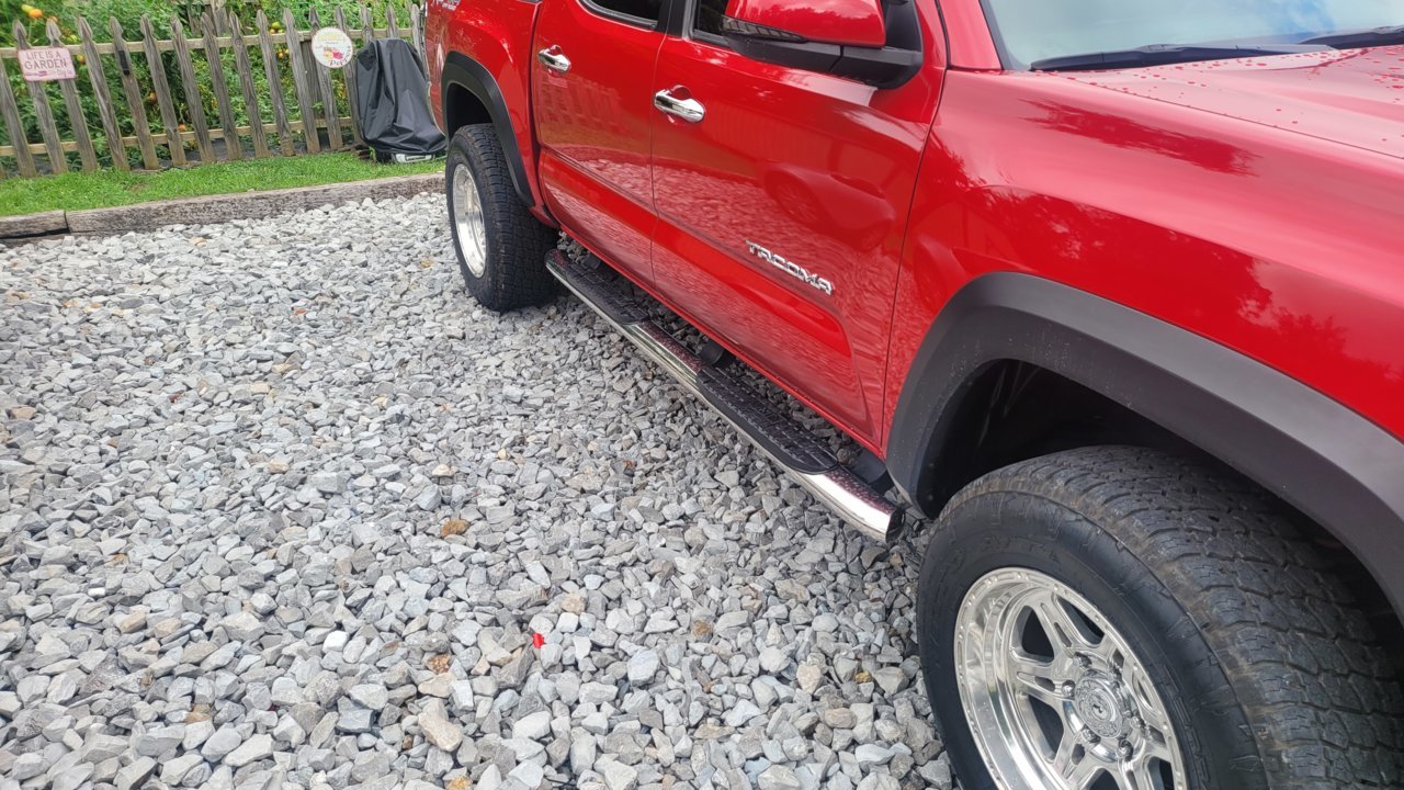

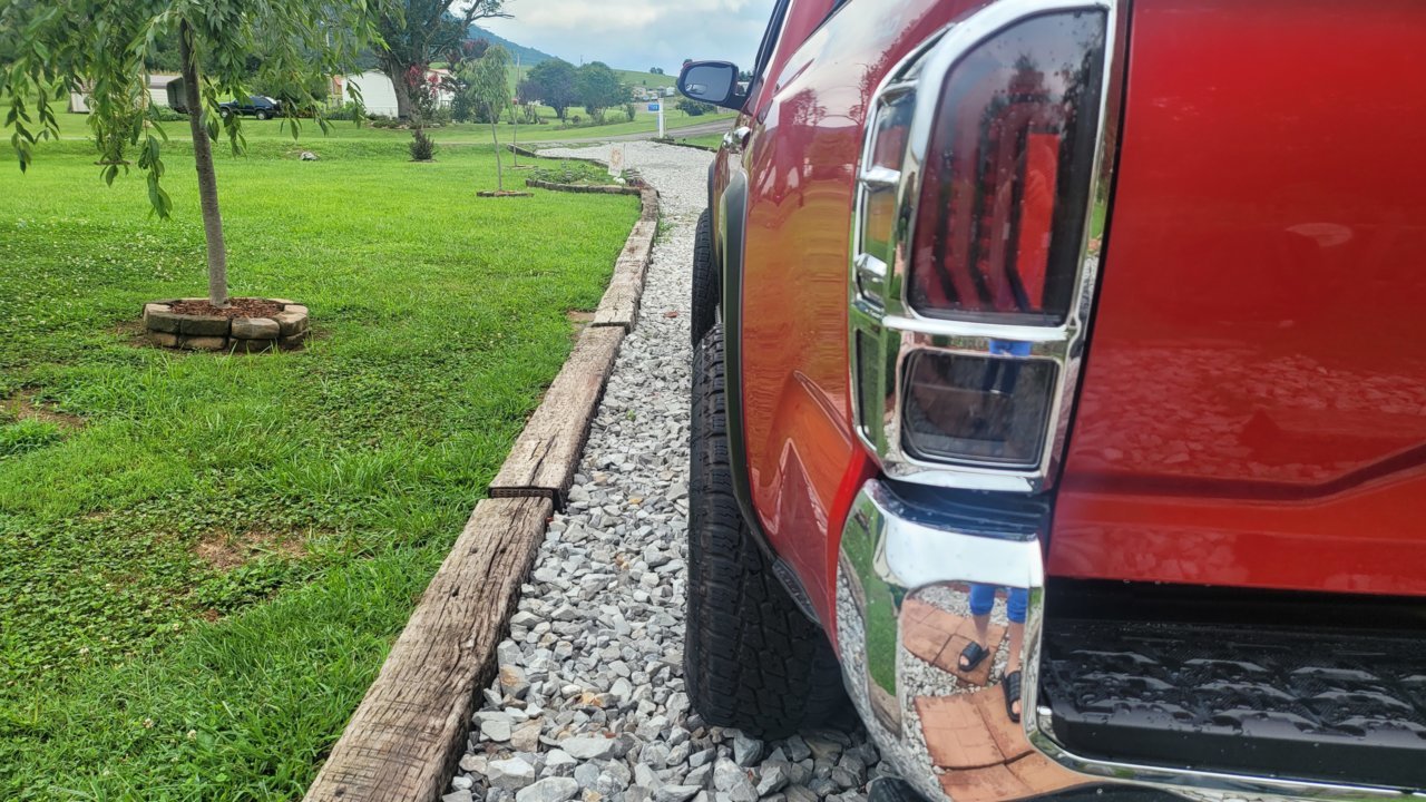

    Here are pics of them on my Tacoma..Was told it is around -32 offset with wheel spacers.

    what offset are your wheels?

    0 offset..Was told that the Spydertrax 1.25 spacers equals out to be around -32 Offset..
    I had to remove mud flaps(slight rubbing on full turn)..but was able to keep chin spoiler.

    yeah that's exactly right. offset is measured in millimeters and 1.25" = 31.75mm
