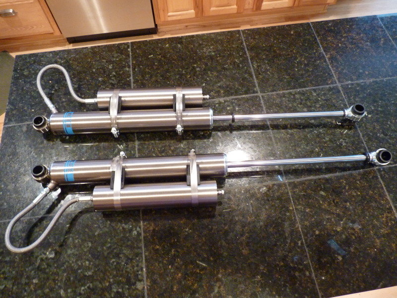

    Thinking about going this route and not mess with repositioning my rear shock mounts. Anyone want to share their pics, thoughts? Thanks

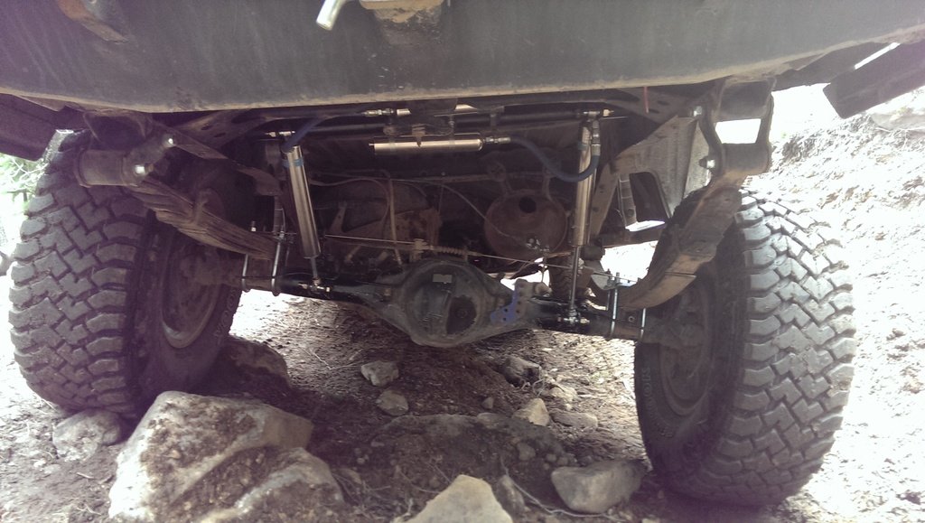

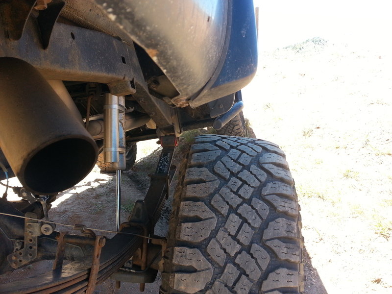

    @Lumpskie is running 12" short bodies on stock mounts. Have to pop out the spherical bearings and swap in some bushings. Stole some pictures from his build.
    IMO, stock mounts are not ideal and relocating shocks is fairly simple. I'm running 10" short bodies on a custom crossmember.

    Yes sir, like Squeaky said, I been running 12" short bodies in the stock locations since 2010 or so. Originally, I was going to relocate them later on. But, I've never had an issue and didn't see a reason to. (keep in mind, I'm also running 6" rear shackles so on stock shackles your results may vary)
