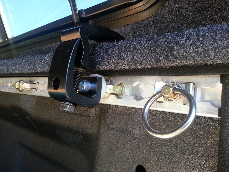

    I was going to use L-track attached to the bed rail, but the cap interferes. I think it's still a viable solution. I'll probably use a piece of flat aluminum stock to extend the bed rail below the cap so I have a place to mount the track. At least that's what I have in my head.
    Not mine, but illustrates the general concept.

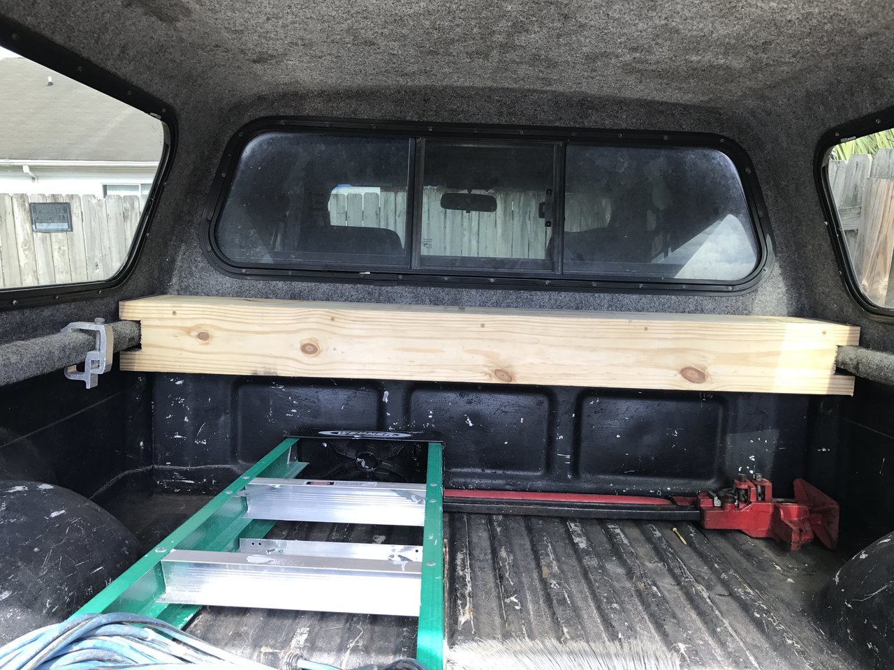

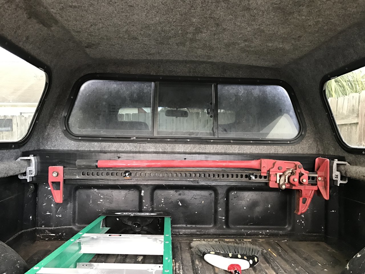

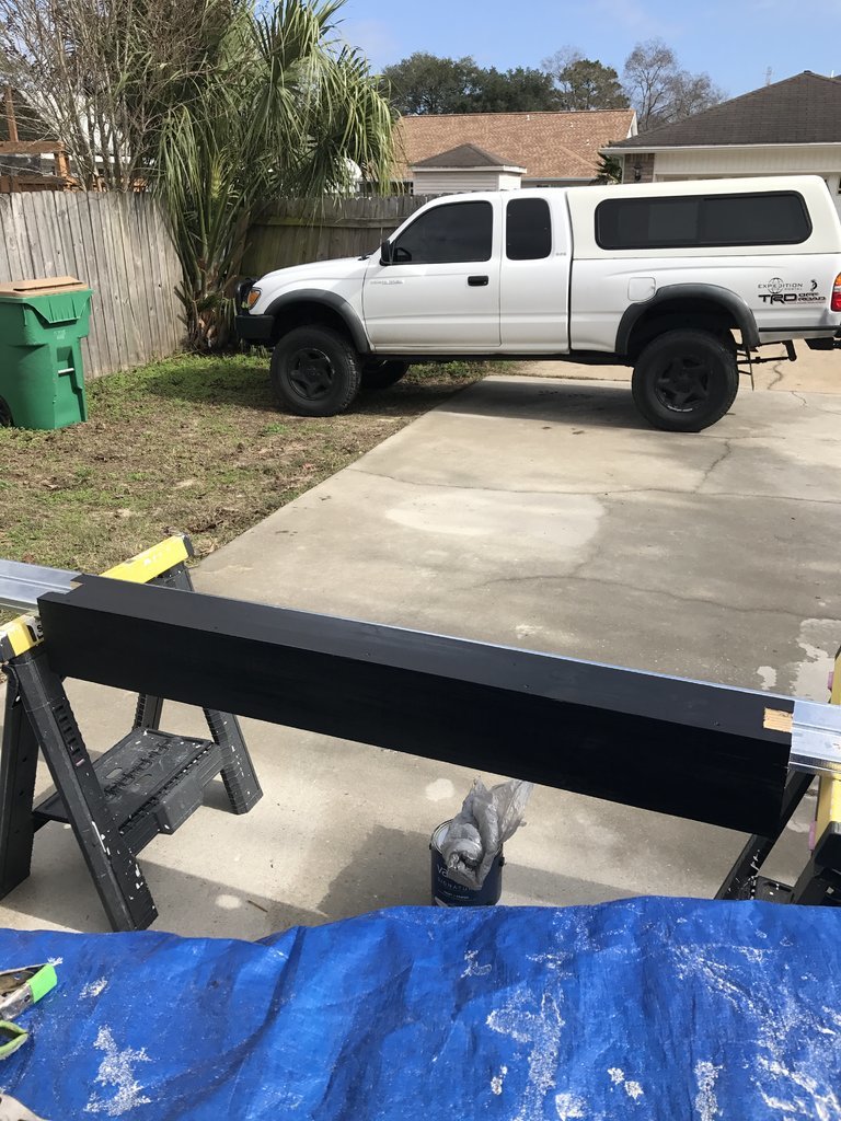

    I just used two 2x6 and notched around the bed rails and camper top. Slide the camper top clamps back flush with the wood and ran two bolts through the face of the wood to mount the jack. Shovels, Flashlights, etc could also easily be mounted.

    Is that a teeny weeny itty bitty dent in the rocker panel exactly below the lower right corner of the door (just curious)?

    :rolleyes:Well.. maybe.. I believe there are two

    That might not even be a 'dent' but maybe someone tried to jack up the truck there and screwed it up.

    Looks like a dent to me. A couple of years ago I drove east to west over Mengel Pass and a boulder reached up out of nowhere and kissed the driver's rocker panel. The repair estimates were $1,200 for an 8-inch dent. Outragious! So I ordered a special spray can of the factory paint, smoothed out the scratch, then primered and painted the dent.
    Now I have a clean, smooth, nice-looking dent... ;)

    After closer inspection it's only some dirty spots!
