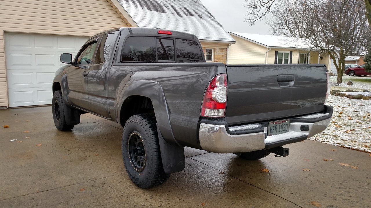

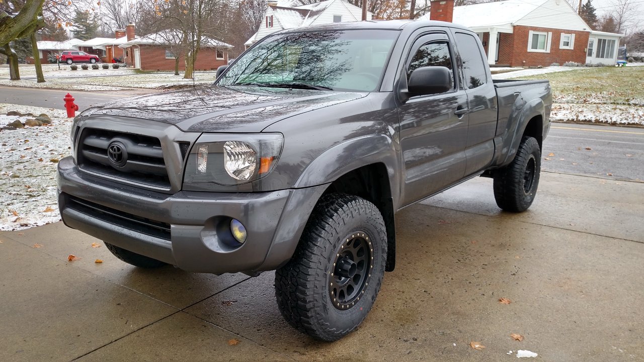

    Method NV 16x8
    0 offset
    4.5" backspace
    Looks very similar. I also wanted Ray's but they never had them in stock so I went with the NV's. I have thought about dipping them gray and leaving the beadlock black to see what it looks like, just haven't done it yet.

    Also, not sure how much into weight you are. But both Ray's and Method wheels are (claimed) 10-12lbs lighter than the stockers. So you should see a little performance gain as well. I never had my stock wheels with bigger tires for comparison, but I didn't notice much loss in power when going from stock 245's to 265/75's on my 2.7. :thumbsup:

    I'm not sure either. Yeah I waited and waited, mainly for blemished SCS's, because I really liked them. But I'm very happy with the Methods and don't regret it one bit, they are very nice wheels. I'm happy with how it's turned out.
