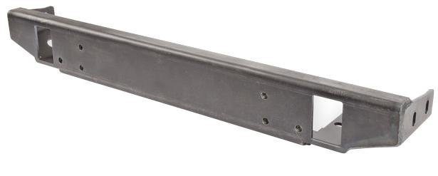

    That is a rock defense.3d0d9052027bf348d82ec4234f81f66f_2d949f2a7ac7cfe56ee58c9a85dee6b4ce4b82be.jpgThis is rock assault.

    are you sure that's the front rock assault? looks like a rear...

    I'm not following. Wait yes I do, its the supporting piece that mounts the frame and the tubing is all above it. Its the piece straight ahead in this picture.

    The photo you showed is just the frame mounting bracket that is part of the bumper and the tube bolts to the bracket. It is not sold on its own as a "complete" bumper. You are confused. A search for "rock assault" on the TG website brings up a number of items, none of which are the piece you showed.
    The TG bumpers are Rock Defense bumpers that include that bracket that make them 100% bolt on.
    You now have several pictures of the same item.

    That's what I just figured out, it really confused me because the way they set that up on 4WP made it seem like it was it's own bumper.

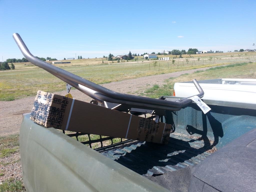

    Nope, its 2 piecs. The bracket uses the 4 bolts on the bottom and the 4 bumper mounting bolts bolts on either side. Then the bumper itself mounts through the 6 bolt holes you see on the front. Excluding the paint time and assuming you know ahead of time to remove the stock cross member, a couple hours start to finish. If you don't know to remove the cross member, a couple days full of profanity.
    Mount in the box.

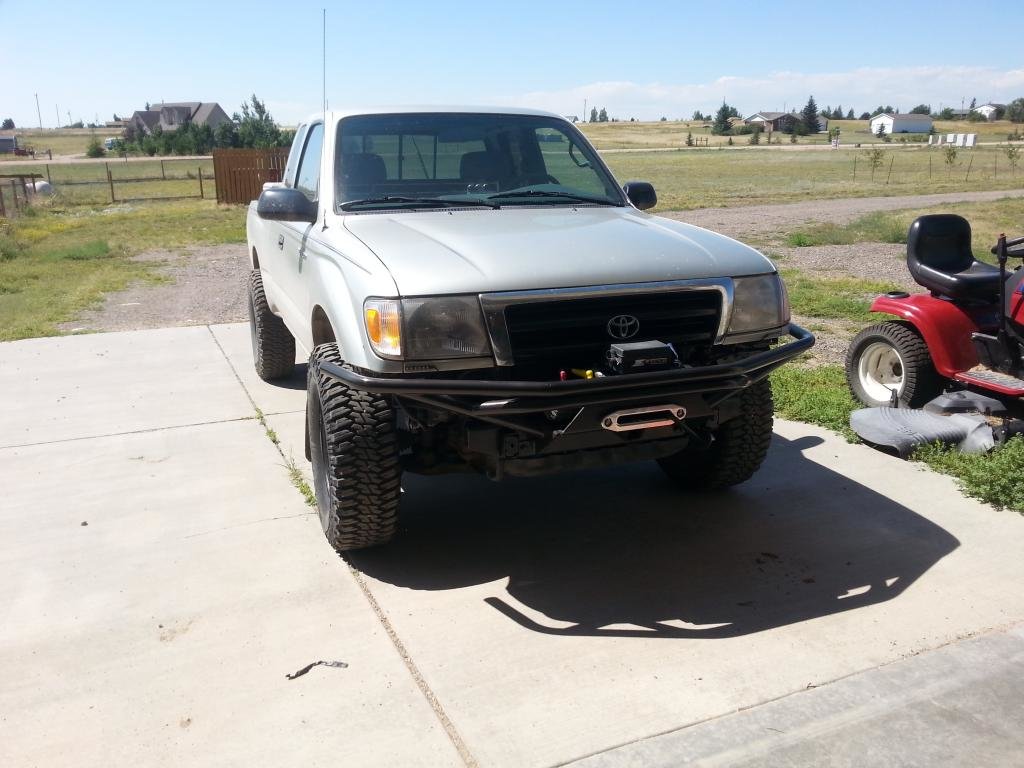

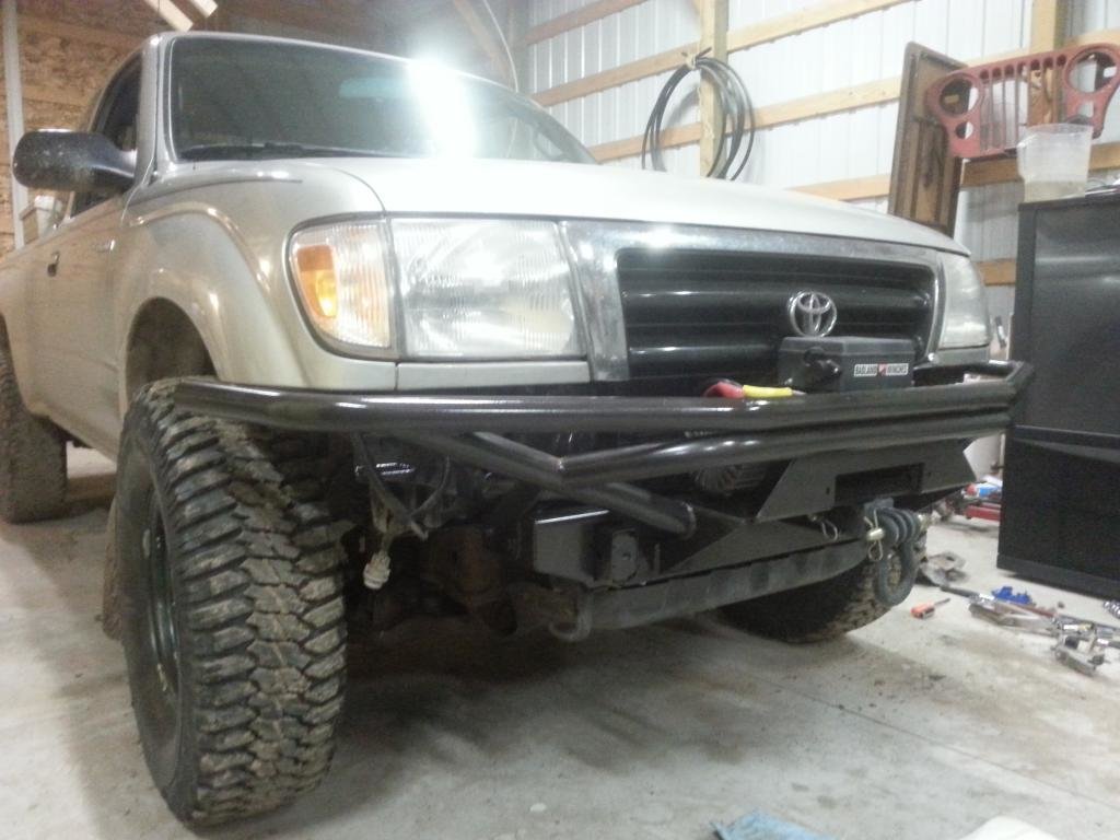

    Both on the truck.
    And done. There isnt room for a roller fairlead, you have to use hawse and synthetic with this one. I think stingers look goofy :laugh: but I wouldn't mind a short square top for a light bar mount.

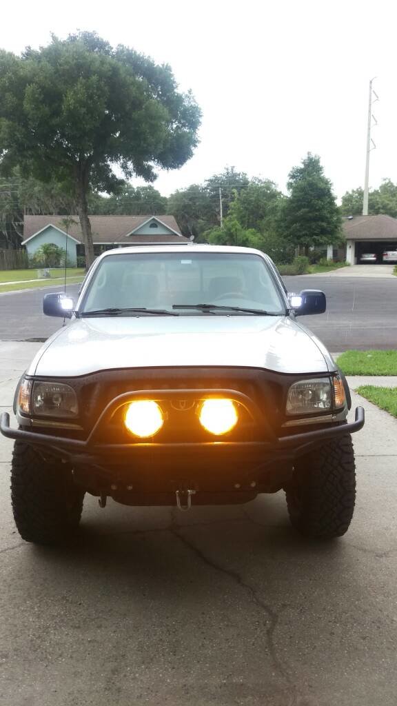

    I love mine!

    Did you guys request the smaller squared off stinger like that instead the big round one? ^^^

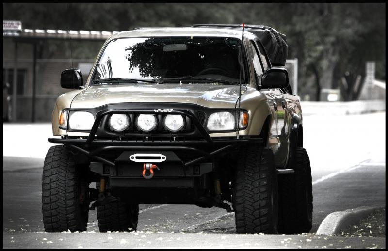

    We both have the light hoop that we welded to the low profile one with no stinger.

    Ordered it seperately and welded it on after purchase!
