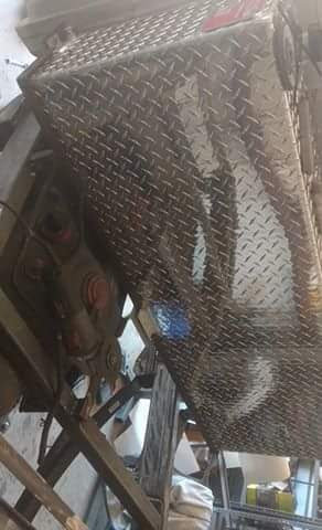

    Hey Tim,
    So sorry for not responding. I opened up the PM on a very busy day at work, and completely forgot to come back to it and respond.
    to answer your questions, Yes, I am still happy with it. there are some tweaks here and there that'll i'll make one of these days, but they are low on the list of priorities. I do have it on my list to pull the whole system out and check it for cleanliness. I'm sure it's fine, but I just want to make sure that a marine tank is holding up well in an off road environment.
    my favorite part of it (other than the obvious range improvement), is that it takes up zero usable space. just like your are doing, mine is hidden in what is normally dead space for leaves and trash to collect under the tool box. I like the 45 you are using, but I'd recommend looking for an adaptor that can go on it, to extend the fill port to a more reachable area. I hated crawling into the bed to fuel up, so I ran a fill hose to the side of the truck, mounted to my bed rack.
    as for the fuel pumps, i was having trouble finding gasoline transfer pumps for a more reasonable price, so i went with dual high pressure pumps. obviously there is no high pressure need, which is great, because the pumps will never be under a heavy load, which should extend their life. with duals, the combined GPH made for an acceptable transfer time, as well as having a failsafe if one pump failed.
    my total transfer time has been averaging about 25 minutes for the 15 gallon tank, so with your 100gph pump and a 17 gallon cell, you'll be just under half the time mine takes. only thing you'll have to be careful about is not overfilling your factory tank. with a full 17 gallons, and a transfer time of just a hair over 10 minutes, you'll want to wait until your empty light comes on before flipping the switch. with 15 gallons and a 25 minute fill time, i wait until the fuel needle gets just under 3/4 of a tank.
    hope this helps.

    I do have one question. Do you know What size hose the factory fill is?

    unfortunately I don't recall, and it's not super easy to get to for a measurement.
    you can probably get a good guess from these photos though by scaling off a bolt head or something else on the tailgate.
    the bottom one was what I first made, but ended up being a little too big. the filler neck is stretchy, but not that quite enough to fit that one. the top one was what ended up working.
    second photo is everything clamped together.
