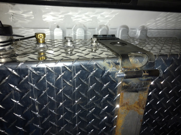

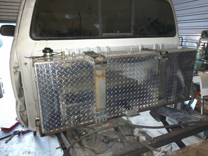

    I wasn't real impressed with the way this thing mounted. Just 3 tabs to hold it down. SO I built some straps to secure it. There's room for a little rubber under the straps to prevent any rubbing. I'll figure out plumbing later
