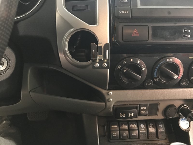

    I popped the 4x4 selector out of the dash today. Don't use it anymore with the FJ case. I think I'll put the fuel gauge there. The opening is roughly 2 1/4". I think with a trim bezel on a 2 1/6" gauge I'll be good to go.

    That would look very clean in that spot with a bezel to take up the gap.

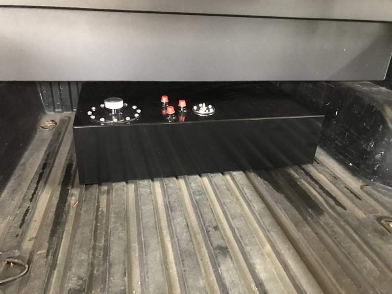

    Here we go...
