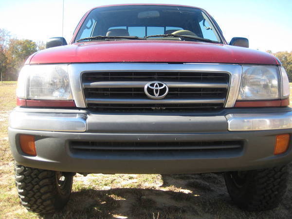

    Repainted my grill center, brushed the crome with scotch-brite to dull it and restored headlights today. Pretty happy with the results.

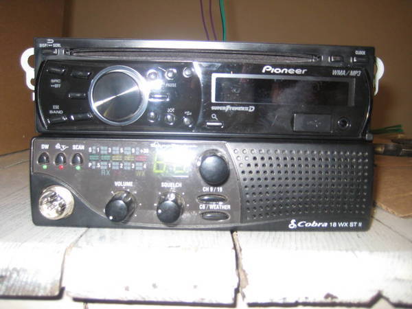

    Got a few things going this week. Heres the new heads unit ready to install with my old CB mounted underneath.
    And installed in the truck.

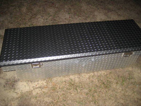

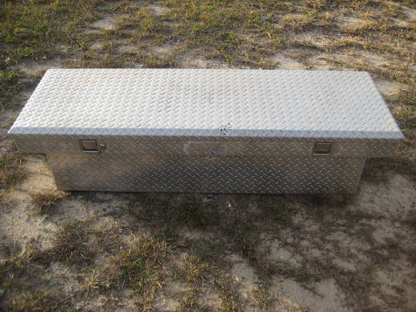

    $85 for the head unit. already had the CB and the wiring kit for the head unit from an old yota. Also scored a UWS toolbox on Clist for $75, kinda rough will be getting painted matallic grey.[​IMG]
    And with the lid painted.

    how did you sand? or did you just start spraying?

    I used scotch-brite red pads to sand, wiped it down with denatured alchohol, then used paint for aluminum wheels, so I sprayed it directly to aluminum, no primer, we'll see how it holds up

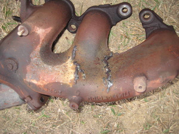

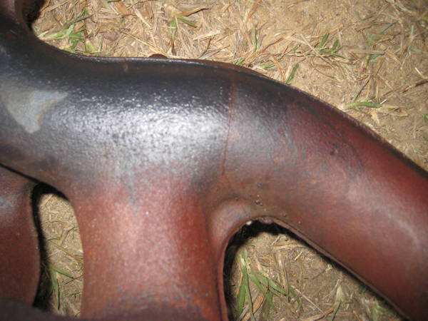

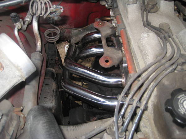

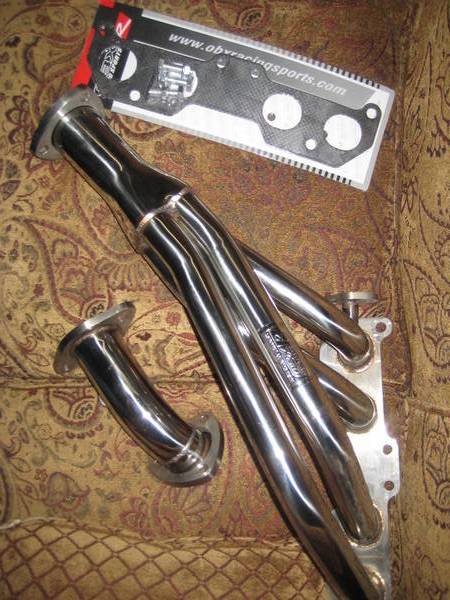

    My header arrived. Looks nice, but definately not a complete kit. the only gasket that came with it is the header gasket.
    First the old manifold
    And now the new header
    I haven't gotten everything buttoned up yet. Won't fire her up til tomorrow. OBX stainless header $275
