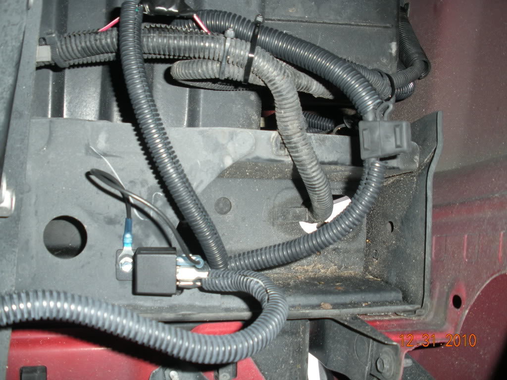

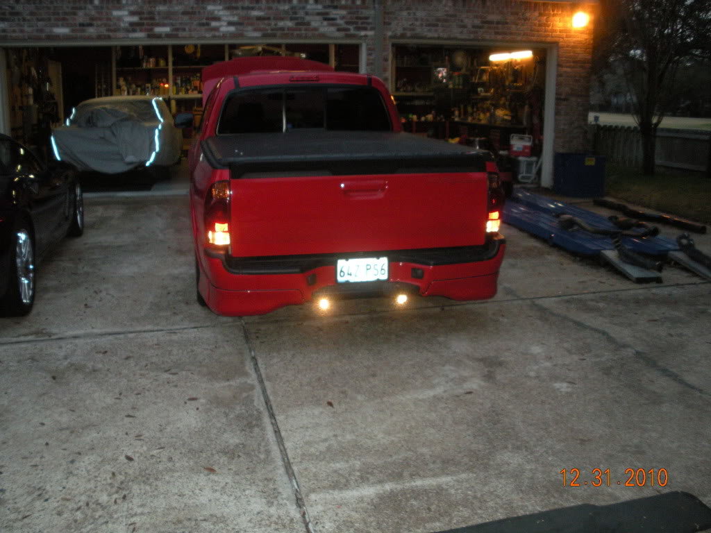

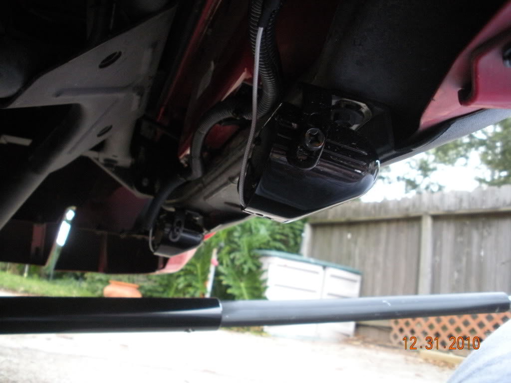

  8. Apr 12, 2012 at 2:11 PM
    Coupe
    Coupe Well-Known Member
    Feb 10, 2009
    #13485
    3,279
    Houston, Texas
    08 X-Runner
    Lots baby!
    Tucked mine tight under the bumper. These are small lights.
    TripleGagePod001_bbe6034f154d47cd565f311c9f2960429dac6fbb.jpgTripleGagePod003-1_9c0535e3183b9264a59c1f23d0d773c41558dd66.jpg
