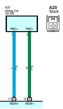

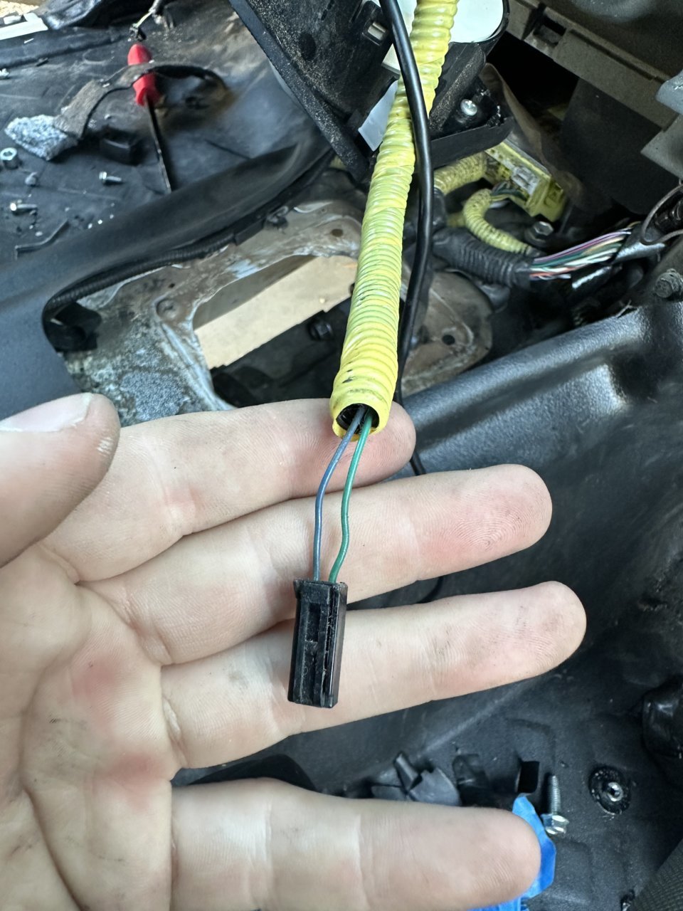

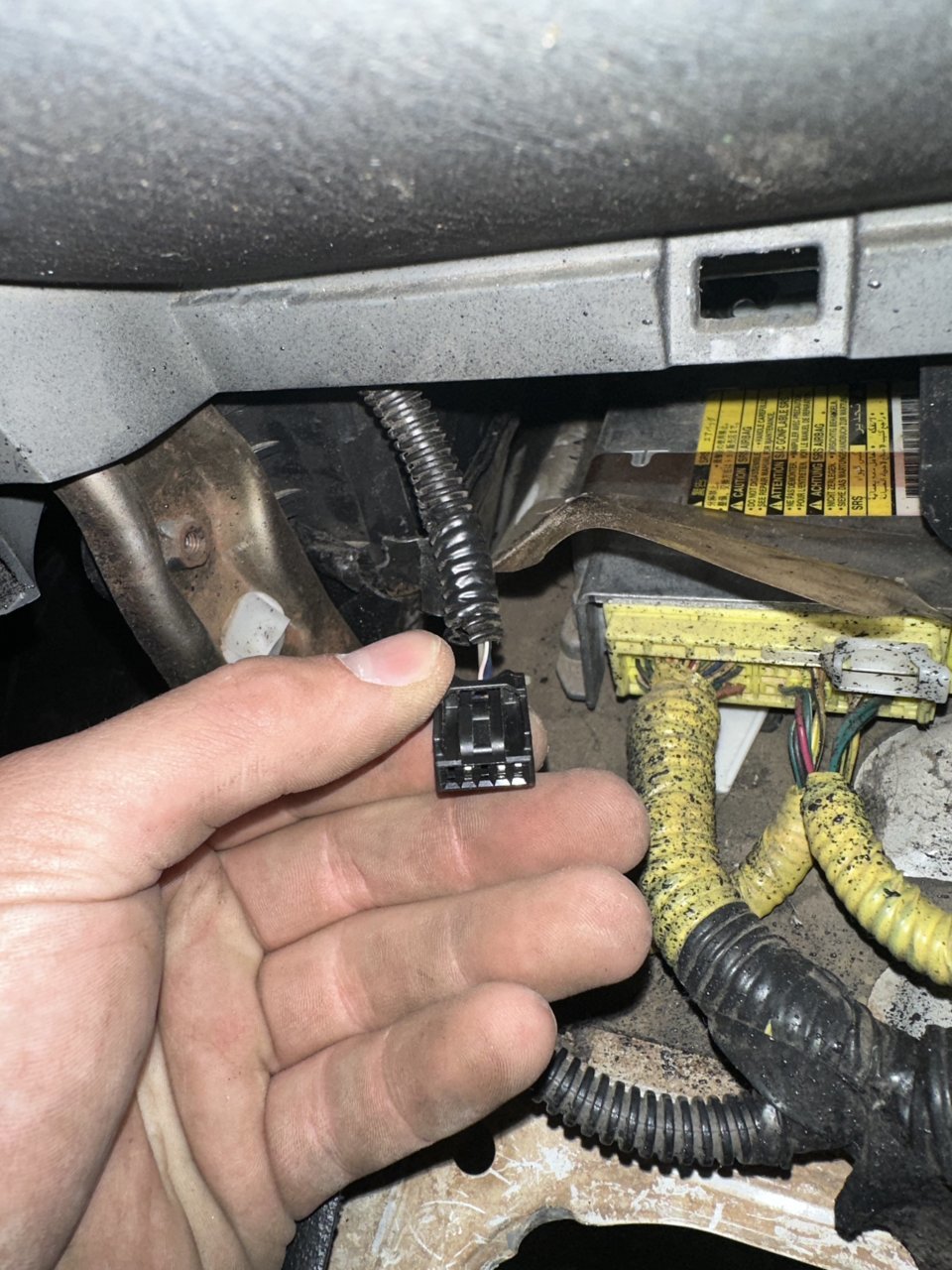

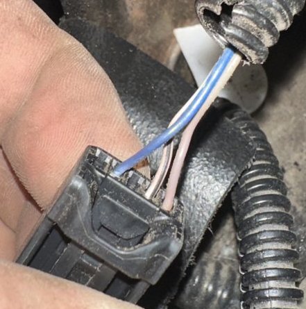

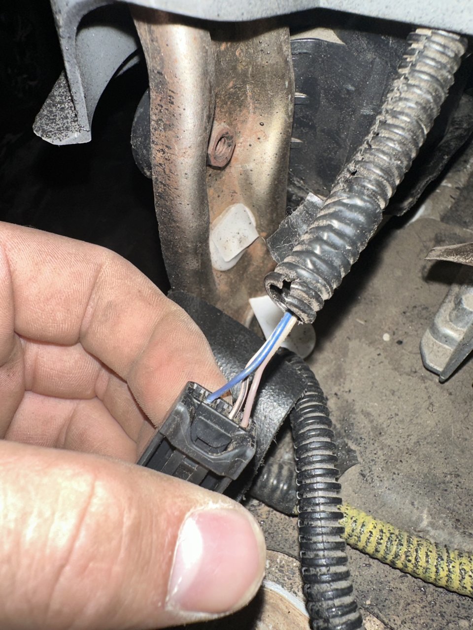

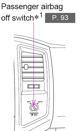

    While I have ya, can you tell me where this SRS wire goes? It’s in the center simple area IMG_4602.jpg

    What are the wire colors?
    I'll look it up when I get back in the house.

    Blue and Green
    Dm93[QUOTED] likes this.

    I was wondering where the fuck that went. I don’t have an airbag switch on my truck. I didn’t remember unplugging snything SRS Related besides the dash airbag for the passenger. Thanks a million guys

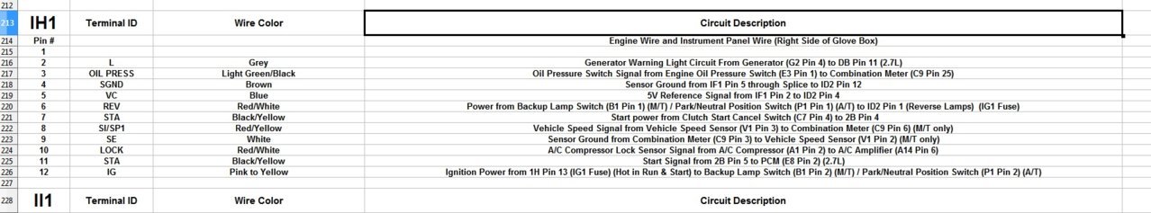

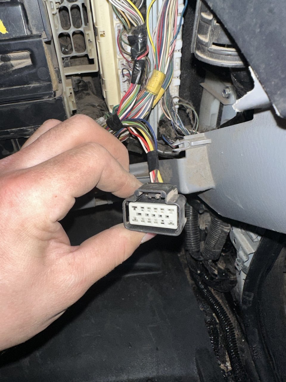

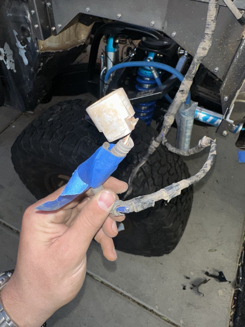

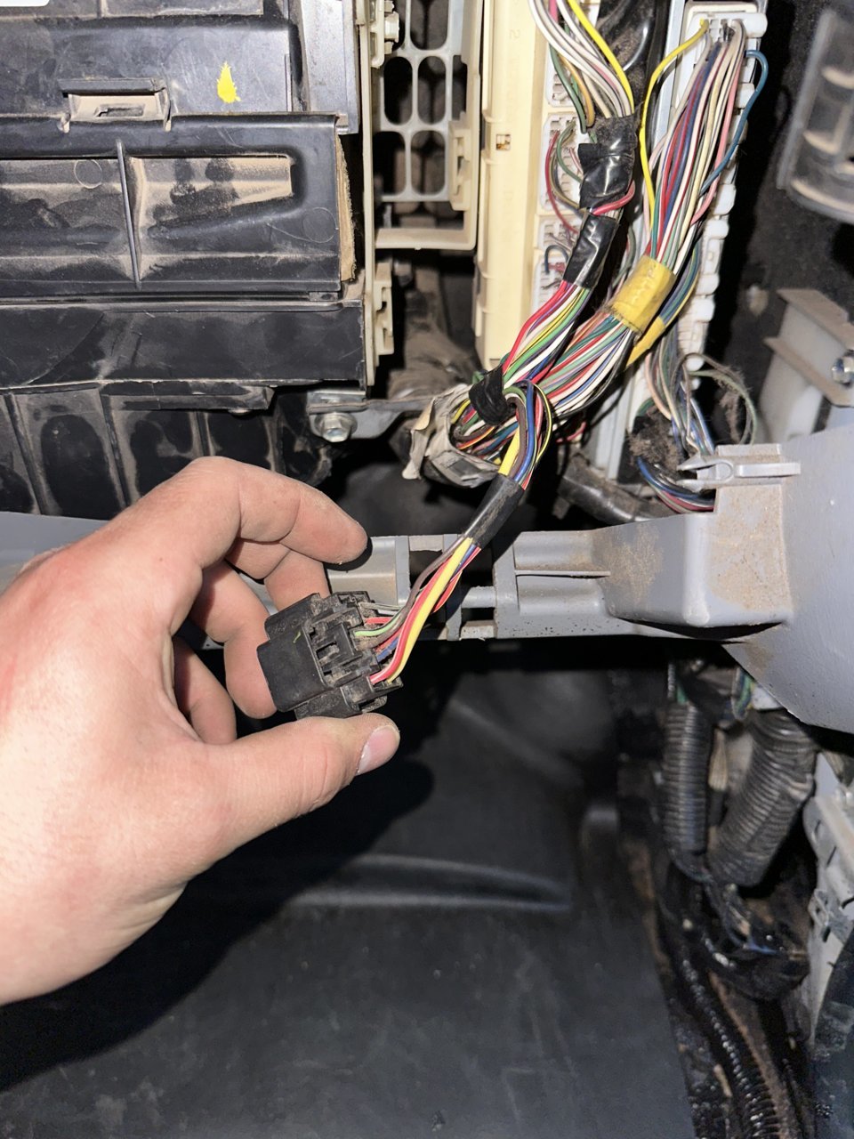

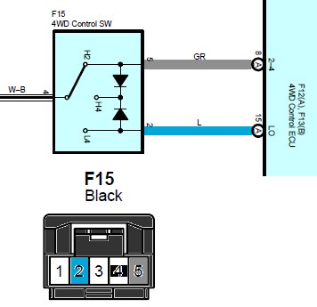

    Got a few more for ya:
    in the center console area:IMG_4618.jpg IMG_4617.jpg
    In the ecu area:

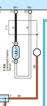

    Loomed with the ac compressor harness, looks to be shielded(pigtail is cut off but has blue shielding, wires are black and white:

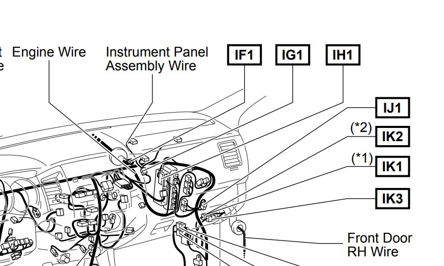

    I think the first one is F15 (4wd Control Switch)
    Pretty sure the 2nd one is IH1, not sure about the 3rd one can't see it or the wire colors well enough.
    Full Pinouts for all harness joining connectors and junction connectors for 06 (07 should be the same or very close) can be found in the file posted here.
    https://www.tacomaworld.com/threads/junction-harness-connector-pinouts.798000/
    Pittsy[OP] likes this.

    Appreciate it a bunch! Yeah the last one is loomed together with the ac compressor harness, it’s a shielded pair of black and white wires.

    Best guess is crank sensor wires, it has Black and White shielded wires and is near the A/C compressor.
    Pittsy[QUOTED][OP] likes this.

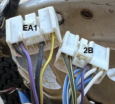

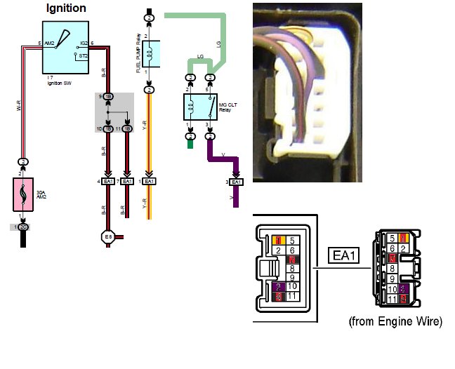

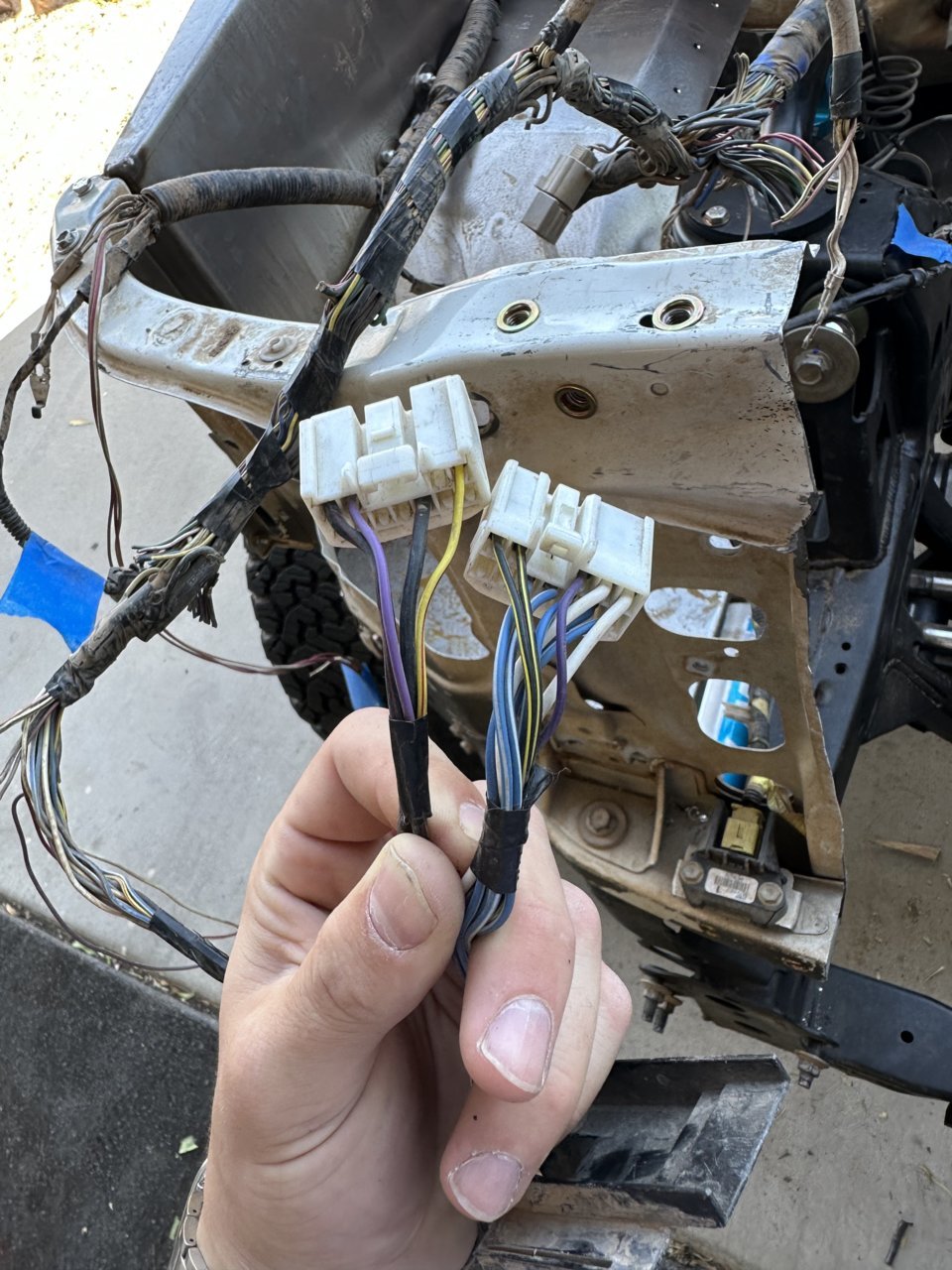

    @Dm93 could you tell me what these two pigtails do? They connect the main engine harness to the fuse box.
    Basically what I’m wondering is if I even need to have these plugged in to still have full functionality with the ignition system and immobilizer.
