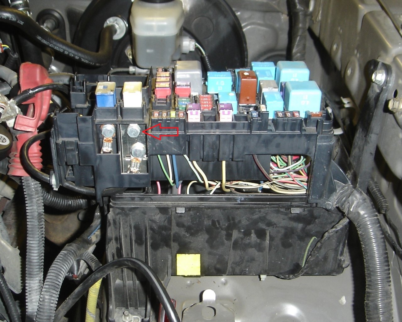

    Your yellow arrow, what’s it pointing to? Is it pointing where the little black wire goes to inside the fuse box? Can you post a picture of your stock battery wiring?

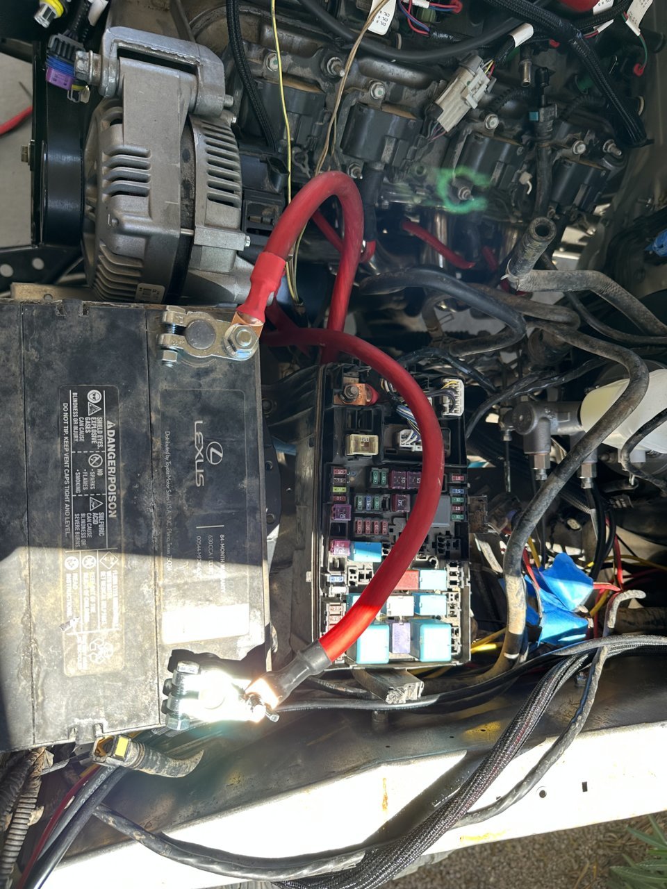

    I still don’t understand why the body of the alternator and the positive wire beep with a continuity test

    It's pointing at the bolt below that fuse where the ring terminal of the wire bolts to the fuse box, you have to partially disassemble the fuse box to access it.
    I can try to get a better pic of it tomorrow if it's visible.

    And the black wire that’s coming out of the side of the fuse block is secured to that bolt?
    This is the thread I was looking at. Maybe I misinterpreted it.
    https://www.tacomaworld.com/threads...-2nd-gen-tacoma-writeup-with-pictures.664674/

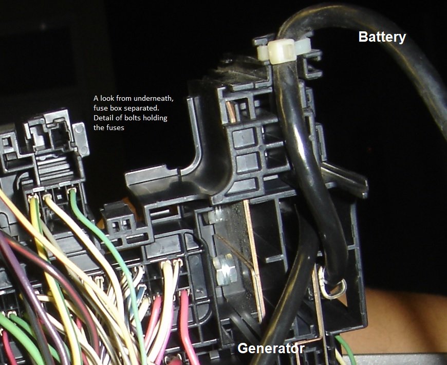

    Did you have your meter leads the right way? Remember power can flow through the alternator diode in one direction.
    Best I can make out what he did he didn't do it correctly so it would maintain the factory alternator fuse, he essentially bypassed the alternator fuse.

    I don't know, it could be finding a path though anything that's connected even without a short to ground.
    A light bulb will read continuity but isn't a short.
    Sure you could have a short but that's something you have to find out.
    If you want to be safe get you a fuse holder and a 10 amp fuse and put that between the battery and truck terminals first so if you have a direct short somewhere the fuse will pop instead of wires going up in smoke.

    Arrow is indicating bolt that secures fuse to buss bar.

    So the thick blue with black wire should attach where that red arrow is?

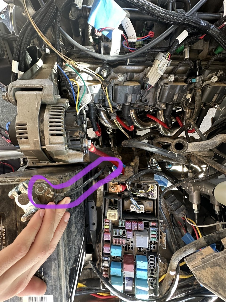

    Okay, the only wire I have hooked up is the thick red one from the alternator post to the post inside the fuse box. The black wire(highlighted purple) has continuity with the body of the alternator/engine block. Surely that’s not a ground? When I wire that black wire directly to the alternator like a previous post suggests, the alternator post and body are a dead short, even with the red cable disconnected.

    All my fuses in that box have continuity with ground as well…
    am I tripping or is everything acting as it should?

    Worlds biggest dumbass. Had the keys in the ignition for the steering lock…
