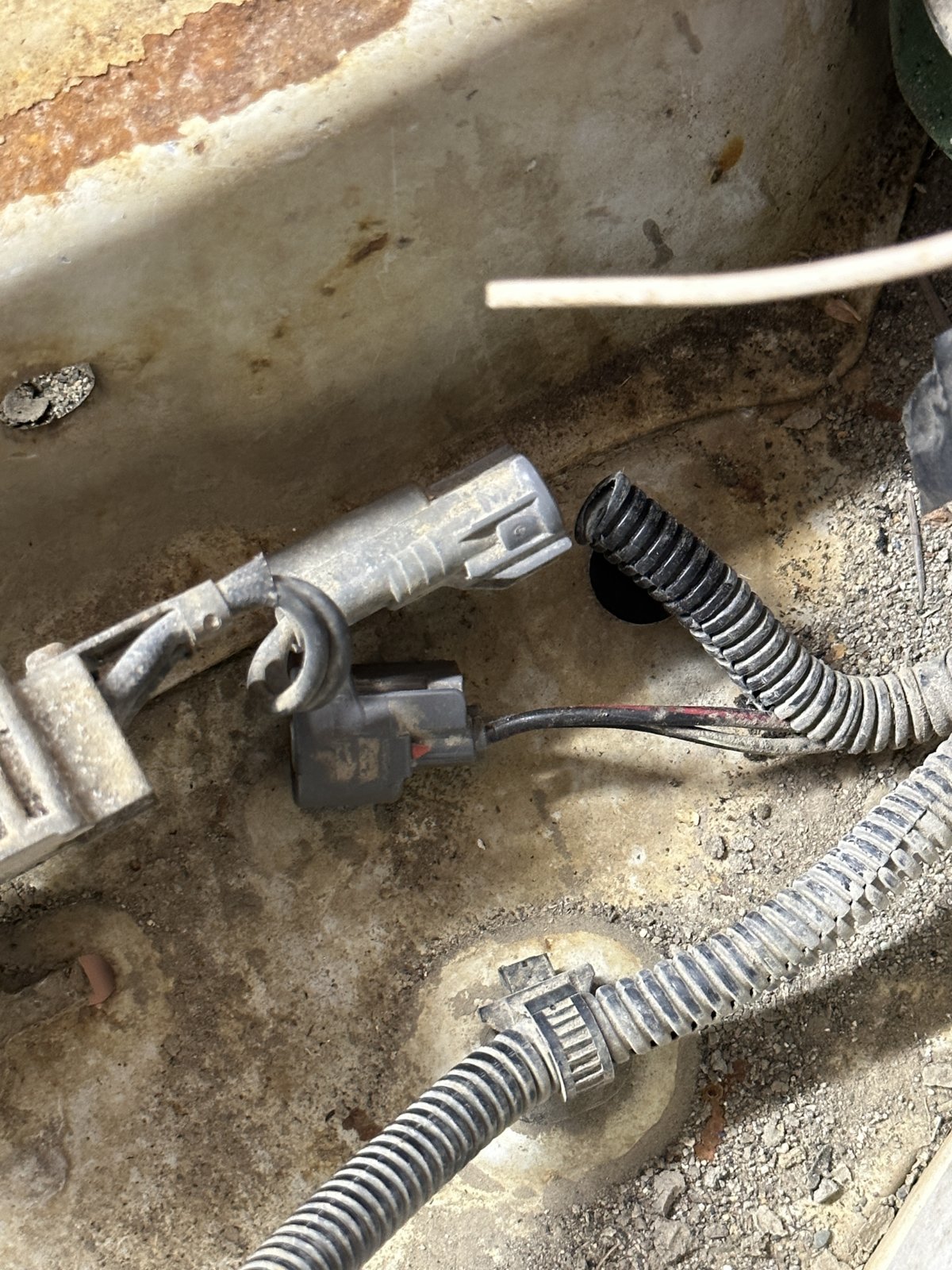

  10. Nov 25, 2023 at 12:45 PM
    #130
    Camazon
    Camazon Well-Known Member
    Apr 28, 2020
    #326185
    214
    Cam
    Vancouver,BC
    06 Tacoma TRD Off Road DCSB
    this is between the drivers headlight and the battery
    Pittsy[OP] likes this.

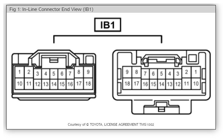

  13. Nov 25, 2023 at 7:46 PM
    #133
    Dm93
    Dm93 Test Don't Guess
    Mar 3, 2015
    #150066
    12,717
    Texas
    2014 DC OR 6spd 4x4
    Predator tube steps, Ranch Hand grill guard, Magnaflow CatBack exhaust, Toyota tool box & bed mat, 2LO Module by @Up2NoGood, Rearview Compass/Temp Mirror, Tune by @JustDSM.
    It's going to be Black/Red but there's no connector in the engine bay that it goes through, the only connector it goes through is IB1 (Pin 8) which is behind the drivers side kick panel.
    Pittsy[QUOTED][OP] likes this.
  14. Nov 25, 2023 at 7:47 PM
    #134
    Pittsy
    Pittsy [OP] Ex car guy, currently in rehab
    Jan 20, 2022
    #387923
    2,277
    Davis
    Cave Creek, AZ
    07 DCSB 4x4, 20 DCSB PRO 6MT
    BTF Fab +4.5 - DMZ SUA - TE Cage - LS6 Swap
    This man right here needs to be salaried by TacomaWorld for the info he’s provided
  15. Nov 25, 2023 at 7:51 PM
    #135
    Dm93
    Mar 3, 2015
    #150066
    12,717
    Texas
    2014 DC OR 6spd 4x4
    You could tap into it in the engine bay but you would need to figure out which Black/Red wire it is as there are several.

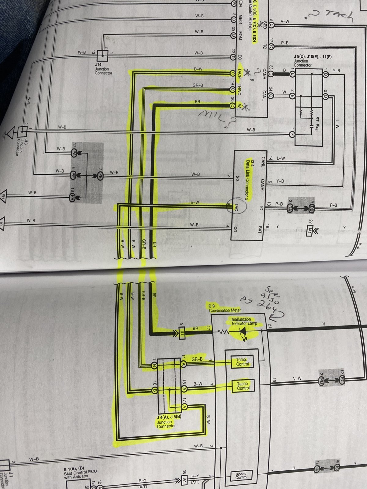

    For the life of me, I am not having any luck with getting my temp and tach to function. I’m using a factory 07tacoma electrical manual and have checked the wires for continuity and that’s good. The manual shows the tach wire to be black w white stripe and temp to be green w black stripe. That is where I tied in, but no good. When running, the temp needle immediately jumps to the center of the high/low marks. Any direction would be greatly appreciated. I understand the a/c is not going to function unless it sees rpm and temp. Please correct me if I am incorrect.
