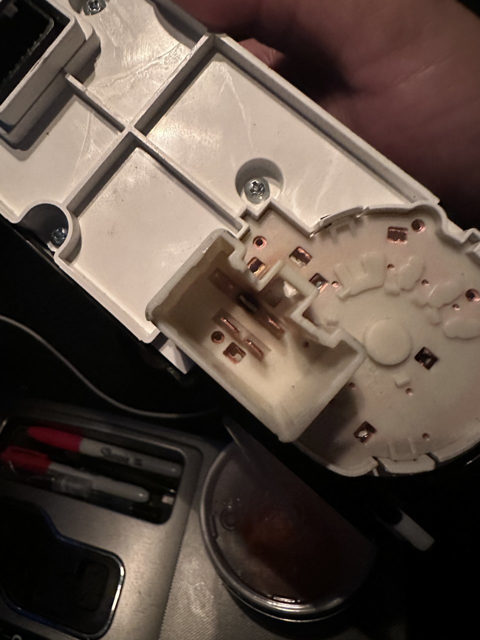

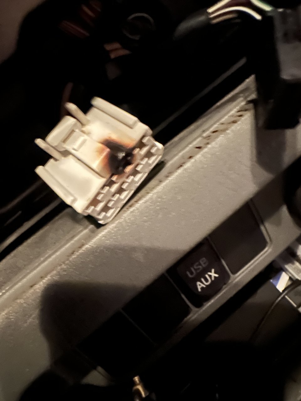

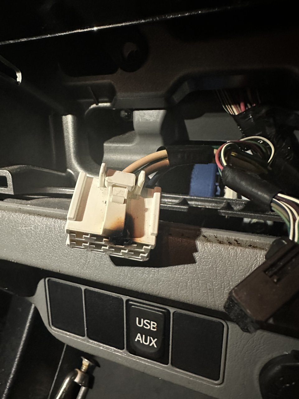

    Anyone know this part number or where to get this part?
    pigtail is shorting maybe from bad contact so need to replace so high setting works . All other blower setting work.
    Already replace climate control unit and problem still continues so need to replace pigtail.
    FYI
    this is not the blower motor resistors connection below the blower on the passenger side.

    This connect to the back climate control

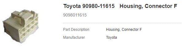

    @caribe makaira Do you know what the part number is for the pins for that connector? I’m having the same problem with the burnt pin on the high setting.

    Thank you so much!
