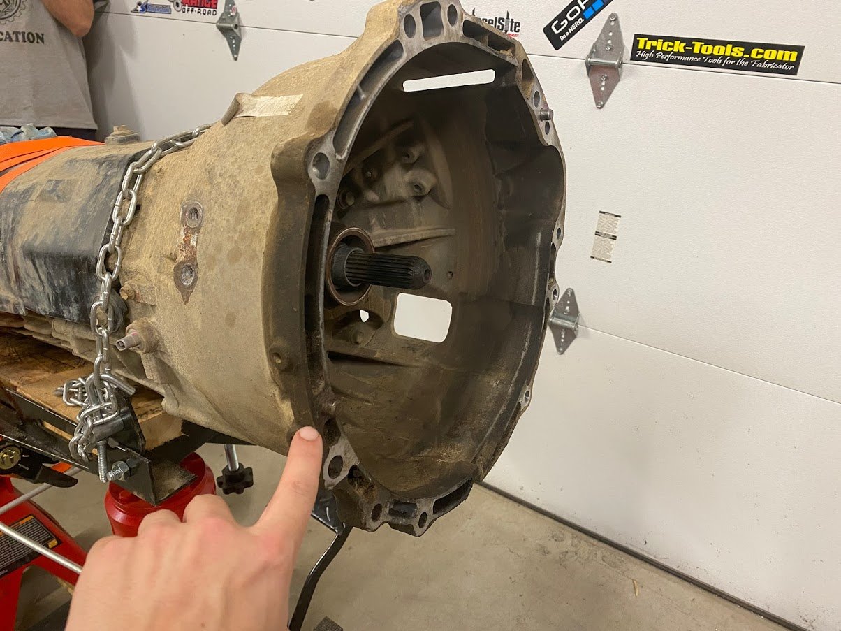

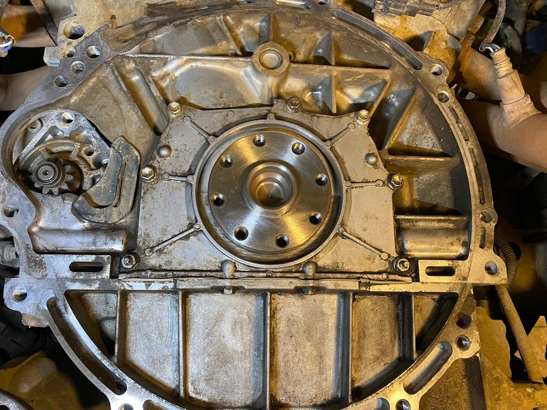

    No, here's picture of the crankshaft the transmission input shaft does not fit into a pilot bearing

    With the above mentioned , is there room to install a pilot bearing or is the input shaft too short to extend into the back of the crankshaft ? also , is there a snub on the input shaft that would except a pilot bearing ? sorry been a while since I did a clutch on the 6 speed manual.
    Somebody show me some side views of the input shaft please

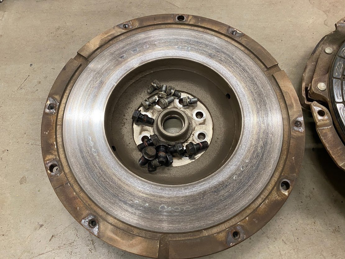

    I agree, having a pilot bearing would likely prevent or lessen the accelerated clutch release bearing wear. This is the best shot I have when I had mine removed a few months ago:
    What? The flywheel doesn't have any splines, it bolts directly to the crankshaft. I believe the input shaft (without measuring depth) would sit just at the face of the inner bore of the flywheel. Here is the OEM flywheel:

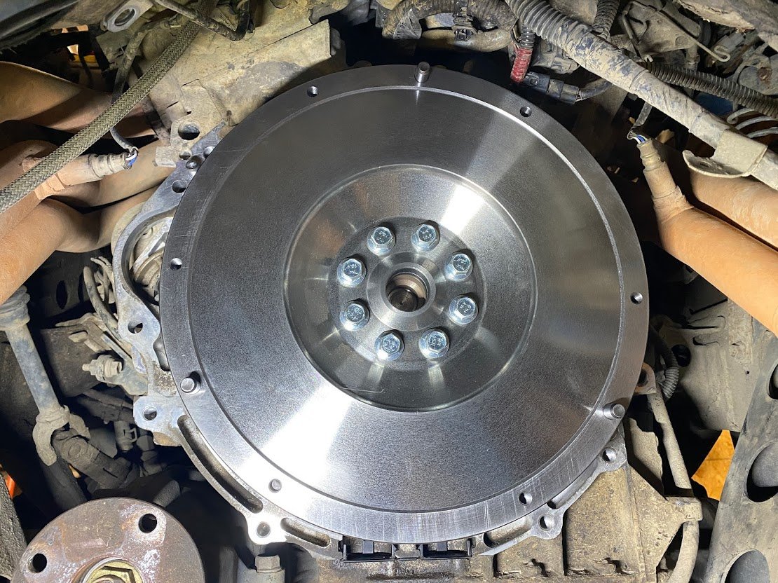

    Here is a URD heavy flywheel, both pretty similar in design where the input shaft area is:

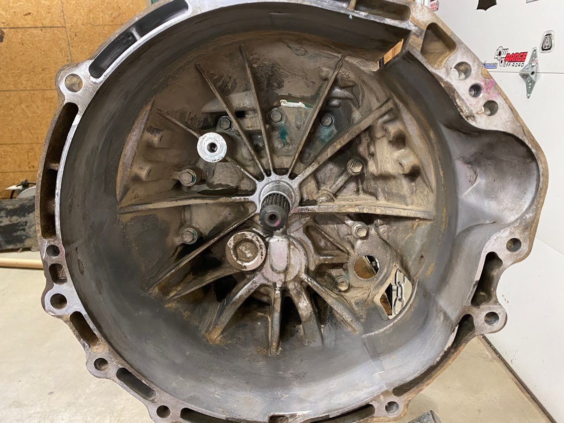

    1,877
    The rear of the input shaft inside the trans is supported by a big bearing. I have a new one around here but it is way too cold to go dig it out and grab a pic, maybe later if I remember, .....Anyway, the excuse aside, I will not argue that this is not the best of designs but that thing caught my attention and has stayed in the back of my mind 5 years after first digging into one of these transmissions.
