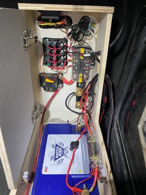

    Ok time for a largish post. I have been plugging away at getting things done I wanted for our large family trip planned for next year. So this post is about my "leisure batter" (I love that the Brits call it that :p) and upcoming projects slated for the next month or so.
    Aux-battery:

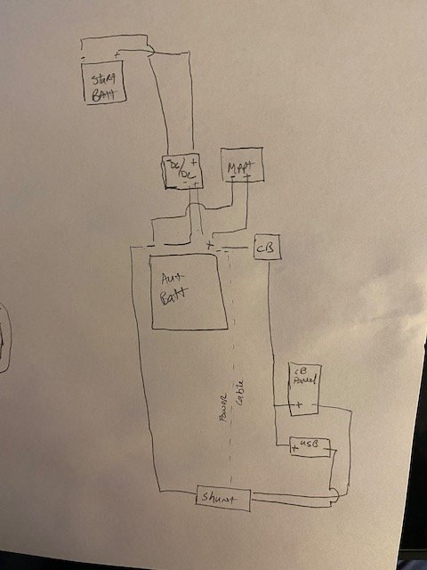

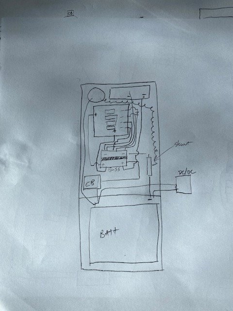

    I had this plan a while back to have a dual battery system in the truck to run all of my accessories. I was pretty much set on getting an Off-Grid Engineering system and having something plug and play. Then after countless hours on TW I started to notice reports of panel cracking where the secondary battery goes. I started having second thoughts. Around this time my good friend Sam with https://yogaslackers.com/teachers/profile/?uid=sam-salwei Yoga Slackers started telling me about the benefits of LiFePo4 batteries. My secondary battery system interest was renewed. After countless hours of talking and emailing, and texting, and messaging I had a plan; I just needed funding. Post 2021 Christmas bonus :spending: I had the funds I needed.
    It started off as a terrible rough sketch...
    I knew I wanted a Dc/Dc (what the Brit's call a B2B) charger, an MPPT controller, and an AC to DC charger. I also wanted to have provisions for switches and circuit breakers, a 12V socket (for my 12V shower pump), USB charger, and a way to monitor all of power usage. Again Sam helped guide me on all of this and I decided to go with Victron Energy components, Blue Sea components and a Battle Born Battery. Being from NV going with Battle Born was important for me.
    Once my components showed up I started sketching a little more with a little more detail.
    66405372117-C827-D16-B-F699-4-E25-84-A4-_dfdcedbe931996eae8bf063ba74320fce3c0ab4c.jpg

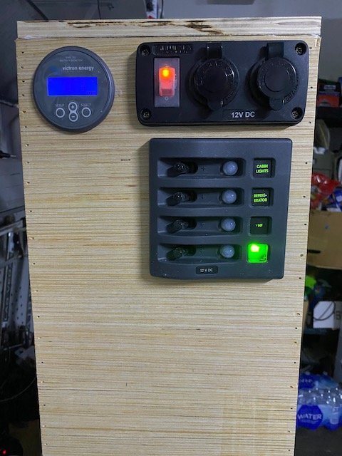

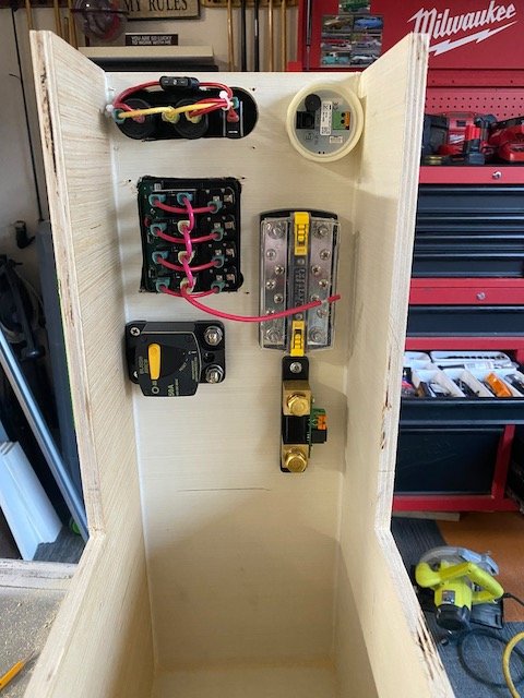

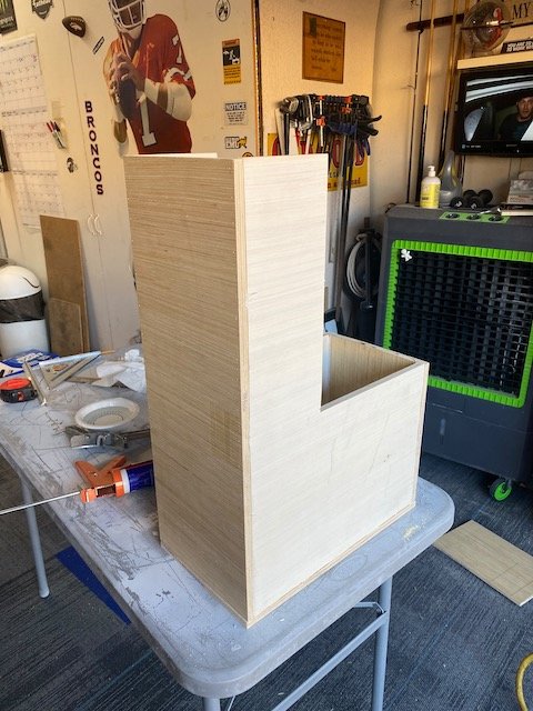

    It was time to make a box. As you have probably seen from my drawers I am no craftsman but I can make what I need. Photo dump time:

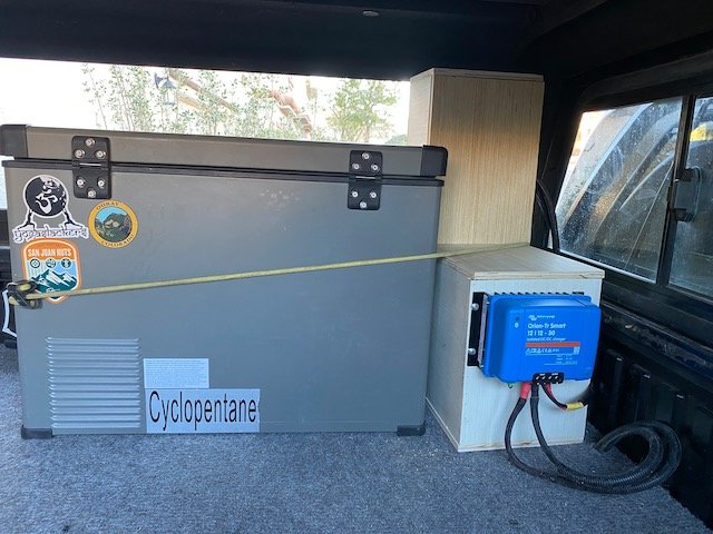

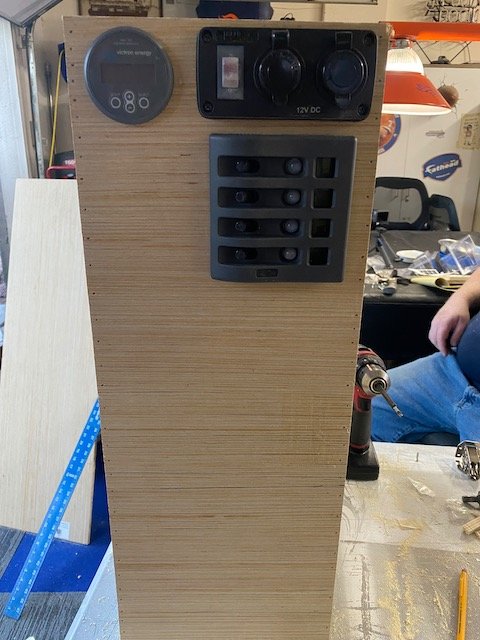

    I went with a Blue Sea Circuit Breaker switch panel so I could reset any faults in the sticks as they might come up. I was able to change switch one to a 5a breaker, my fridge stayed on the stock 15a, and my HF (I scribbled out the V) has a 25a breaker. It is pretty sweet. I bolted it in and wired everything up. All told I think I have 18+ hours in box building and wiring. All of my wires were custom cut and made with flexible welding cable. Here is how it looks next to my fridge
    Rear view with Dc/Dc Charger
    (This photos is before I bolted down the box)
    The only thing I haven't installed yet is my MPPT only because is I haven't decided what solar panel I want. I really wanted a Merlin flexible 100-150W panel but missed my opportunity to get one. Oh well I will keep looking. Once I got the Victron stuff set up my initial calculations (based on winter use) is that I can run my fridge for 15 days before I have to charge the Aux battery. To charge it all up all I have to do is fire up the truck and drive around for a while or plug in the rear to 120V AC power. I imagine in the Desert SW summers I will probably only get half that time but that was my goal, 7 days without moving the truck if I wanted.

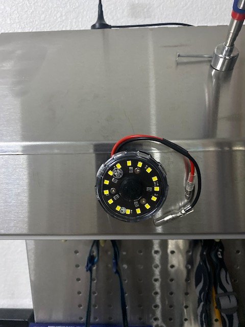

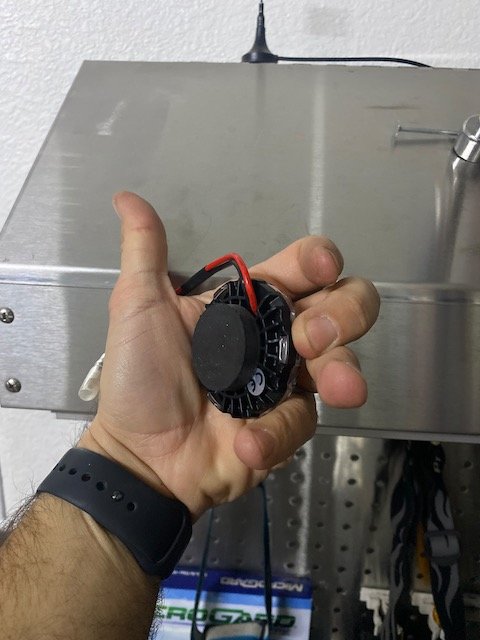

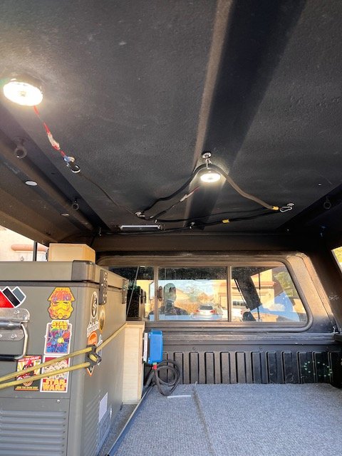

    The next task was to figure out lighting. My buddy recently got the KC Cyclone under-hood lighting kit and I thought they would be perfect for my application. I ordered 2 single lights only and decided I would make my own wiring harness. I wanted the freedom of moving the lights where I need them; on the doors for area lighting as needed. I found a couple of 40lbs rare earth magnets that had some m6 posts on them and viola! Made my own lights. To hold up my DIY harness I used magnets with carabiners on them.
    66434660572-4-BB34187-749-C-453-E-ACFA-F_33771c6f0732d5d86510c2e4876f0445cdc45192.jpg
    66434659260-5-AB55230-93-D2-4-D7-B-9-EAA_e22b91336cf531aa264bba05fa255cba262e848e.jpg
    66501730581-268-E4-B8-A-35-F4-41-EA-9465_bd0fa7b8a72b9cc669ba42b11fed034d5e1586ea.jpg
    Let me tell you, this is one of the most handy things I have come up with in a long time. With it being winter here I have notices numerous times how dark the back of the truck is and finding stuff meant digging out the headlamp and looking for much longer than I cared. Now I flip the switch and if needed move the lights where I need to see. So much better and super bright.
