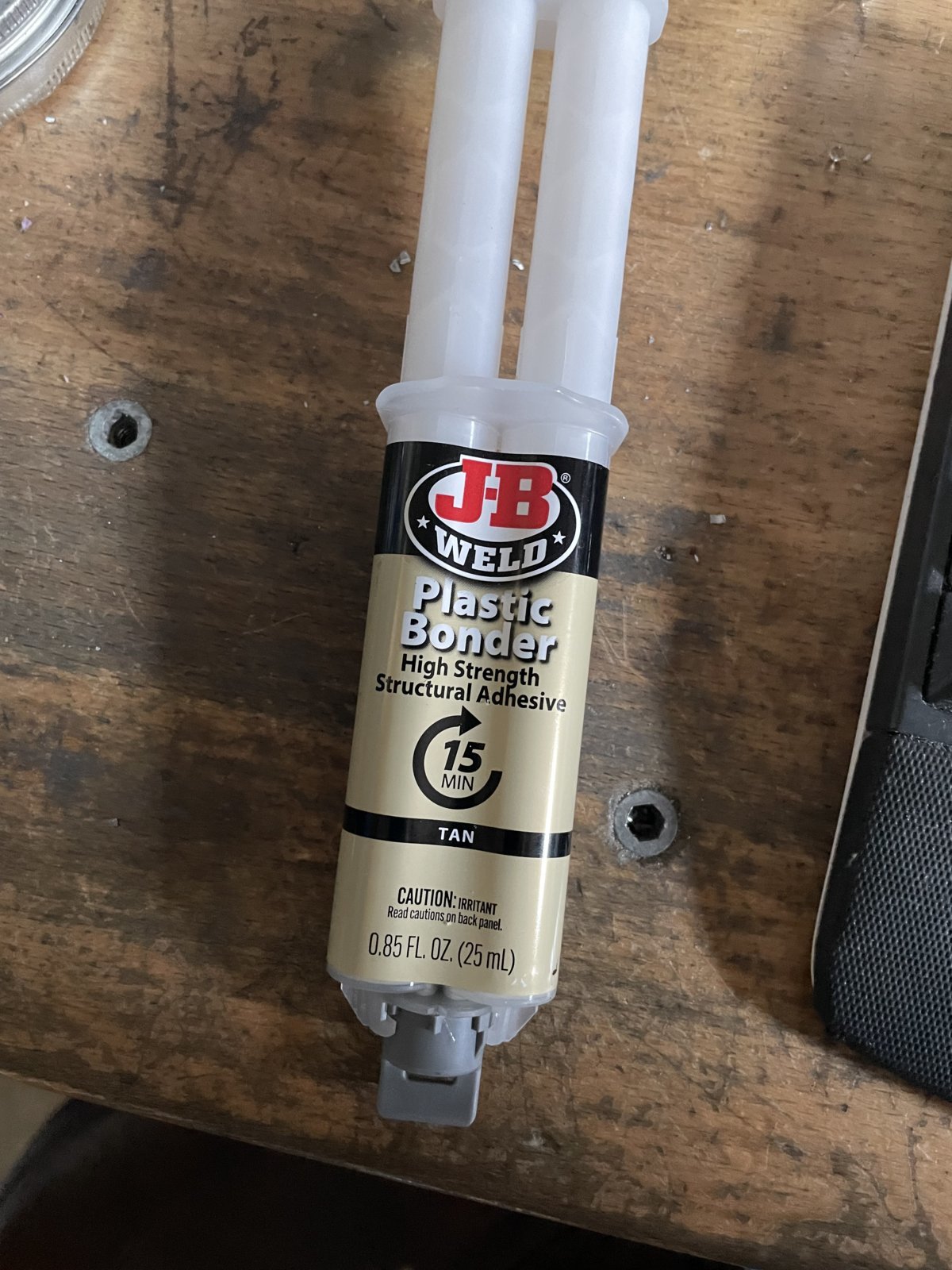

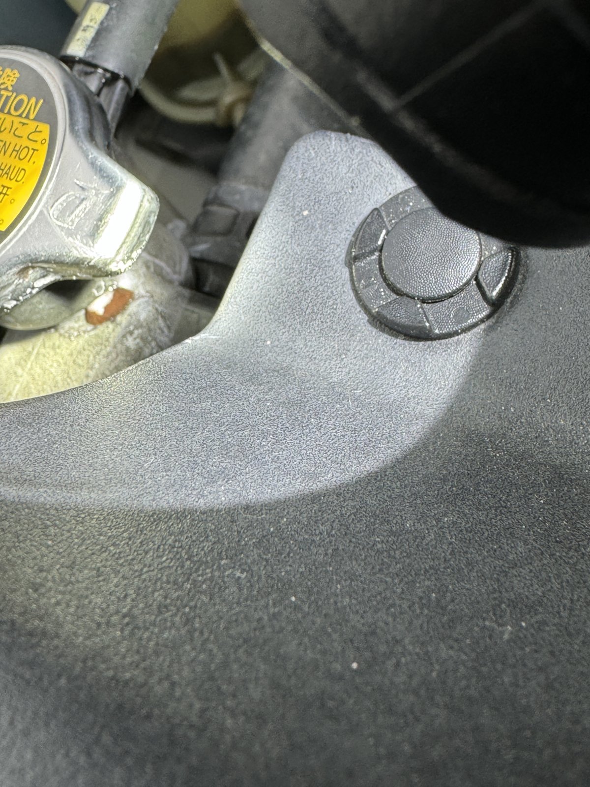

    I have a pin size hole looking for a temporary fix has anyone use jb weld for plastic?

    you can. But a leak could interfere with application. Ideally it would have some coolant vacuumed out, cleaned, and be cold not under pressure when applying it.
    Or take it as a sign to replace the radiator.
