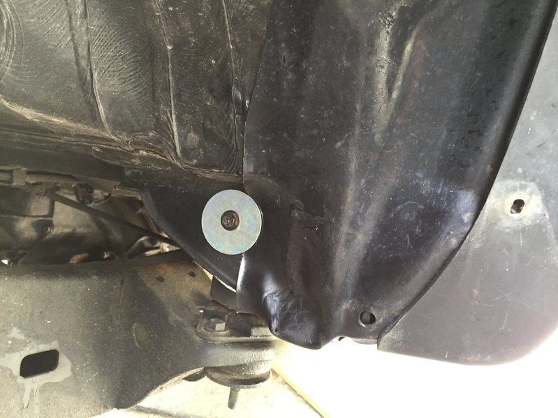

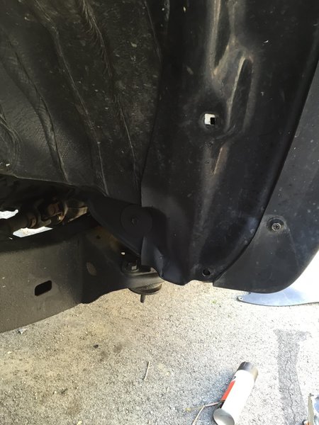

    I did the pinch mod without cutting my plastic wheel well. I used a heat gun heating the plastic while reforming it with the curves and wearing a leather welding glove. kept forming it while it cooled down slowly.

    Sorry I'm a little slow lol....I don't really get this? So how did you beat down the pinch weld without cutting the plastic out the way?

    Take the plastic off by removing the clips and beat the metal down. Then put the plastic back on and and reform it to the new shape with a heat gun

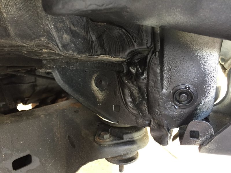

    So that first pic is the pinch weld and metal beet down and then sprayed with some paint or something over it? Also I found this thread a jeep guy did that looks like a good idea. http://www.jeepkj.com/forum/f202/how-pound-pinch-welds-stop-fender-rubbing-34295/

    Well that's a damn good idea but to much work for me:D I'll be honest, I have no clue what that first pic is. I assume so but who knows.

    Yeah that's just the plastic liner moved out of the way. Second pic is the same with it back in place.

    What did you spray on the metal In the first pic?

    Wasn't me boss;) Looks like plasti dip though. But I wouldn't use that. Just a couple quick sprays of black spray paint should do it..

    The first pic is the pinch weld i scuffed all the painted surface then I sprayed it with truck bed coating and let it dry. I then beat it over and sprayed it again.
    I removed the plastic to get to the pinch weld.
    It's well worth the time it takes to do this.
