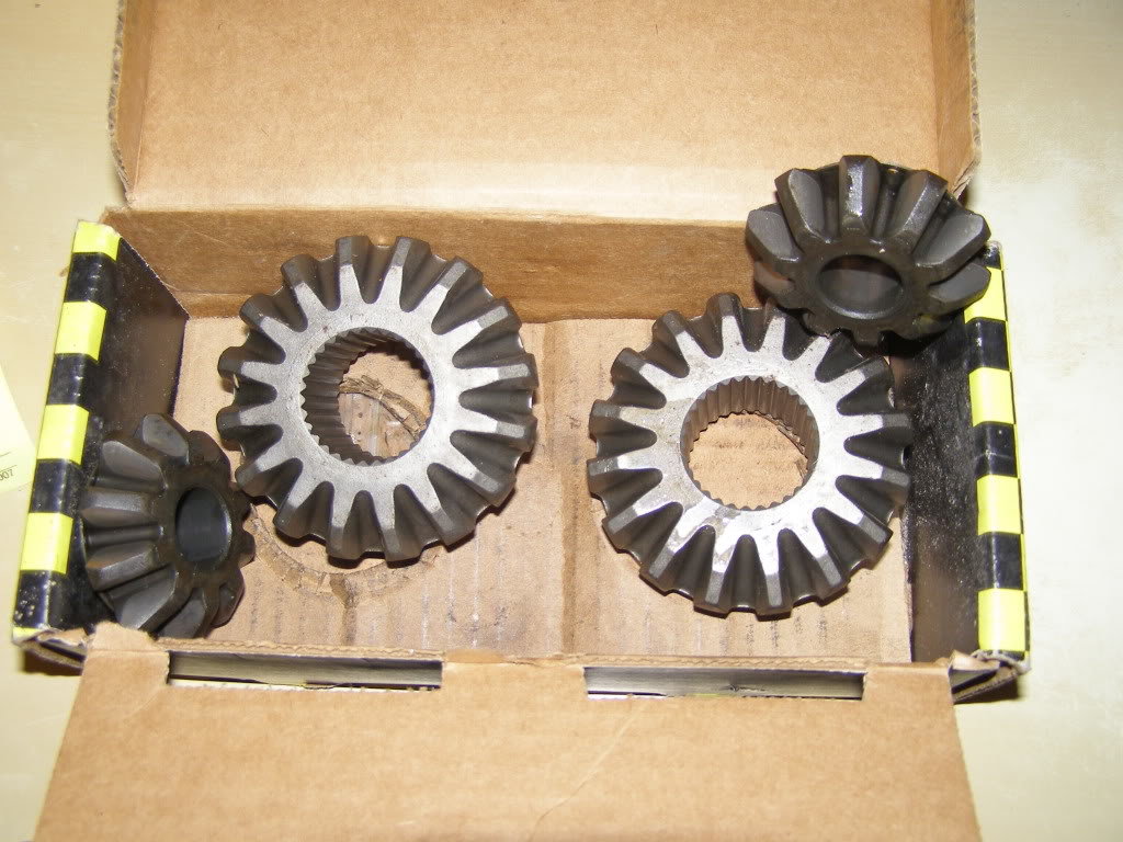

    yeah i've been doin my just in case research this morning (dont tell my work!). i can post pics later, the R&P carrier and gears are out of an 04 tacoma. same 8.4 diff as mine, it has 63K on it. the guy i bought it off of said it needs one spider gear for sure. i can't remember off the top of my head how many gears it has. i'll have to check.

    If it came out from v6 probably 4. I think I have 2 pinion one. Too bad you are not closer I have old 4.10 from my 1gen
    BTW if you are replacing carrier (not the whole diff) you need to setup gears. Which means your cost will be high unless you can do that yourself. With so many 4.10 diffs I would not even bother. Just get whole thrid member and swap it. to swap it its 2-3 hour job with:bananadance:[​IMG] rating. So even if you dont have mad shady tree mechanic skills you should be able to handle.

    danteisme
    Is that what you need to fix that broken third ? (2 pinion spiders)

    yessir!
