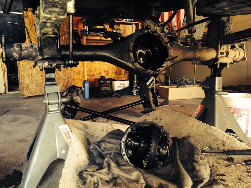

    Resurrecting this thread. My truck is doing this same thing. This morning the howling noise was so bad on or off the gas or coasting that I pulled over. Came to a rough stop. Rough take off too, could hear/feel something not going right in the rear end. Look under and it was leaking out the bottom of the diff and steaming hot! Checked the oil and it was almost gone. filled up with 2 quarts and limped home. While limping home going downhill in neutral I coasted to 50 mph with no more bad screaming rear end or vibrations till I put it back in gear and then the loud noise back when I was on the gas or not. Sound like just a bearing? Does whole 3rd member need replaced if it ran low and heated up? Tearing the 3rd member out now to inspect.

    It's not a bearing noise or it would do it all the time letting off the gas would not help. All rears make some gear noise you are more likely to hear it in a pickup than anything else just by design (no sound deading and the bed to amplify it). When the ring and/or pinion are bad or maladjusted the whine is pronounced under load or coast a faint wine is normal under certain load conditions. It’s up to you weather you lose sleep over it. My 2011 had a faint whine at highway speeds brand new it still does at 47K has not changed a bit. A differential is probably the last thing to fail on a vehicle provided it’s not abused or run out of oil.

    I ripped out my 3rd member and my pinion is shot. You can see sharp metal on the edges where it was shaving away the gears. Also a nice pile of debris in the bottom of the diff, mostly gasket seal and metal shavings.
    Now I'm in the market for a 8" 4.10 e-locker 3rd member.
    Brand new 3rd is $700-$800 or parts to rebuild $400-$500 and I don't have a press to so the work.
    So yeah, go change your oil today and keep an ear out for noises! Little longer and I'd need new shafts and wheel bearings too. Wish I could have caught this sooner :/
