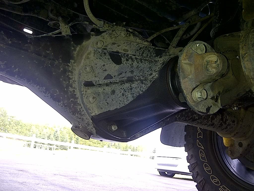

    Hey Guys and Gals,
    So my issue is that I am pretty sure that the pinion seal on my truck went, based upon this picture, and the noise that is coming out of the rear of the truck while driving over 50 km/h (30 mph).
    The truck is a 09 Access cab SR5 and has 119,800 km (74,400 miles) on it and I am still covered under ECP (extended warranty)
    It goes into the shop today to get looked at, but the kicker is that most of the parts wont be in stock so, Im going to order them on my own, so that I can get my truck back before the weekend (vs. waiting till early next week)
    I was able to find this wonderful link and image (see attachment), but I just want to make sure I am ordering the right parts from the dealership so that my truck is back on the road before the weekend.
    Toyota Part Sales Pinion Seal
    I am thinking I need to order:
    17 - Front Pinion Bearing
    18 - Front Pinion Seal
    15 - Rear Pinion Bearing
    I tried searching for more info on this, but couldn't find the parts list. So if anyone has done this before can you let me know, so I can get my truck back asap.
    Thanks,
    Shayne

    AHH I see. It's a good idea in theory however, you have no idea what you need for parts. You said you have a noise. so you going to order 7 or 800 dollars in parts just to be sure? The restocking fee would kill you if they would even take the parts back. It's possible they could order you a complete pumpkin and just swap it out saving a whole day of labor if the noise and leak are in that section.

    The parts are max $200, the seal I think is $27 and the front bearing is $159.
    Who knows what parts are needed, but if its just the seal and I can get my truck back in a day vs. 3, the small cost that I may incur would be worth it for me.
