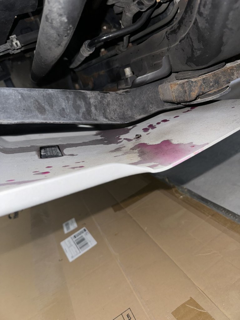

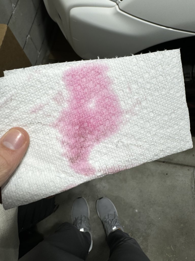

    After work today, I noticed my 2015 Tacoma was leaking a small amount of pink fluid under the passenger side of the engine. I’m having trouble locating where the leak is coming from but I’m thinking it’s either coolant or transmission fluid based on the color. It doesn’t seem to be leaking very bad, but I obviously want to get it taken care of ASAP. Anyone else ever have this issue?

    Looks like coolant check your radiator peacock, and radiator plastic end tanks for leaks

    I'd remove the front skid plate and inspect the water pump seal from the bottom, it's difficult to see with everything buttoned up, looking from the bottom is best. A tacoma water pump will typically seep a small amount through the weep hole but it dries almost as soon as it weeps out so it just builds up some pink crud around the hole. When it gets bad enough to drip it's ready for a new water pump. Might not be your issue but if it is the wp leaking it needs a new one.

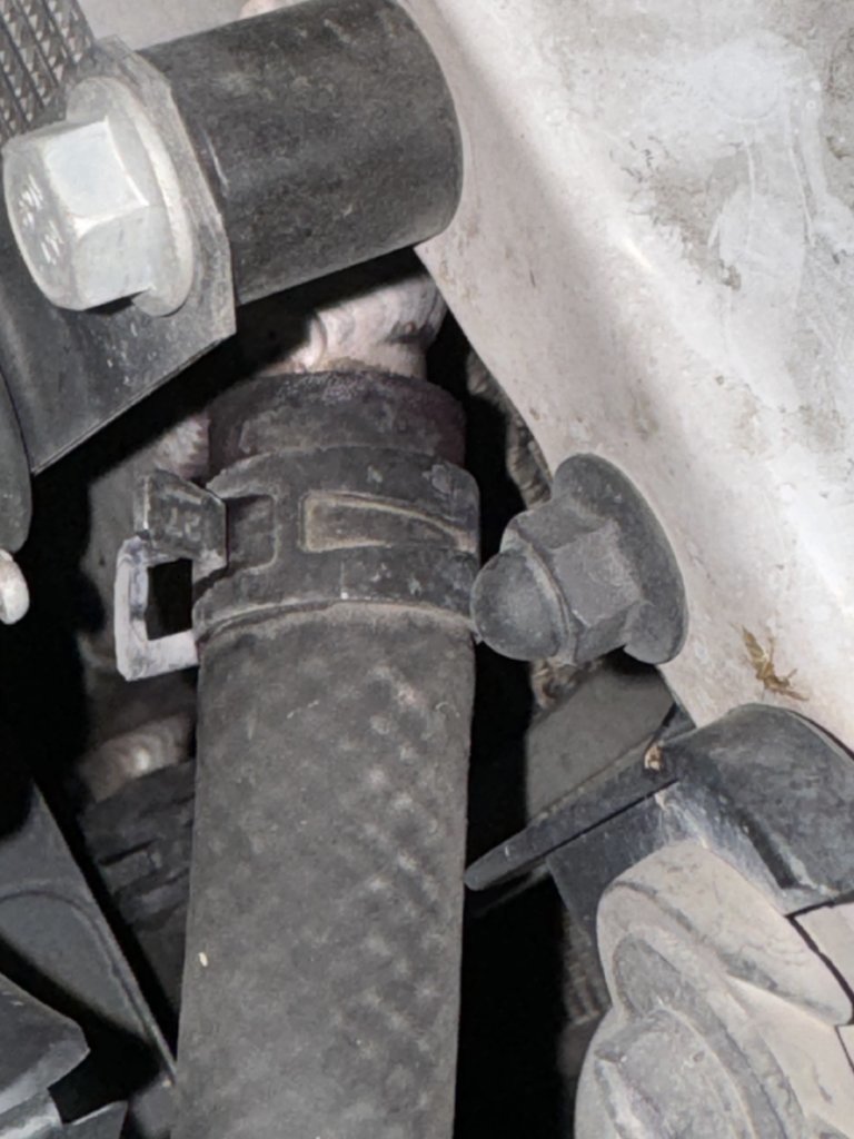

    I looks like it’s leaking from this spot on the driver side of the radiator

    That hose is on the top corner and there’s another hose on the bottom corner below that’s either also leaking or is just getting hit from the leak above. The water pump seems to be okay, no pink crud. If that’s the case, is this something I can fix myself?

    Maybe.
    Looks like there's enough recent fluid there (damp enough) that you can rub a bit on your fingers and smell it. Looks more likely to be coolant than transmission fluid. Coolant will be more "watery" and trans fluid a lot more "oily" to the touch. Coolant in good condition (as that appears to be, i.e. not rusty/brown) will tend to smell slightly sweet-ish, transmission fluid (which is hydraulic oil) won't.
    You def. need basic mechanical skills and basic automotive know-how. E.g. don't open the radiator when it's warm or hot, disconnect the negative battery cable before doing anything extensive inside the engine bay. Know how to "burp" the coolant system after refilling whatever amount you may temporarily drain and/or that has already been permanently lost from leaks, so that you don't have an air bubble stuck in the cooling system.
    Hard to say from just the one photo but it looks like it might be the large radiator hose leaking a bit near the clamp. Maybe the hose is gradually falling apart under clamp pressure there. Possibly just a new radiator hose might be all that's needed.
    If it was mine I might try cleaning the area well with soapy & then plain water rinse, let it all dry completely, then maybe dust the suspected leak area lightly with cornstarch or talc, (keeping the powder away from moving parts like the serpentine belt, pulleys, etc.) Start the engine, let it run a bit & see if you can pinpoint the leaking area directly. Either as a trickle, or maybe just a slight dampening of the dusted area.
    If the leak is around/under the large radiator hose, then proceed to draining out enough coolant to be able to remove the hose without spilling coolant everywhere. Then clean & carefully inspect the radiator port for cracks or pinholes. If it looks fine, inspect the inside edges of the radiator hose. If it shows any signs of wear/breakdown, replace it.

    Sorry for the delayed reply - had to leave town for the weekend the next morning. Why I was scrambling a little bit. But yes, mine is a 4.0L with the supercharger. Took it into a mechanic who initially thought it was the radiator seal going bad so he threw some pressure through system and it didn’t create any more leakage anywhere. Since he didnt produce any leaking whatsoever with the added pressure he added new clamps to the hoses where I originally showed those leaks and then cleaned where all the coolant had leaked/stained. That was done this morning and I’ve driven the truck multiple times with no leaks thus so hopefully it was just the old loose hose clamps. Fingers crossed and thanks for all the help!
