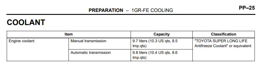

  12. Jun 13, 2020 at 8:43 AM
    fixnfly
    fixnfly Well-Known Member
    Oct 1, 2011
    #64450
    751
    S.W.PA
    05 Access cab 4.0 4WD
    mvparadise[OP] and TacoFergie like this.
