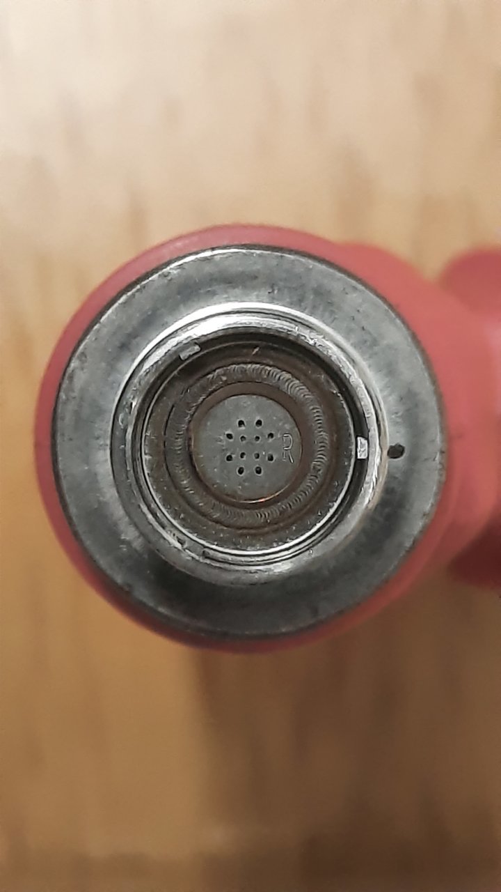

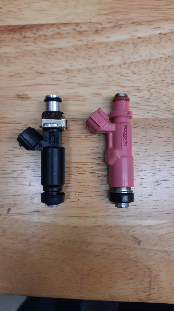

    Here is a pic of the injector I removed. It looks identical to the one I bought from an online Toyota dealership.
    12 hole nozzle. Holes don't look as "perfect" as the originals

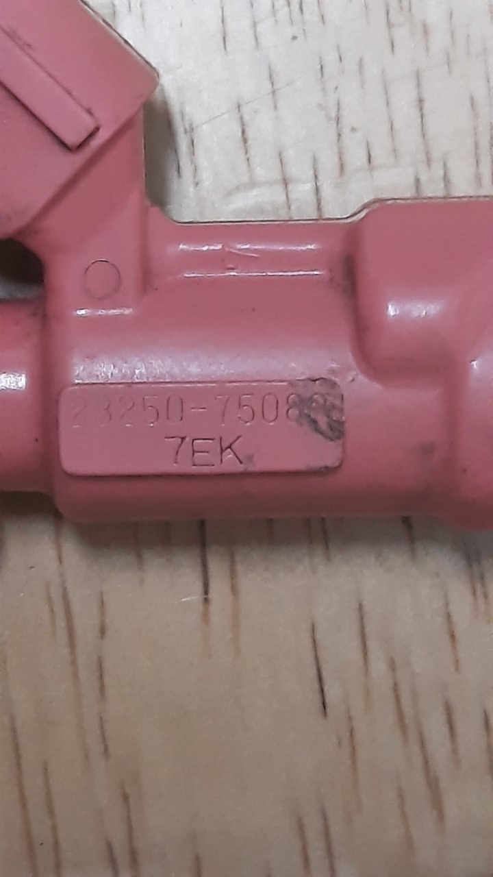

    Filter and product/inspection numbers20201006_063328.jpg 20201006_063411.jpg

    Called MotorWest and spoke with Martin. He had 4 flow matched injectors for $150 + shipping. I put em in, disconnected the battery for 20 minutes or so then went for a 7 mile drive plus freeway.
    No check engine, no codes pending. It idles smooth and feels responsive.
    I'm glad there is an alternative to the outrageously priced oem's and the chinese garbage!

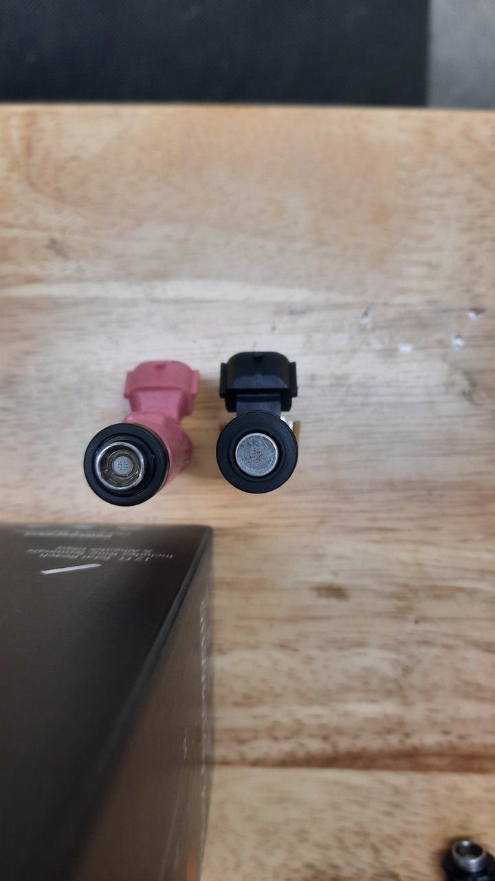

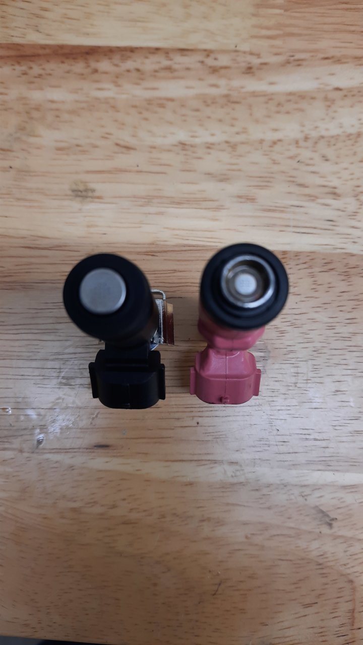

    A few pics for you guys.
    Toyota injectors:
    New on top, original on bottom. The 12 holes look different to me but probably don't make any difference.

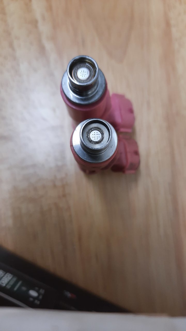

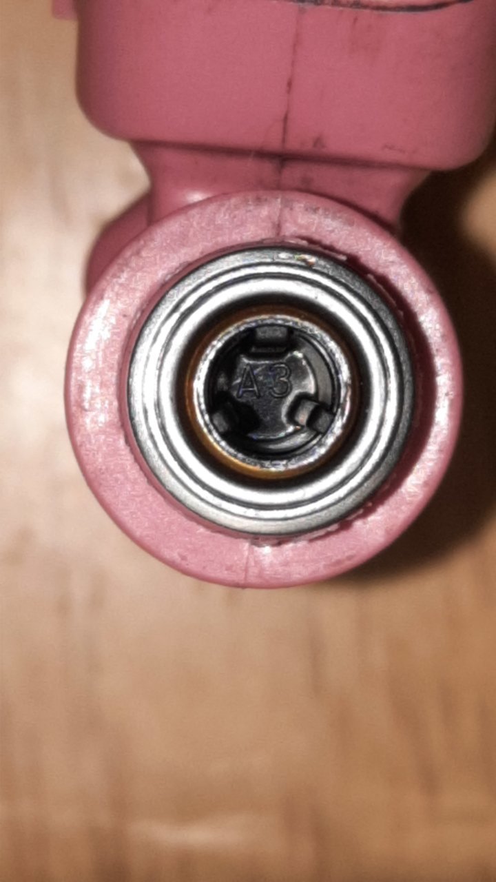

    MotorWest injector 20201013_192224.jpg 20201013_192155.jpg 20201013_192257.jpg
