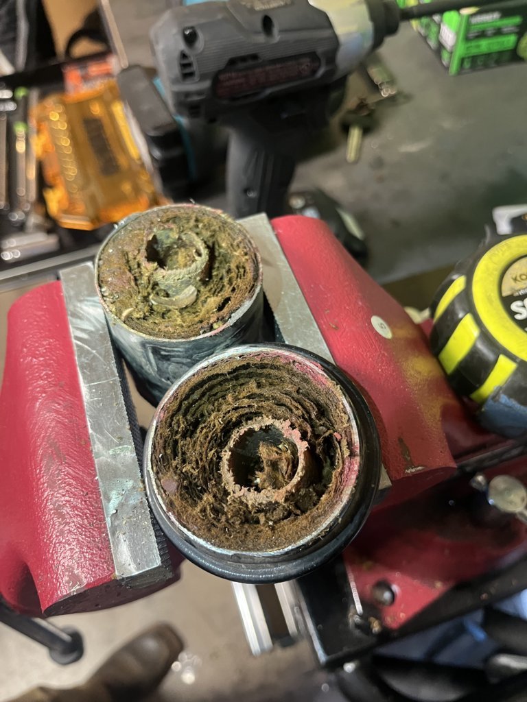

    Edit: here's a pic of my old fuel filter as of 20k miles ago I replaced - safe to say new injectors wouldn’t be a bad idea....
    She was a Reno truck her entire life until a few years ago when I took her home.

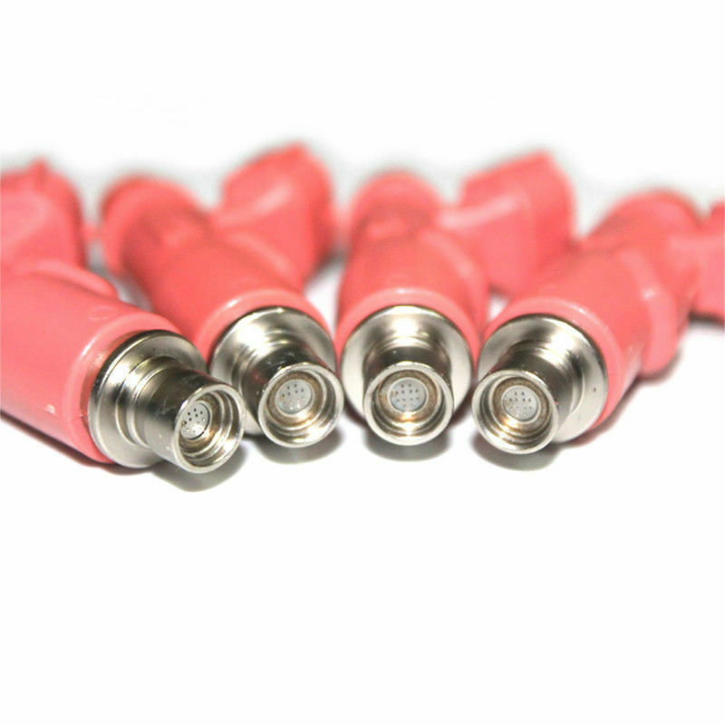

    The browns have 2 spray holes.......pinks have about dozen tiny little holes
    so when you get in high miles the pinks will start to clog a lot earlier
    so all 01'-04' better be running top tier gas and run injector cleaner every so often
