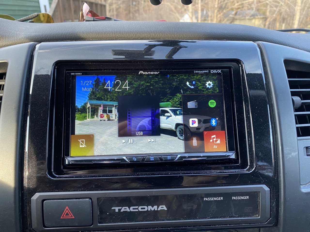

    I recently upgraded My 2006 Toyota Tacoma head unit, to a Pioneer 4500 NEX, and it Feels like a whole new Truck! The Pioneer Stereo has Apple Car Play, Bluetooth, Spotify, Maps, Audio Books, and Screen Mirroring so I can watch the Game during those long drives home from Mammoth! I highly recommend upgrading. My old set up was a very basic Alpine CD player, with Parrot Talk. ( Which is considered Primitive by todays standards )
    If you're in the market for a new Head unit, I highly recommend the Pioneer 4500NEX. I was originally trying to get the Alpine 107, but that model has been discontinued. So after reading reviews on here, the next best choice, was the Pioneer 4500!

    I went with an OEM Entune-GPS unit when I upgraded my 2015 (originally no GPS) mainly so I could have the original steering wheel controls and BT telephone functions work easily. I've been happy with that upgrade. It looks exactly like one would expect -- no surprises there.
    I went with a Pioneer AVIC 5100NEX GPS head unit on my Gen 1 truck, and I'm (mostly) happy with that, too. The unit works perfectly, it's nice to have XM, although the original mounting position does lead to more glare on the screen than one might like. The Pioneer units with their ability to enter "test mode" is a useful mod for those interested in that kind of thing. I like their GPS head units.

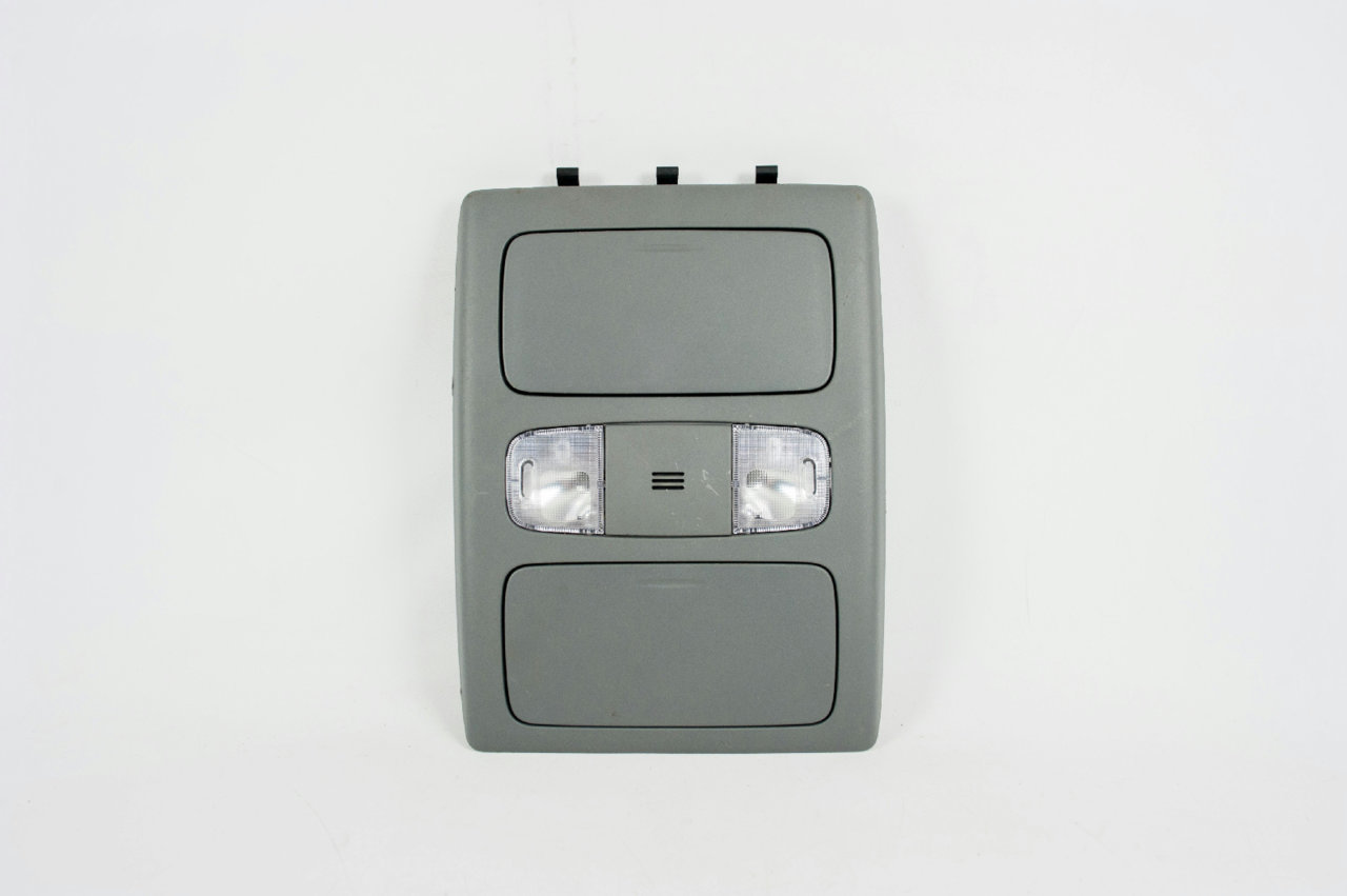

    I picked up a roof console w the oem mic and gutted it. Ran the aftermarket mic to the oem location. Works perfectly and most importantly, looks oem.

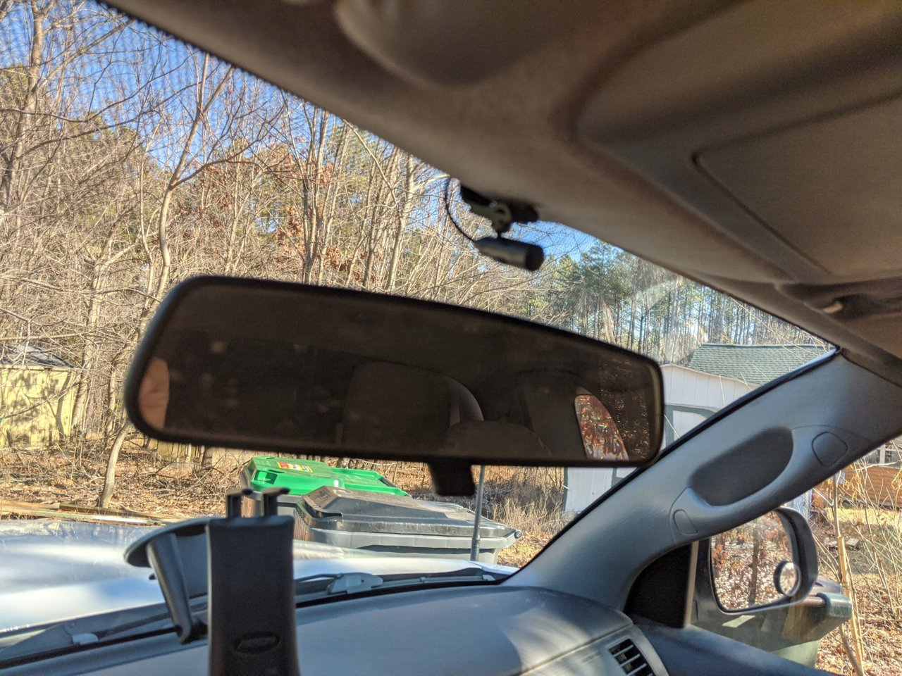

    I just upgraded from my basic Entune unit to a Pioneer DMH1500NEX. Wired Car Play and Android Auto, but I always have my phone plugged in anyway. I also had a Maestro RR installed. This retains steering wheel controls and gives me onscreen vehicle info. The mic was placed above the mirror.

    I have the 4400. Similar to yours. Wireless CarPlay etc. If you haven't done it already, do the Maestro module as well. It plugs in to the OBD port to interface your new head unit with the can/bus. You can see tire pressures and many PID's right on screen. Read and clear codes, etc...

    I was Able to run my old Microphone from the Parrot talk, up behind the review mirror. Calls come in even clearer than they did with my old Parrot talk setup!

    My shit is all stock.
    Pics of roof console ?

    So that’s where they hide it. My console just has a blank spot where that louver is on yours. I’ll have to hunt one of those down. Currently my mic is just wedged in there between the console and the headliner.

    I picked mine off ebay. You could get creative and custom cut yours. Sadly Toyota doesn’t sell that part alone either. I think i paid around $68 for it on ebay a few years ago.
