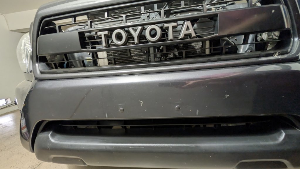

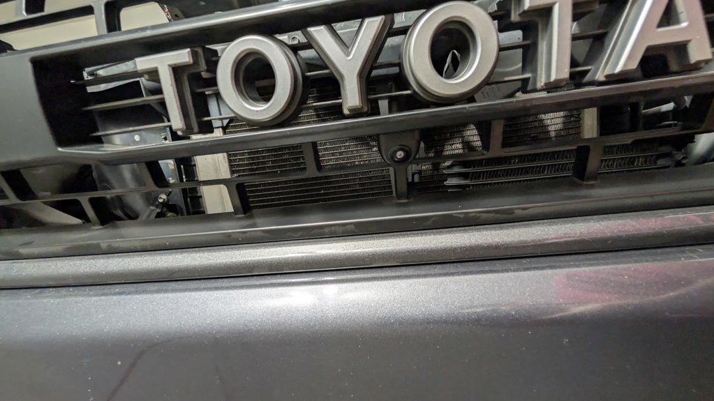

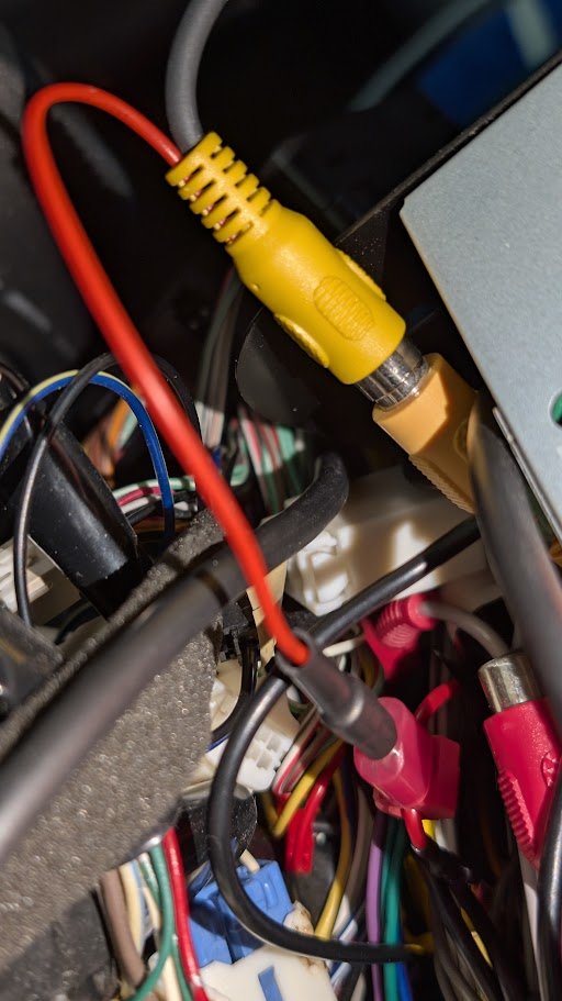

    I'm actually in the middle of installing the same camera for use as a front cam. I connected the trigger wire near the video RCA to my radio’s red ACC 12V wire, so the camera turns on with the radio and off when the radio is off. I’m using a Pioneer DMH-W4660NEX.
    I mapped a steering wheel button to activate the front cam using Weblink and the Maestro RR, but it doesn’t seem to work. Also, I’d love to see a picture of where you mounted your front camera.
