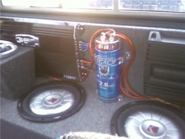

    Yea that will work. But id just run a mono block amp instead of a bridged 4 channel amp.. be much better. It would be hard to wire the sub channel off the head unit like that. What subs did you pick?? thats kinda low power for any sub..
    Id go with these personally. Had the 10'' versions in my old 86. Sounded fantastic.
    Only pic i have of the setup as it was stolen a week and half later...burned down the truck and shop too..
    6768_1025757264638_1846480219_56056_8044_7ff53c556adfad1e549a1c631c462d0b87801d3f.jpg
    Heres the subs
    http://www.sonicelectronix.com/item_21926_Kicker-CVT84-10CVT84.html
    then id pair it with this amp wired at 2ohms(so in parallel)
    Plenty of head room, and good clean subs.

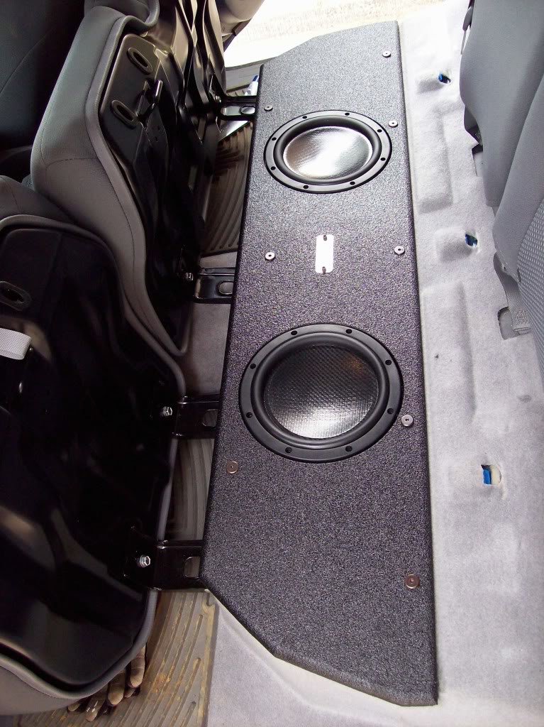

    Bro, Where did you get this box? That is awesome!!!

    I made it custom myself. It's really just a top plate to cover the bin area and seal it up after you've sealed the holes in the steel.

    It's a great box, and eD subs were known for good performance, but elemental designs is no more. They closed up shop a few months ago, so ebay may be your best bet, if that's the sub you choose.
