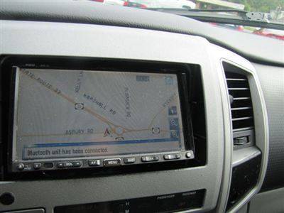

    I have a 6 speed and just installed the 4400 a few weeks back. I put in the parking brake bypass, makes life a lot easier and literally takes 8.4 seconds to install, rather than dealing with the parking brake. This is a photo of my old deck (Avic Z1), but it shows where my microphone is (just above the hazard button). Very clean and works great.

    Cool! Thanks for the info. I hadn't thought about putting the microphone there, and it looks good.

    Not bashing your install because it is clean, but just a technical note for those who are considering this..
    The mic has slits on the side which are the noise canceling portion if the mic. By doing the install like this, you cover up all the noise canceling ports, and your audio quality on the other persons end will be horrible at times when your cabin is loud (like when your driving, especially on the freeway). Just a heads up for those considering this, that flush mounting any type of mic like that highly discouraged.

    No worries. It was like that when I bought the truck and to be honest I never use it so I was unaware of that issue and i appreciate the heads up on it! With that in mind maybe i will adjust it to stick out a little to expose the noise cancelling or just relocate it all together.
    thanks!
