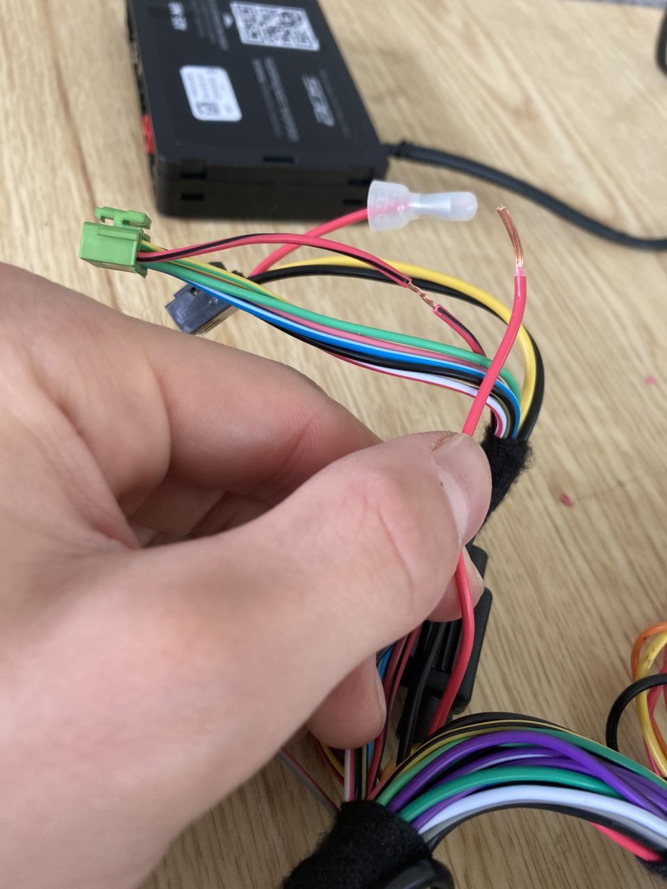

    I just finished a long road trip and had this unit reboot around 10 times over 24 hours of use. Anyone else having rebooting issues? I was using wireless CarPlay with Waze and iTunes or Pandora. It always started right up and synced with the phone so it was a huge pain but wanted to see if I’m not alone before I start making phone calls.

    After a lot of testing, I tracked it down to a bad Maestro box. I'm not sure what it was doing, but removing the data cable stopped the rebooting. I replaced the Maestro and have not had issues with the new box.
  12. Apr 13, 2020 at 11:41 AM
    #72
    TA-5650
    TA-5650 Well-Known Member
    Nov 22, 2019
    #311394
    252
    Wilmington, DE
    2017 TRD OR DCSB, Blazing Blue Pearl
    @BZ4X4 Thanks for the info. That's what I'm suspecting as well. I was on firmware 2.07 on the Maestro and they advised I reflash it to 2.09. So far so good. But I also haven't driven much because of quarantine. If I still experience it, they said I should try making a jumper from the red wire (accessory) on the Pioneer harness to the red/black stripe wire on the green plug of the maestro. He said that would eliminate the possibly of the Maestro shutting it down. We'll see if the reflash fixed it or not.

    Funny, you reminded me they also had me make that wiring change when I installed the replacement. So who knows what the problem really was but it works great now.

    TA-5650
    Nov 22, 2019
    #311394
    252
    Wilmington, DE
    Thanks for reminding me, ended up bypassing the maestro for direct power to the head unit so I’ll test this weekend to see if I’m still having rebooting issues. 207D5C13-E1D5-4C42-ABDF-FF3F6F2DE576.jpg
