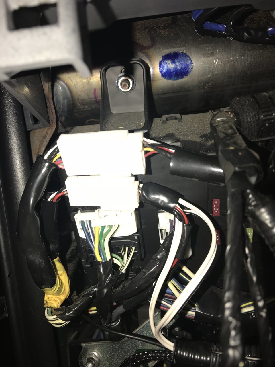

    So here is where I hooked into the rear video (left of driver's side under the fuse box, second connector down):IMG_3454.jpg

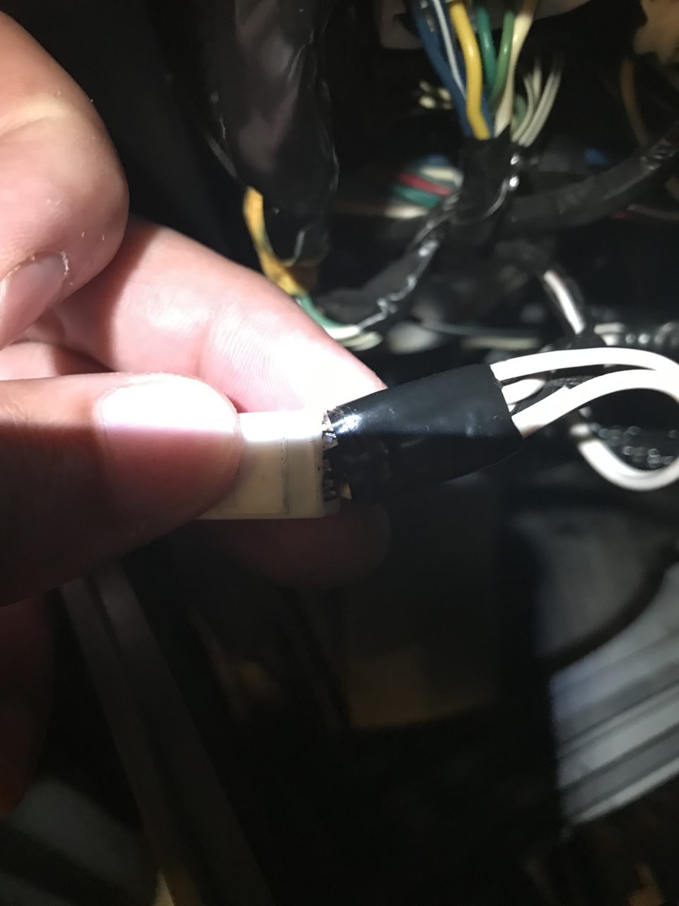

    I first connected by sodering the ends and then shoving them into the connector. Not exactly secure. I ended up just using cheap splicers.

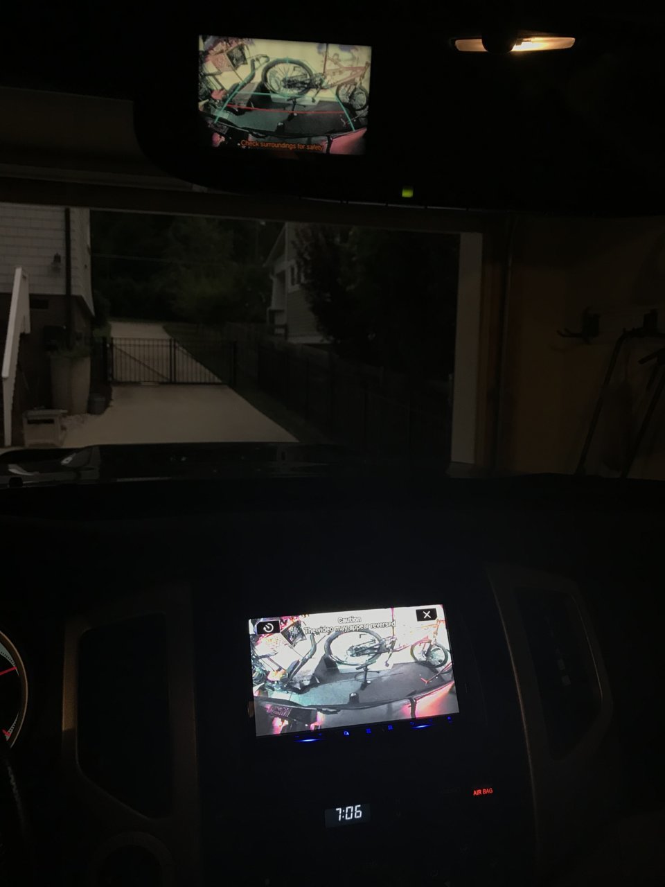

    The end result is a mirror image of the rearview mirror.
