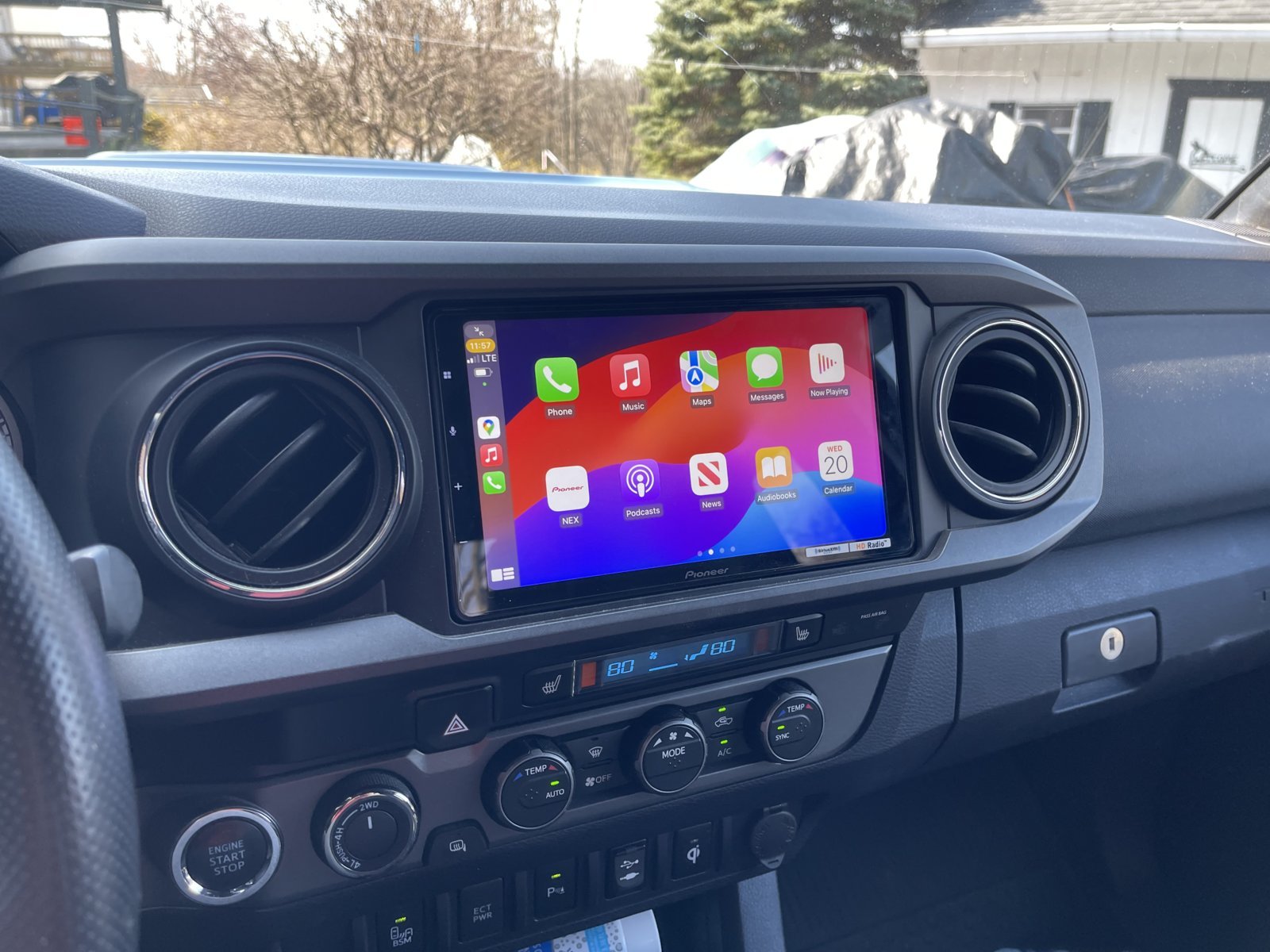

    Replaced my AVH-W4500NEX with the DMH-WC6600NEX. Wiring was identical on the speaker and power harness, only had to swap the RCA/camera harness (rarely the case, please make sure you know what you are doing before re-using a harness from another radio).
    I re-used the metra kit I installed on the previous radio, removed the faceplate and cut the faceplate tabs off, only leaving the side mounts. Came out almost flush, very easy to adjust. Waiting on my OEM brackets to come in to see if those line up any better.
    Wow, what a difference this larger screen is! $900 refurbished, worth every penny!

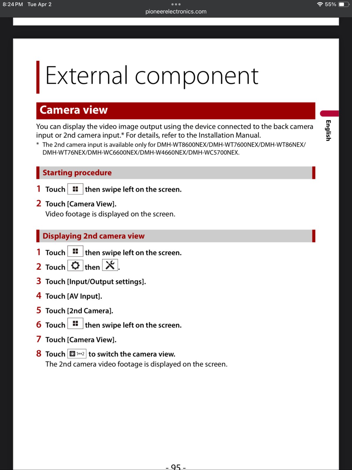

    I’m having the same problem. I’m adding a Nakita camera for the front, and can’t seem to access it from the head unit. I know it’s working, if I swap it to the rear camera input, I get image.
    Is there some setting I’m missing? I’ve been through the menus, and can’t find anything.

    I found the answer for my problem. If you read the fine manual, deep in at page 95, you find these instructions. The key is changing the AV input. Mine was set to the Maestro. Once I did that, the 2nd camera option was available.

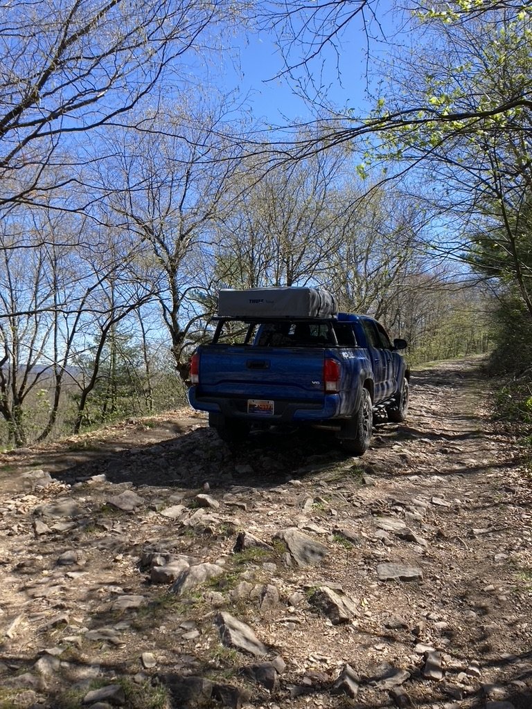

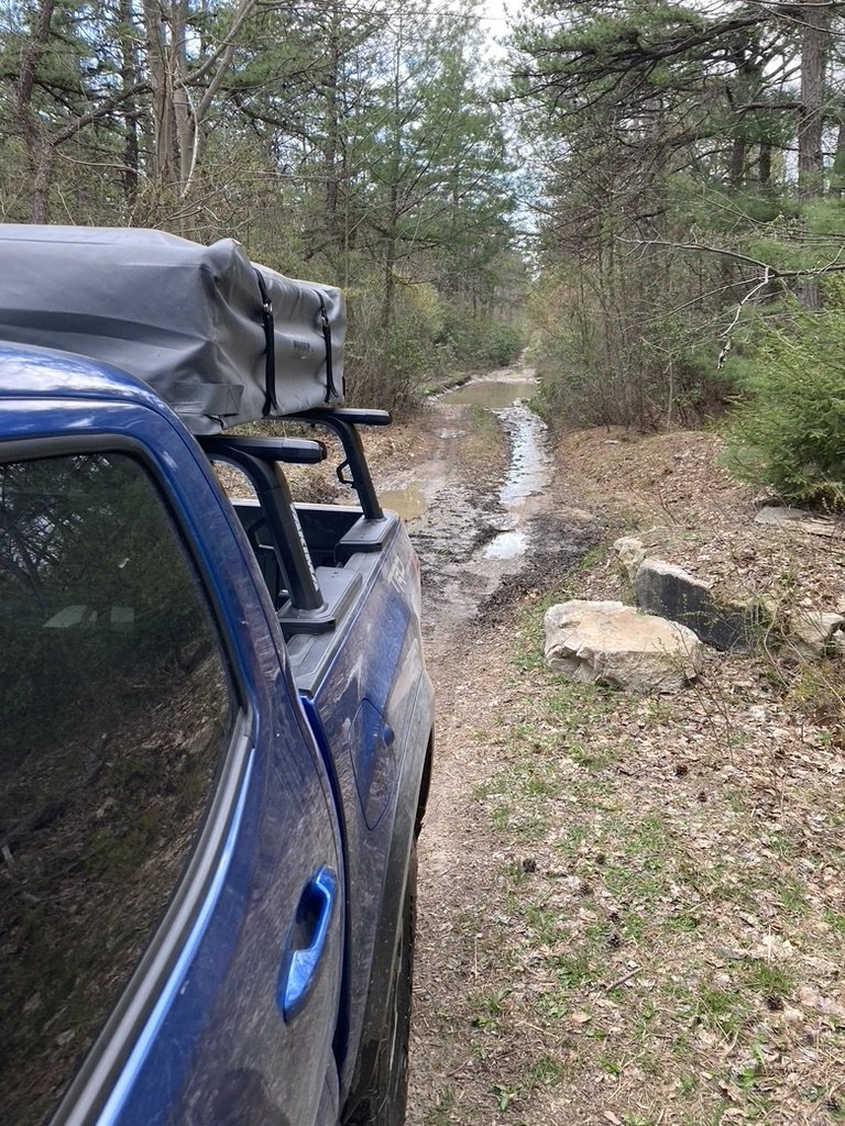

    I do some light off-roading (not rock crawling). The install is rock solid, no rattling whatsoever. I experienced rattling with a different pioneer HU, but as long as you modify the installation bracket for the install, you should be good!
