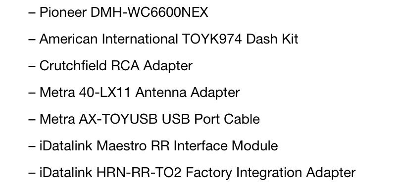

    Im about to do this install is this an accurate parts list? i dont want to jus order it from Amazon and hope it has all the adapters. I dont care much about sirius xm or the OEM gps antenna if it doesnt affect anything else. Im also in a 2019 sport with only a rear camera and dont care about a front camera. I definitely want the maestro engine vitals though. Also theres no advantage with the 7600 over the 6600 right?

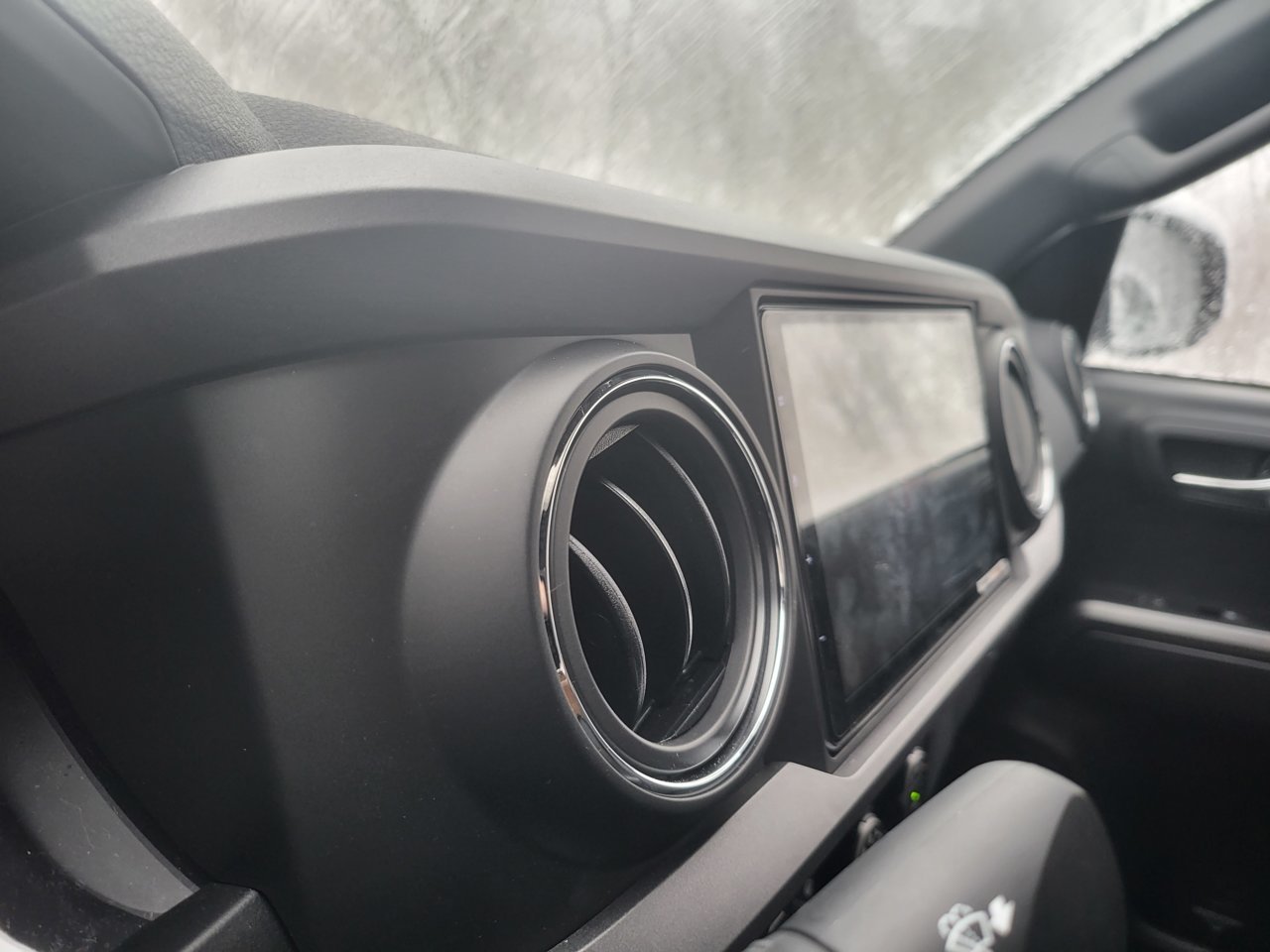

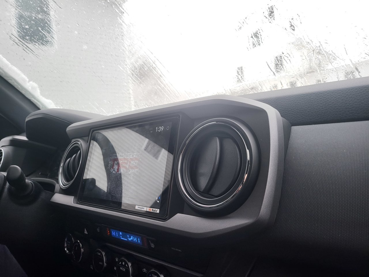

    trying to read through the whole thread, did you have to modify the bezel at all to get this flush? I'm looking at this head unit for my 3rd gen.

    nope, you just have to drill holes in the factory bracket.
