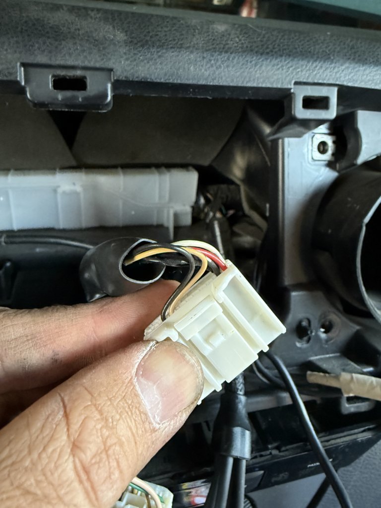

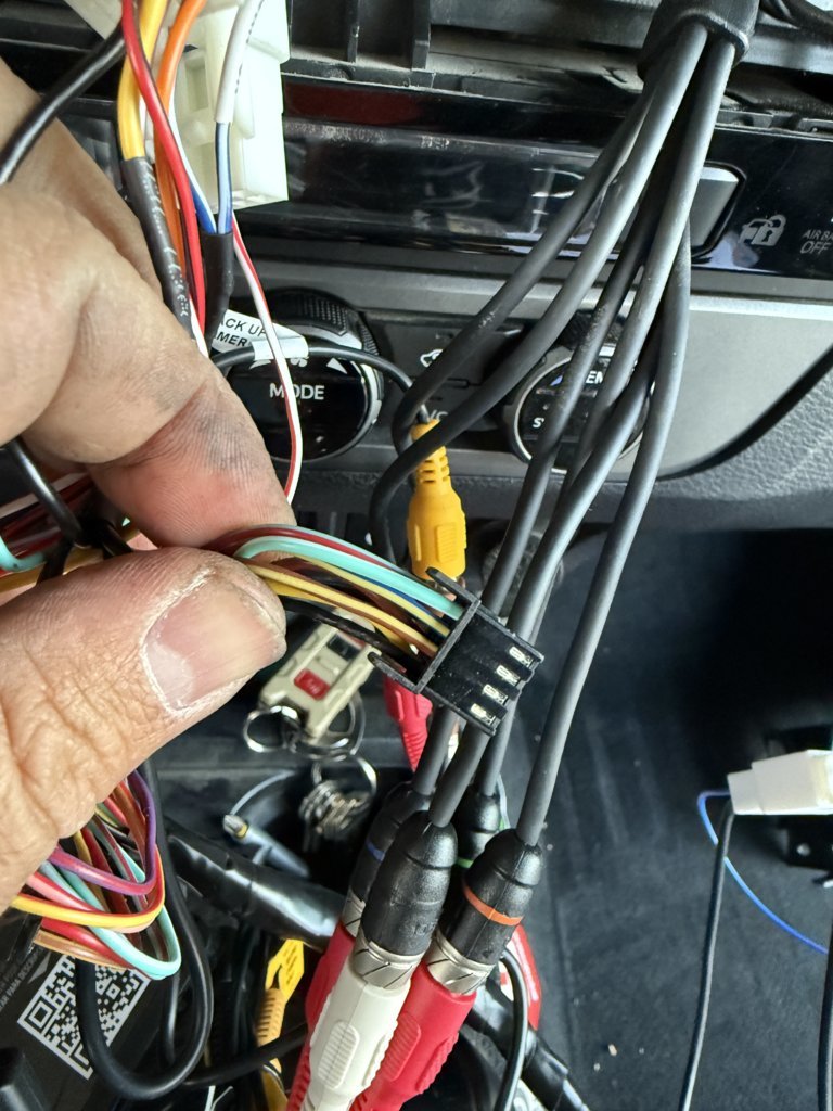

    Anyone with JBL know what to do with this 24pin connector from the factory harness?
    And the black 8pin connector from the iDatalink Maestro?
    I also have an orange 3pin connector labeled ‘Mic’ from the Maestro as well.
    Trying to find why I do not have audio…
    EDIT: I found 2 additional harnesses that came with the Maestro kit and the white 24pin to black 8pin connects the above wires for backup camera. Anytime switch does not work anymore…hmmm
