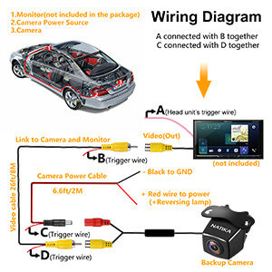

    What did u power the camera with? The little red wire that hangs off next to the rca, or the harness that plugs into it? I tried just feeding the little red wire but it didn’t work. I had to use the power harness and ran the 12v through a switch.

    The red next to the RCA is a trigger wire. C2E62032-6738-4130-8E00-FC9CD68ACA3E.jpg
    Looks to me like you don’t need B, C or D for the front camera since you’re not triggering it? I’m planning to hook the red wire to the blue/white turn on wire and just ground the black.

    It's been awhile since I ran that camera. I traced back a ground that was connected to a bus bar and a tiny positive wire that is connected via add a fuse to one of the ignition on spots. I did see a power RCA connector as well but didn't fully trace that. I will pull the whole thing next time I get a chance to wrench and trace it all.

    I would not run constant 12v ignition to the camera. Have heard many stories of people burning up their cameras. Mine is run through a Toyota rectangle push button with camera image on it. It’s mounted in my dash below the AC controls
