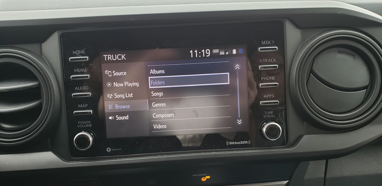

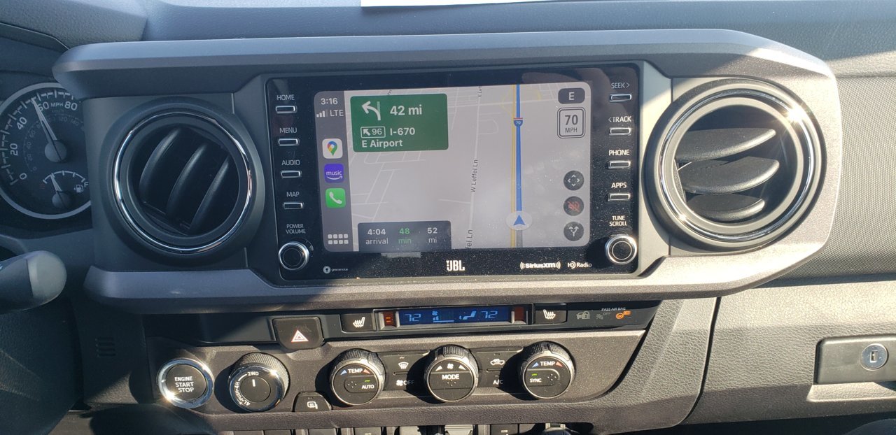

    Sorry for the delay, but you mentioned being able to tell if my bezel would fit the 6600 from a picture. Here's the pic, can you tell if I'll need a different bezel?
    This is from my 2020 SR AC Utility:
    This is from my buddy's 2020 Pro:
    I couldn't tell a discernible difference from the two, but alas, I did not measure my buddy's pro (just remembered to take a quick picture).

    If you haven't confirmed yet, I don't think you need a different bezel with that Radio. I'm pretty sure the older 2018/2019 OR/Sport radios were the same size as that with the premium bezel. Just check and make sure that the diagonal measurement falls in line with the dimensions on the Pioneer unit.

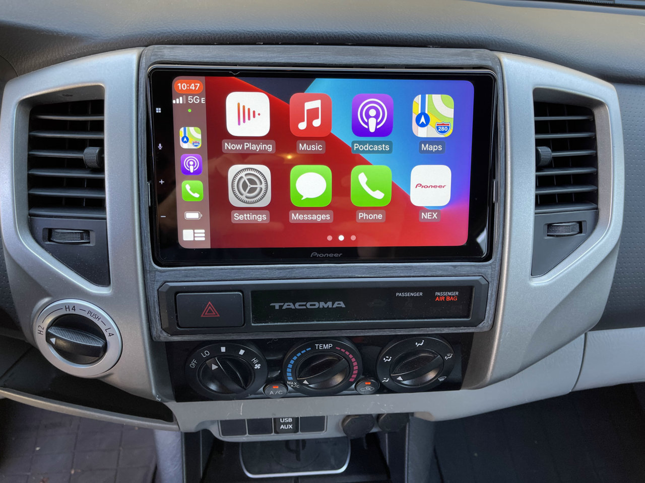

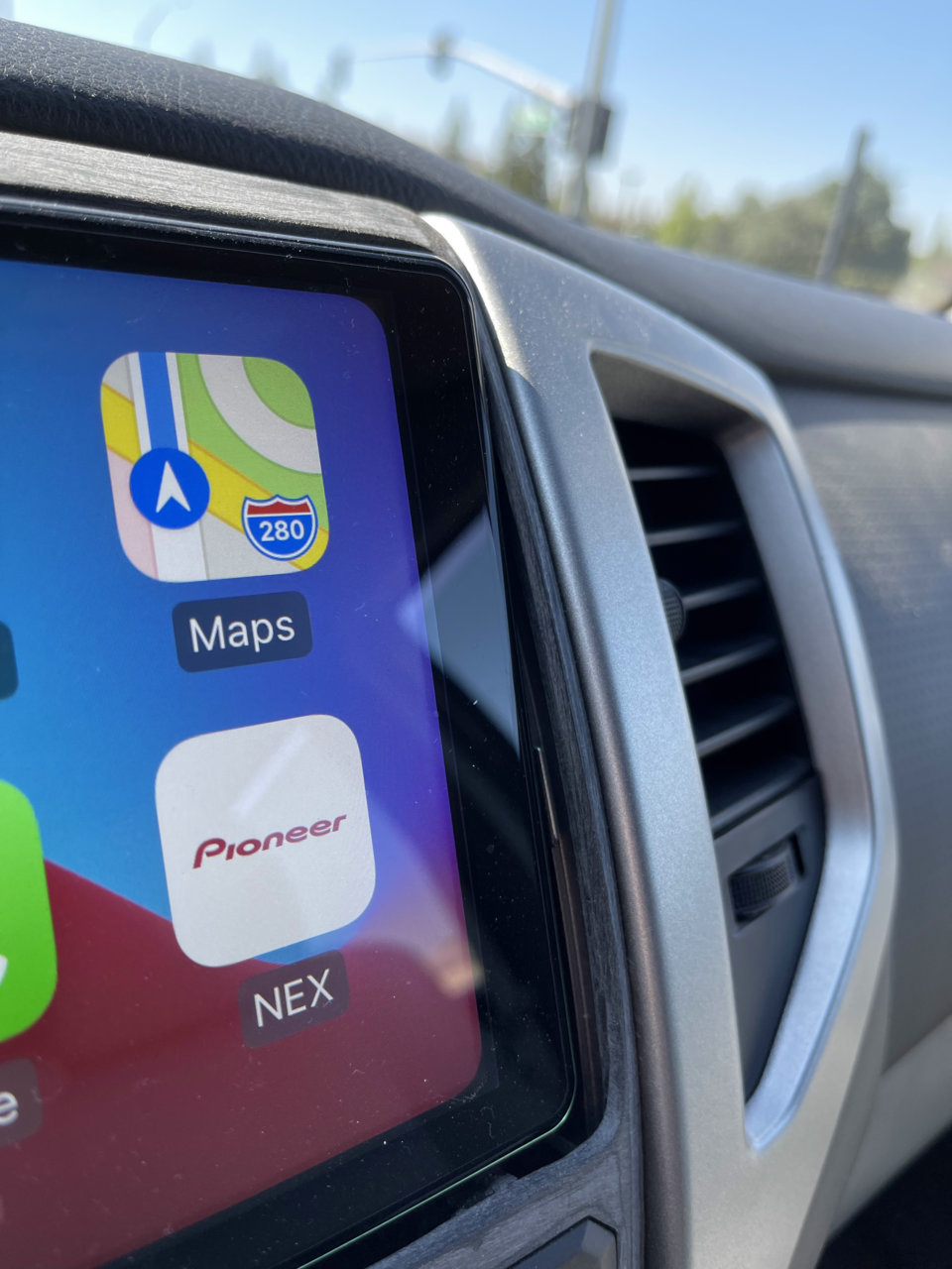

    I love the unit. I use it almost exclusively in CarPlay mode. Things like firmware updates are a little weird and not very intuitive but otherwise things just work.
    The install and wiring was relatively straightforward outside of modifying the trim kit and how “factory” you want things like the microphone, GPS antenna, etc. It comes with parts that are meant to be visible (clips on the microphone, sticker for GPS), but you can hide them if your willing to remove covers, run wires, etc.
    Rough fit of the trim is just removing material and sanding. Once I got rough fit (pic from original post) I lived with it for a while but I’ve spent a couple extra hours on the weekends doing a decent amount of finer finish work (filler, sanding, paint) to make the trim look as close to “finished” as possible. I’ll try and take some pics.
    Mine is still is not perfect because it was a bit of trial and error on removing material and I removed too much in some areas, mainly on the top. It’s not that noticeable now that I’ve sanded and painted it.
    If it really bothered me, now that I have a template, I could buy another trim kit and probably get a better look and fit, but it doesn’t and I don’t want to spend another $60.

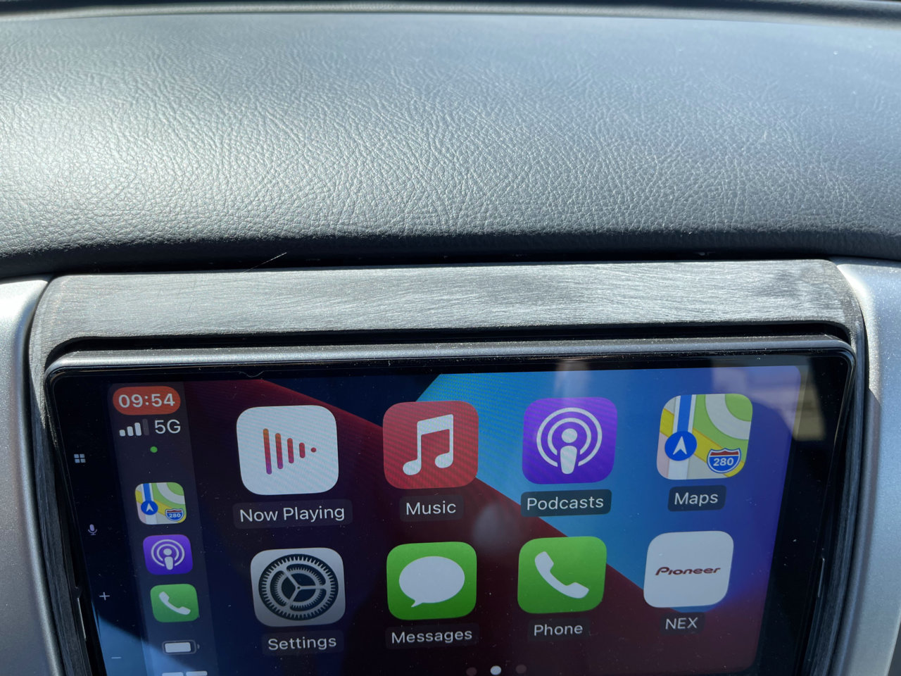

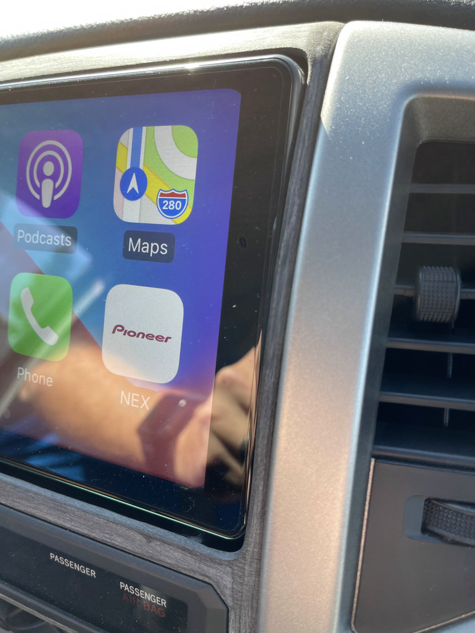

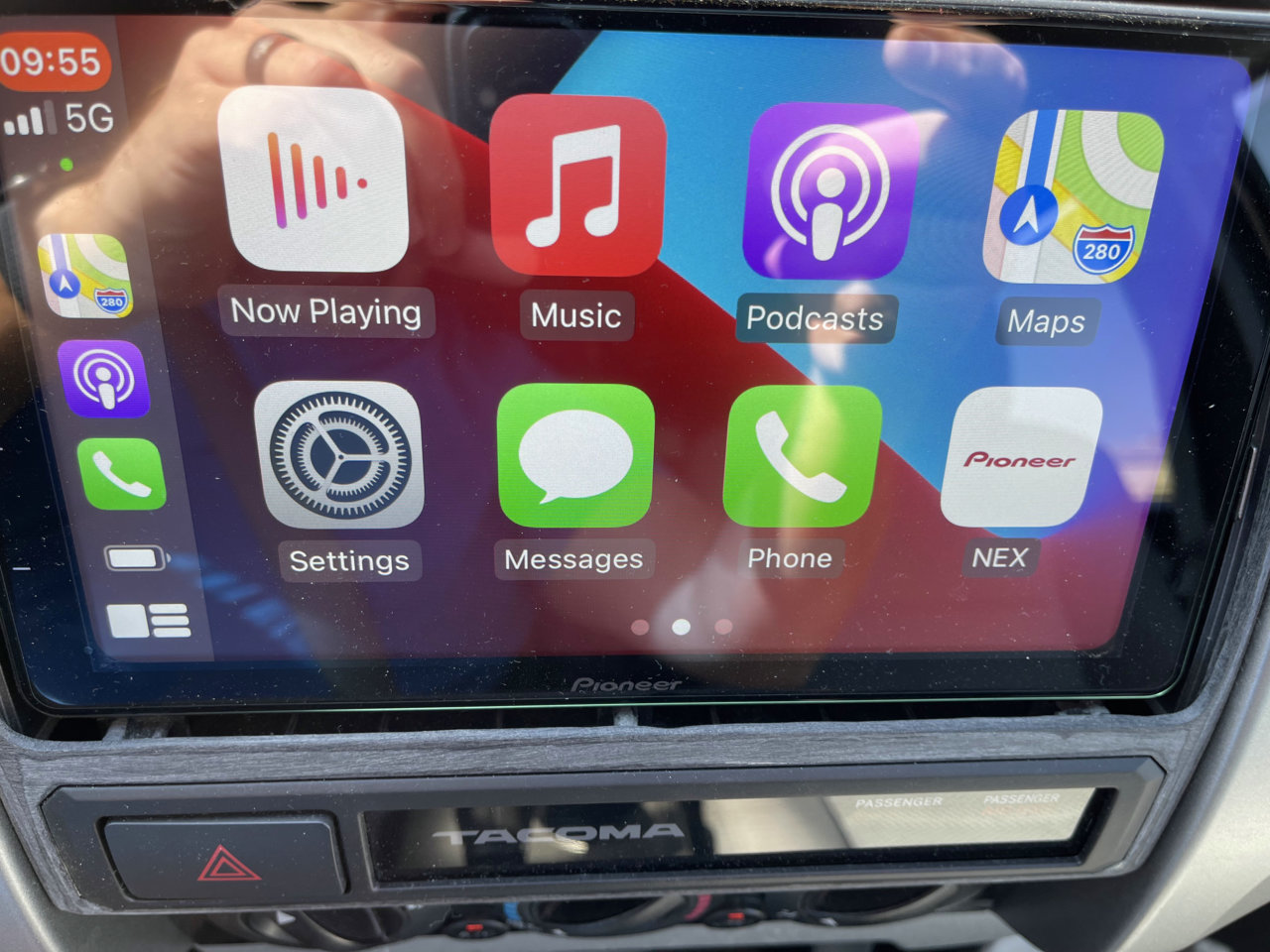

    @foolhardy your setup looks really good man! Would you mind taking some more pics of this setup. Maybe a close up of the gaps and one from further back? This has to be the best possible option for a 2nd gen. I almost attempted this but wasn't sure it would work.
  19. Jul 16, 2021 at 10:52 AM
    #159
    foolhardy
    foolhardy Member
    Oct 1, 2020
    #342494
    7
    2015 Tacoma Sport
    Thanks. Here are some closer pics. The gap at the top was avoidable (I removed too much material when I was fitting). The sides and bottom really aren't because in order to fit around the screen you have to remove the side and bottom bevels. My plan is to glue/fill and then re-sand and paint the whole thing. It won't be "factory" but I like better than the floating screen alternative.

    @foolhardy Solid job man. Could the unit be tilted or pulled forward to eliminate that bottom gap?
