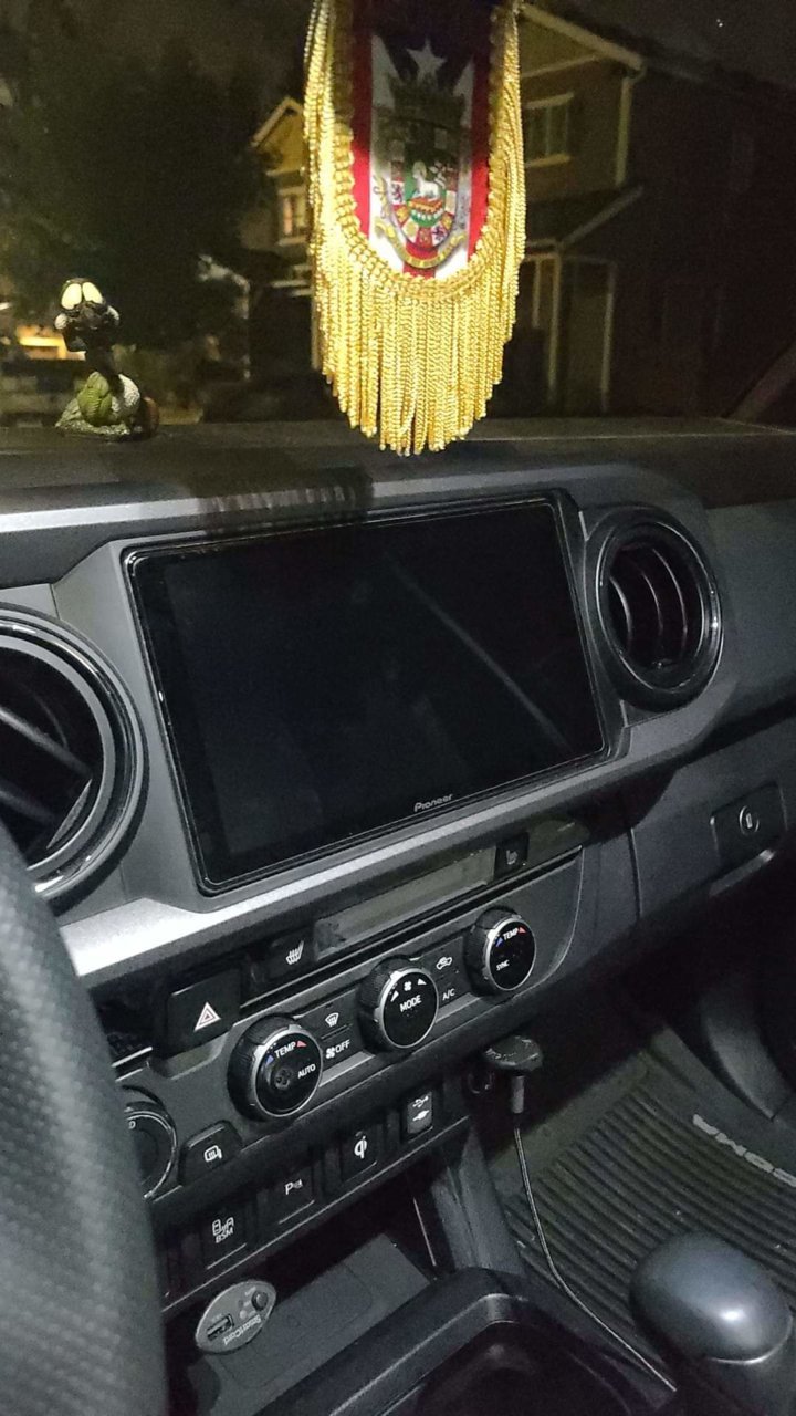

    yeah, with the inventory shortage on everything there were non available when I was looking to buy. I don’t mind the floating unit, in my last vehicle the unit was on top of the dash. It is nice to be able to move it around and find a position you like. I think most people prefer the flush mount though.

    I get that. I debated between the two, but it bugged me that the 8600 ever so slightly overlapped with the air vent edges. Then when I saw I could actually make it flush I jumped on the 7600. I didn't even have to trim the bracket so that took me by surprise. Either way. With either unit, having wireless Android auto was the thing for me. In my 2010 subi I've had witless AA for a few years and was surprised to learn when I was tacoma shopping this month that toyota was so late to the game in just having Android auto at all. Let alone wireless. I bought used 2017 taco and already factored in the cost of changing the head unit. Along with a tailgate remote unlock, and remote start kit. Couldn't honestly believe there were still push button starts after 2010 that didn't have remote start lol. Like come on toyota, you trying to keep those things for the Lexus line? Seemed silly, but otherwise I'm loving the truck

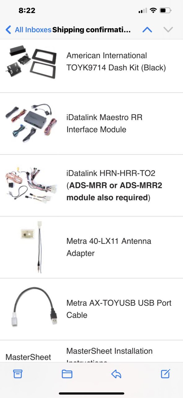

    So i just bought the 8600 will be installing today or tomorrow anything i should be aware of? I did buy the maestro rr and harness. Where did you mount the gps antenna?

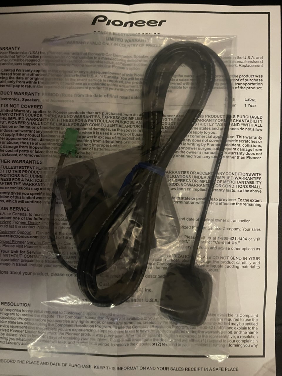

    You might have found out by now, but you don't need to use the GPS antenna that comes with it. You can get an adapter that will connect the factory GPS antenna to the head unit. I still think it's dumb the head unit needs a GPS antenna at all since it doesn't have built in nav but eh....

    How about an adapter for the rear view cam and steering wheel audio. Thinking about grabbing this, an amp and a sub to replace my OEM Audio + sub setup. I just want google maps and Pandora lol. But I do like having the map up with the audio controls as default. Doable?

    Yes. Both factory camera and steering wheel controls work. With the maestro you can even program the steering wheel controls to behave differently. For me, I made up and down volume, and left and right the seek/next buttons because that makes way more sense to me. No special adapter is needed for the camera as it's tied into existing harness. Just get all the stuff Crutchfield recommends. What they don't have on there is the GPS antenna adapter so you can use your taco's factory GPS antenna instead of having to place and route the one the comes with the head unit. It's odd they don't recommend it but eh. Come to think of it I might have actually bought that specifically on Amazon when I bought the tailgate remote lock and remote start kits.
    Oh, and if you're aiming for a flush install, solder, don't crimp. Not a lot of room back there when you go flush.

    Were y’all able to retain the factory gps with the Crutchfield kit? I’m going to install this thing tomorrow when the Crutchfield kit gets here, and it seems I’m gonna be using the gps that comes with the unit. I thought I could retain the factory gps?

    negative. gps is now from your phone. You could always buy an aftermarket Garmin.

    Odd, is this not a gps antenna. This came with unit.

    Yes it is GPS receiver. The head unit uses GPS signal to set time, as well as disable some selections in settings. For example dimmer time settings can't be accessed while in motion. It's kinda dumb I think but it is what it is. I bought an adapter that will connect the factory GPS antenna to the head unit so I didn't need to run that one anywhere.
