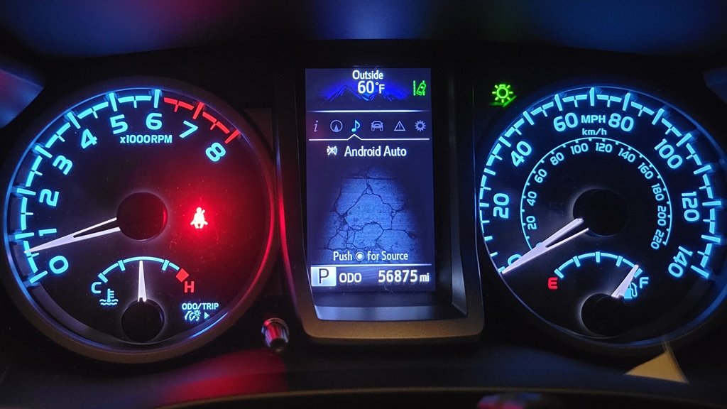

    I just installed a Pioneer DMH-WC5700NEX and Maestro RR in my 2018 Tacoma Sport w/o JBL. The only issue I have is that every time the vehicle is started, the center information display in the dash will not display what is playing on wireless Android Auto/Spotify. I have to change sources to get this information to display. It is fine for the rest of the trip, but next time, I need to toggle the source again.
    Has anyone encountered this and found a solution?
    Pictures attached for the initial condition.

    Haven't found the solution to this yet. Crutchfield and Maestro have been looking into it. Easier now than changing the source, I can just press the microphone button and when Google asks what you need, the info panel starts displaying properly. A nuisance, but not a big deal. With the previous HU, I would have had the compass always displayed there. Now just looking for something useful to fill that space 90% of the time.

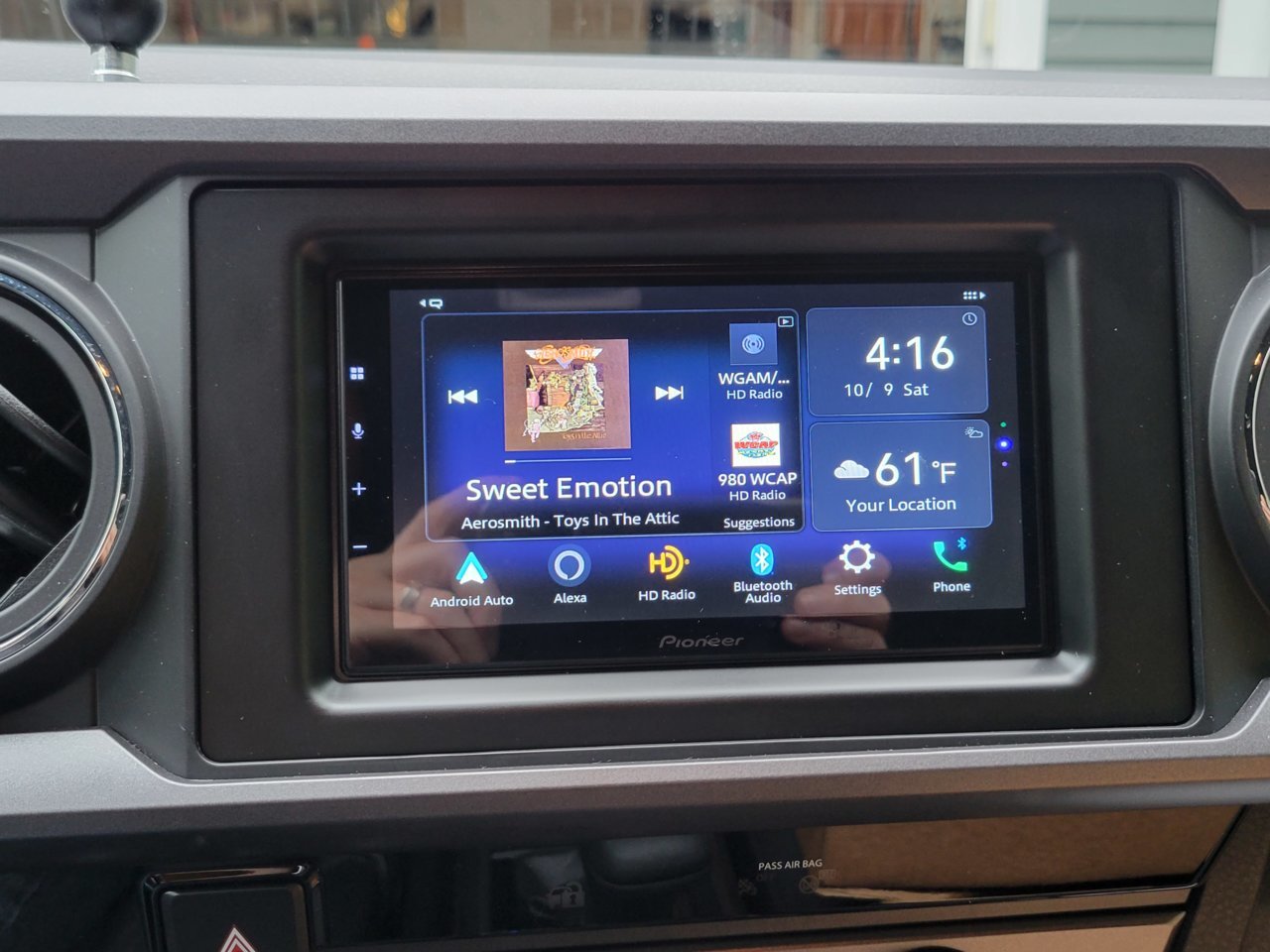

    Could you post some picture of the radio..I’m searching for a new HU and looks good on crutchfield

    Installed with trim kit from Crutchfield:

    In case anyone stumbles upon this thread in the future, Pioneer recently released the 2.0 firmware for the head unit and my problems with the Tacoma display have been solved. My head unit was on version 1.31 prior to the 2.0 update.
