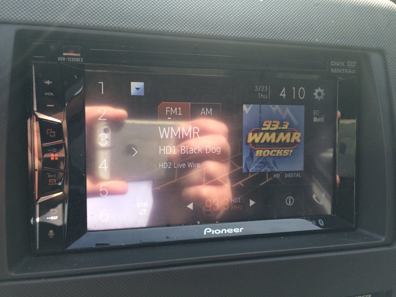

    Here is my current head unit...
    It is a Pioneer AVH-1330NEX. It has Apple CarPlay, Bluetooth, HD Radio, satellite radio, and all that fancy stuff. Unlike the Boss it replaced, it does not have navigation, but I still feel like it is a huge upgrade!
