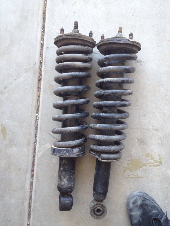

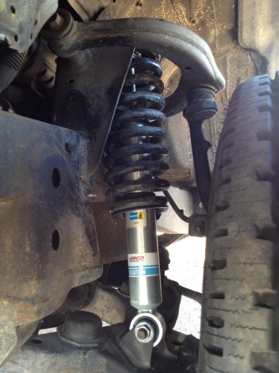

    did my 5100's install today sorry not a lot of pics was more worried about getting it done right lol
    88BE5E9B-2605-4A2A-9707-F4E10A513750-141_292142762ec493d344bcae4057f015087e2d6b18.jpg
    1E9758E5-96A3-447E-8903-27F6F1FBDA96-141_e9a481aaeb8f7dde5e5f3cbdbc1dc8fd78f88c13.jpg
    79BAC990-B21E-44F1-9D79-60E3811BD836-141_56eea8c259ec327a9d5d9639fdeb1321e372c59b.jpg
    BF559E7E-CE25-4E10-8145-D01BDE819E36-141_d4098aa0f302069cb6ae2abb7e6fcdf008f979c1.jpg
    51E25080-2B4B-484C-8767-78309627F16C-141_231996f9eda809c4ff15159aecde4e8cb7c7e944.jpg
    AC1F09BF-7D0C-4243-A4D5-5B68AF79760A-141_f1d7436ceddad3a13355ea2234af51504ca0d371.jpg
    was really simple

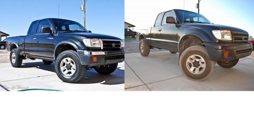

    comparing "stock" to new 5100's on the middle setting

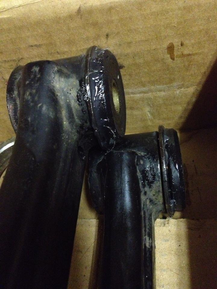

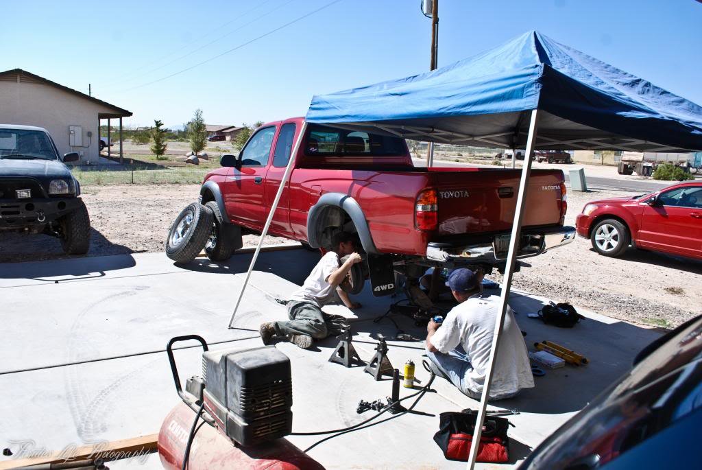

    ordered some new parts..
    replaced my bumper :D

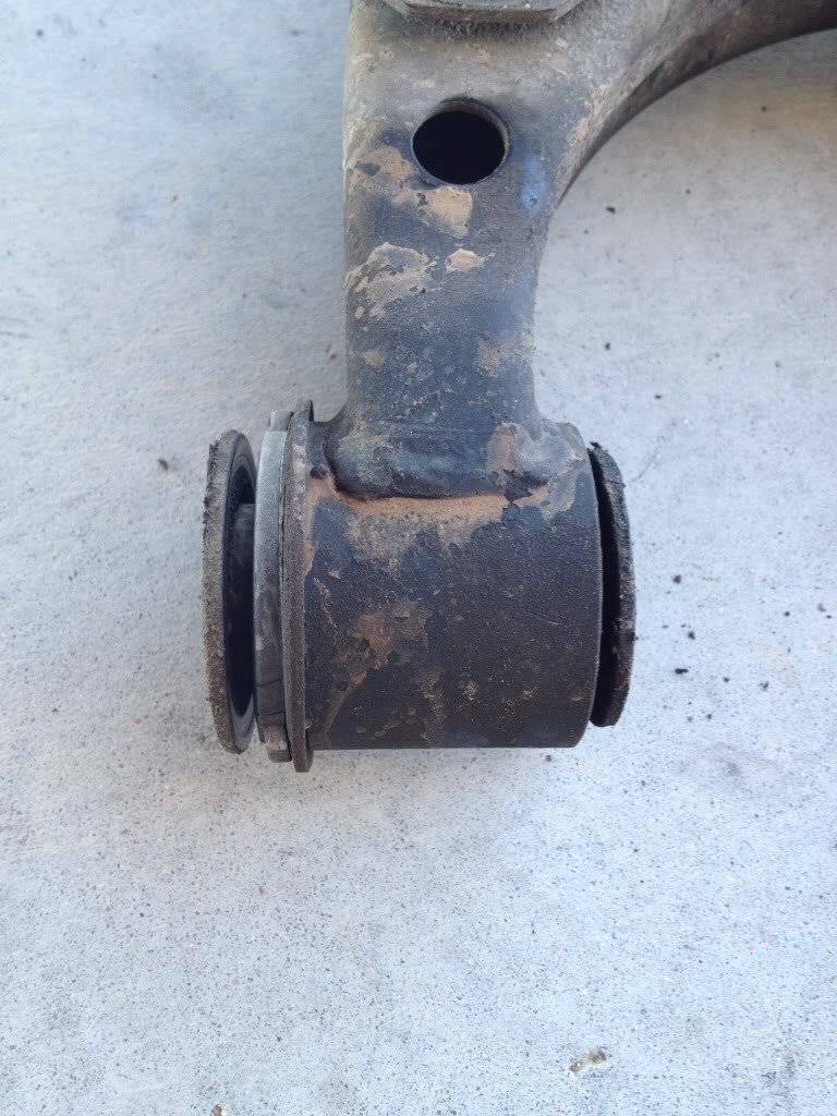

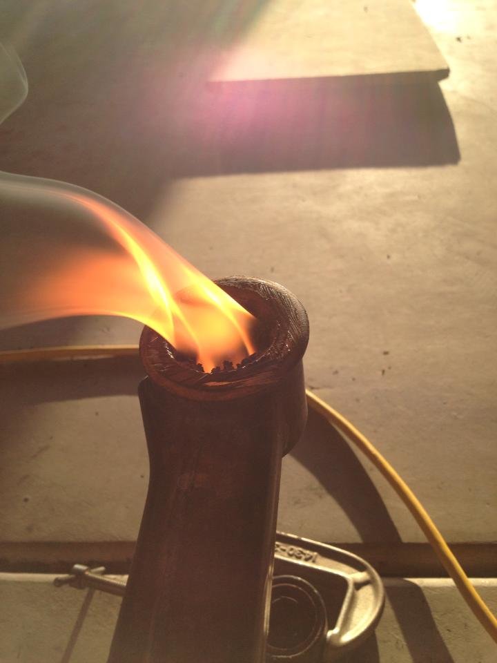

    took out old bushing from my control arms
    then put some new ones in :D
    getting my new rack and pinion this week so ill be putting that and my new tie rods and ball joints in next weekend wooo

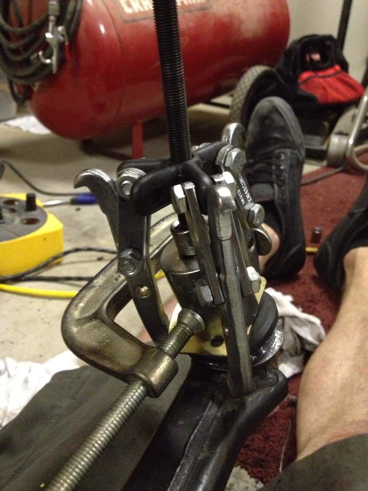

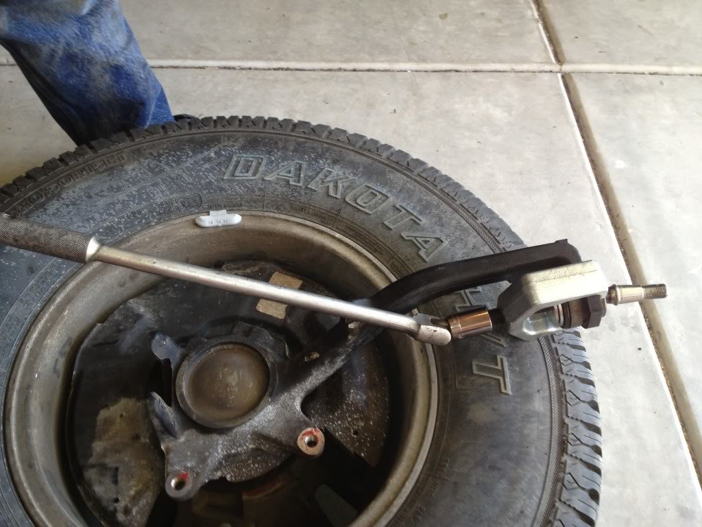

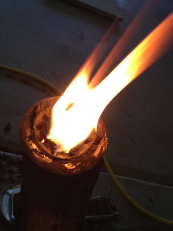

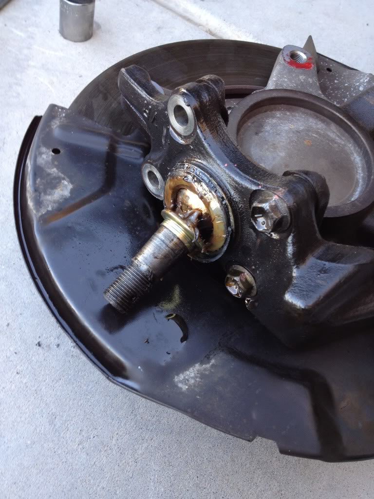

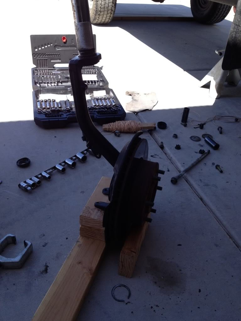

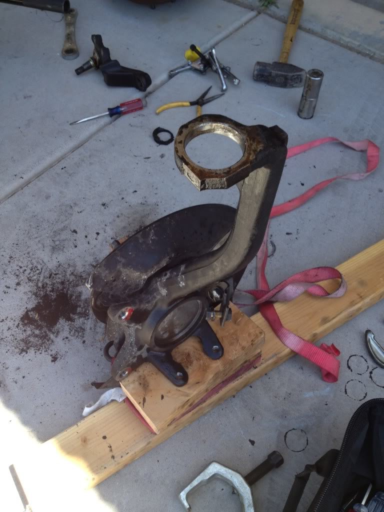

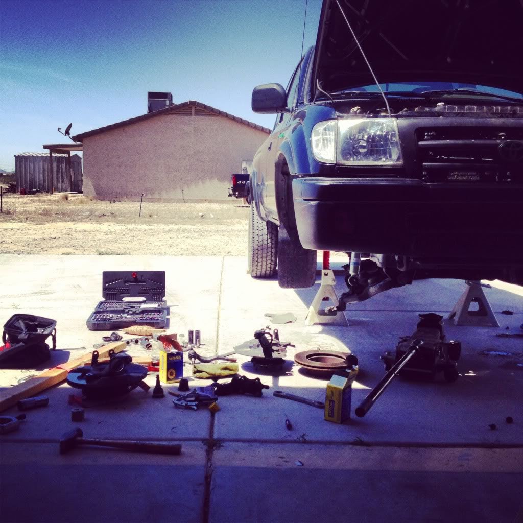

    well i had a very eventful weekend. i finally got all my worn out steering components replaced
    old lower ball joint this is one thing i had to replace that i didnt know was bad
    getting my old upper ball joints out. an old bicycle peg alone with a big sledge hammer worked amazingly
    my mess
    i didnt have a vise so i attached the spindle back onto the tire so i could get some leverage on the bar to press in my new ball joints. i ended up going to autozone and renting the ball joint press. which worked amazing i would very much suggest renting one if your going to replace anything that needs pressed in or out

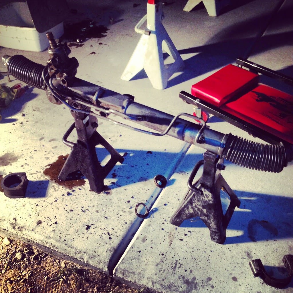

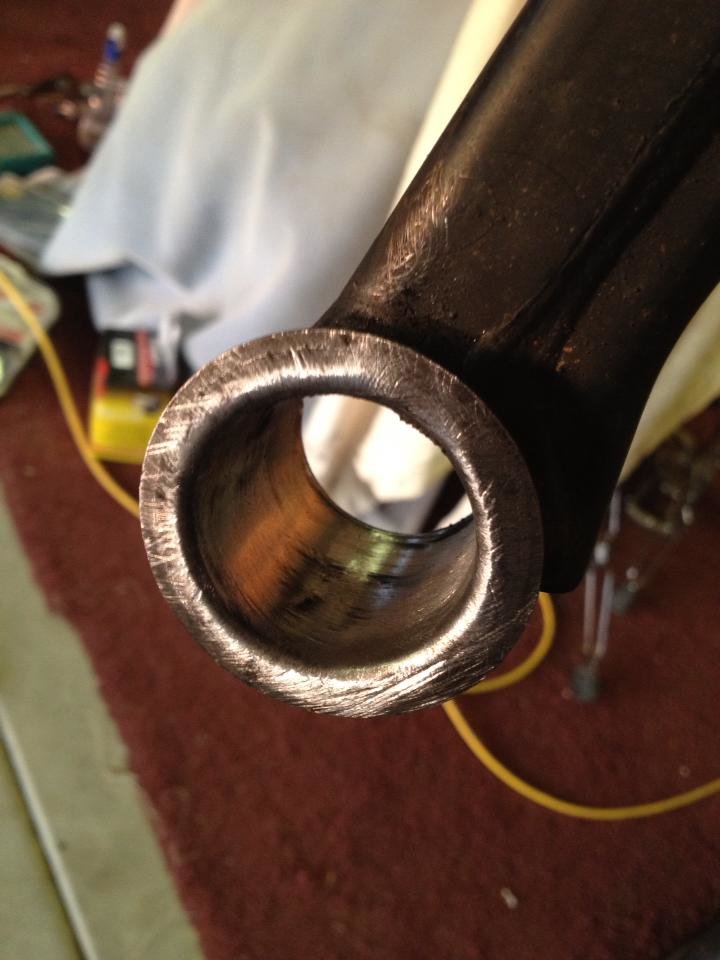

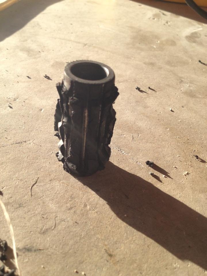

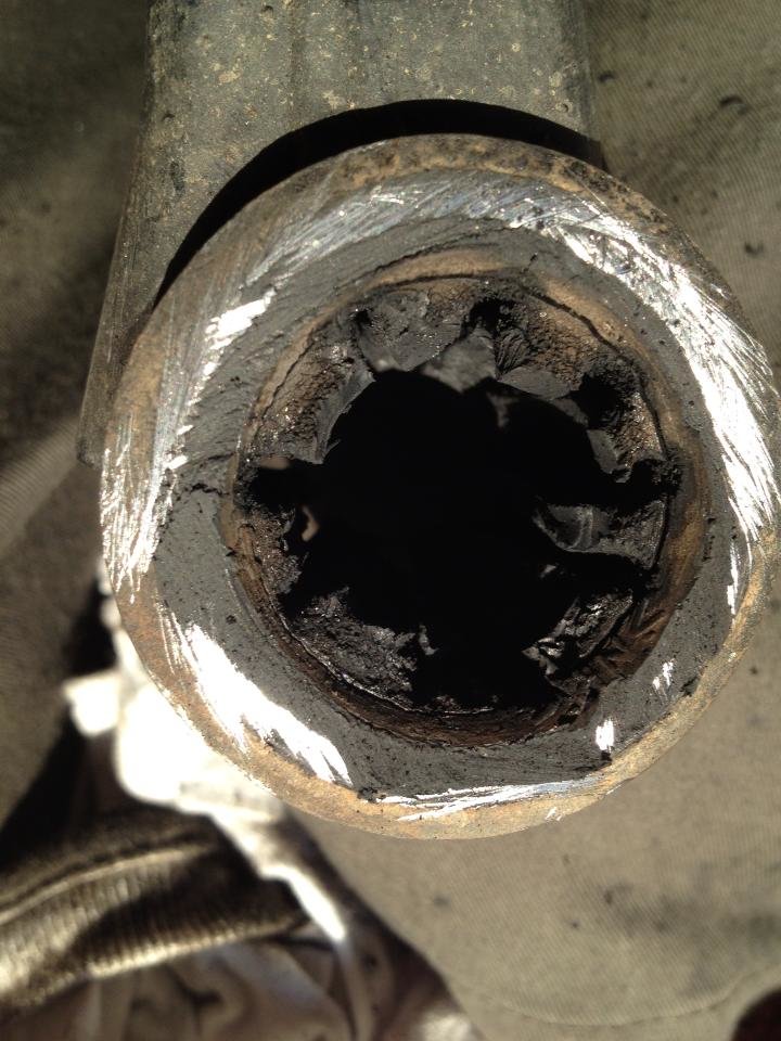

    got my old rack and pinion out!
    working into the night
    i had so much play in the old bushings that when i got one of the washers off the sleeve, it just fell out of the housing.
