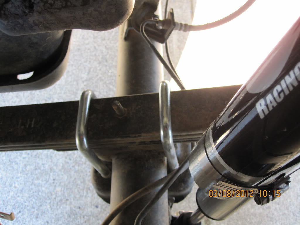

    So heres basically my dilema in a nutshell: The previous owner for whatever reason didn't have bumps on here when I purchased the truck. That's why I had to order some from wheelers to keep my precious new shocks safe :cool:
    If you have anything that can just screw on to the center pin, that'd be ideal jason, but i think its unlikley there is a bump out there like that. If I get stock bumps from someone I should probably put them on now instead of having to fuck with all of this out in the sand.
    Here's a quick picture: Normally the stock bump is held on by the centering pin and has two legs which extend out and are held on underneath the Ubolts.

    Ah ha!!! I remember now.
    The second gens have a bump that has a hole in the bottom of it that fits over the centering pin and is held in place with the u-bolt clamps.
    Similar to this:
    http://www.polyperformance.com/shop/Daystar-Bump-Stop-w-Slotted-Mounting-Plate-p-26472.html
    Did you (or previous owner) change out your leaf pack or just put in a AAL? That centering pin is long! You'll have to cut off the excess threads. Lemme PM a couple peeps to see if they have the stock bumps.

    We put the wheelers 3 leaf AAL in. The center pins were super long and that picture is half of it already cut off. Just got to cut off the rest when he gets bumps.
