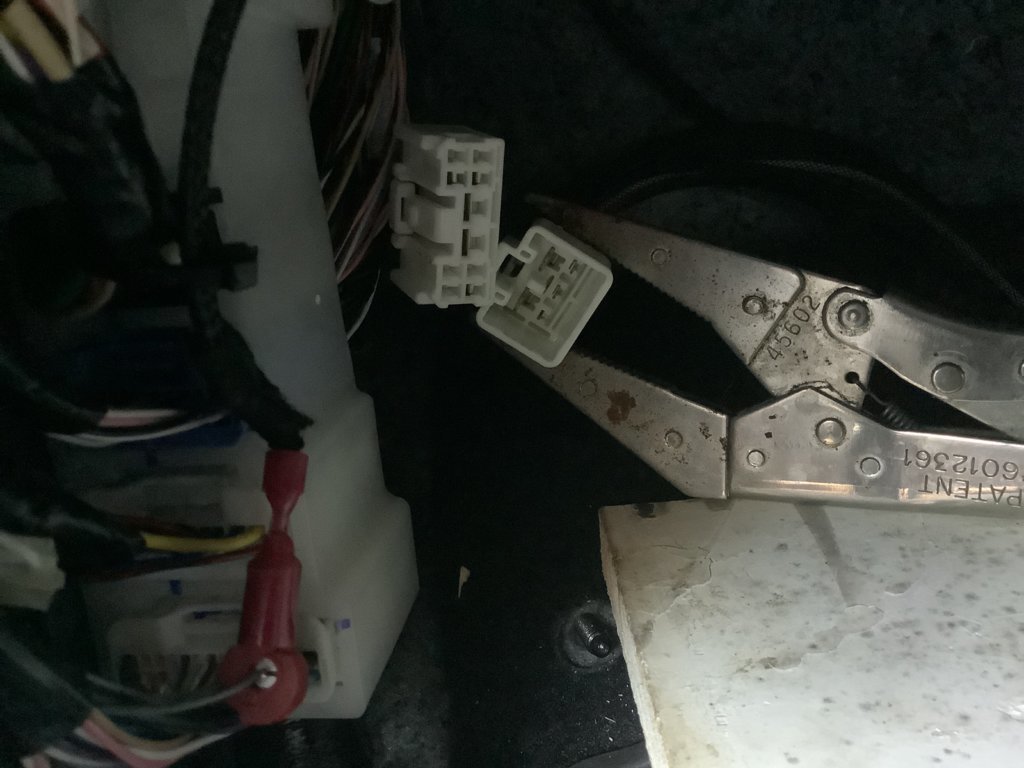

    dirt clod
    dirt clod Active Member
    Apr 4, 2024
    #447280
    41
    Greg
    2023 Tacoma
    Same issue here. The Tacoma plug I found is not compatible with the REDARC. Left is Tacoma, right is REDARC. Can’t seem to find any others in there. I will have to wait until 1:30pm to contact the support team, being as they are in Australia.image.jpg
  9. Aug 11, 2025 at 11:47 AM
    dirt clod
    Apr 4, 2024
    #447280
    41
    Greg
    2023 Tacoma
    After a little research, I discover the tph -021 harness received, is wrong. Should have been the tph-015.
