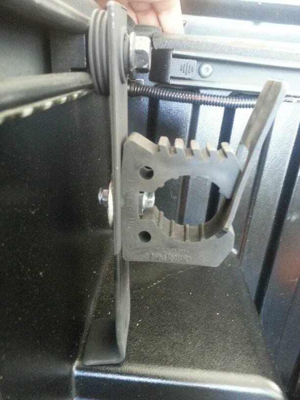

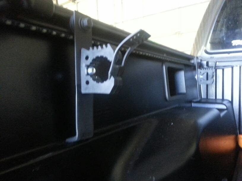

    Advantage torzatop installed. I was NOT able to make the t-handle clamps work without the bed rail brackets... :mad: Those T-handle clamps won't even tighten enough to suit me, the cover is tight to the bed but the clamps flop around like a limp .... you know what.

    Glad he is happy with it. Is it possible to add some finder washers to tighten it up a bit?
    I used the 1-1/2" plane flat steel bar 1/8" thick. Only tools I used for the bend was a vice and a sledge hammer. Bent it over about 3/4 of the way by hand and then took the sledge to it. I was surprised at how well the bends came out. Also they are not an exact 90° bend, but more like 95° to help wedge the bracket onto the ledge in the bed of the truck. I have yet to paint mine. Maybe this will be some motivation, and I'll post some pics to show what I'm talking about.
    I'm still looking for something to wedge between the steel and composite bed keep the brackets from "shaving" the plastic down from the normal bouncing around that happens back there....just had an idea for that. I've still got the holes from my bed mat that I cut out. I think that they could work well for what I'm trying to accomplish.

    I have a video of how the clamps flop around, i'll post it and see what you think.
    I don't know how to remedy it.
    What about a rubber or silicone cover to the ends of those pieces of metal to keep them from rubbing the composite bed?

    In this video, you can see how the clamps flop around...i want them to stay perfectly verticle but when i hold them there...they spring right back to the awkward position again.

    Can you stack some fender washers in that gap in the threads to keep it more vertical?

    The more tight it is, the more it wants to be cocked...i see what you're saying but i have to have it be as easy for him to operate as possible.
    Less moving parts = better
    lol
    I was thinking of something stuffed up in that shinny metal bracket in the bed rail, to make that clamp only have so much to grab but :notsure:

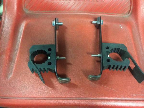

    Found some 1.5" flat stock gonna make that work. Going now to get stainless hardware. Hoping to use stainless wing nuts on the back of the quick fists.

    Cool man, why the wing nut? Do you plan on removing the quickfists from the bracket often?
    I just got mine painted today and dipped the base to keep them from rubbing the lip.

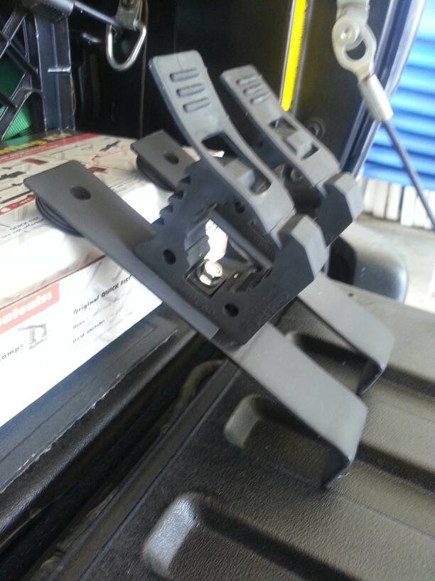

    Two things, i put silicone covers on the bent part of my mounts to keep them from rubbing into the bed...i also want to space them out with washer like you did though...that was a great idea :thumbsup:
    Annnnnnd, have been wanting to do my engine cover like that but with blaze blue plasti dip on the emblem and lettering :cool:
    Also, i ended up not going with a wing nut, i went with 10mm stainless nuts washers and bolts to hold the quickfists on the flatstock

    My silicone covers? Um..... :D the hospital....the were on some sort sharp instrument to keep them from poking through their sterile packaging.
    Its a part that they normally throw away with packaging anyway so i figured what they hell, i'll try them.
    They fit 1" flat stock beautifully:

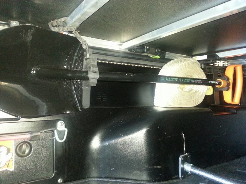

    Fantastic! Did you go with the elites? How do you feel your install went? Mine was a pain in the ass but they make every tacoma owner without them soooooo jealous :D
    You also should see my newly modified shovel mount :D

    Yes, I went with the elite and picked them up on the TW discount. My install was really pretty easy. I borrowed a friends professional rivet gun and a buddy gave me an extra hand. Having all the right tools makes all the difference.
    Yeah, I'm jealous that you have the room for two tools. My shovel (which is bad ass) takes up too much room to add an axe. I plan on mounting one on the front rail soon.
