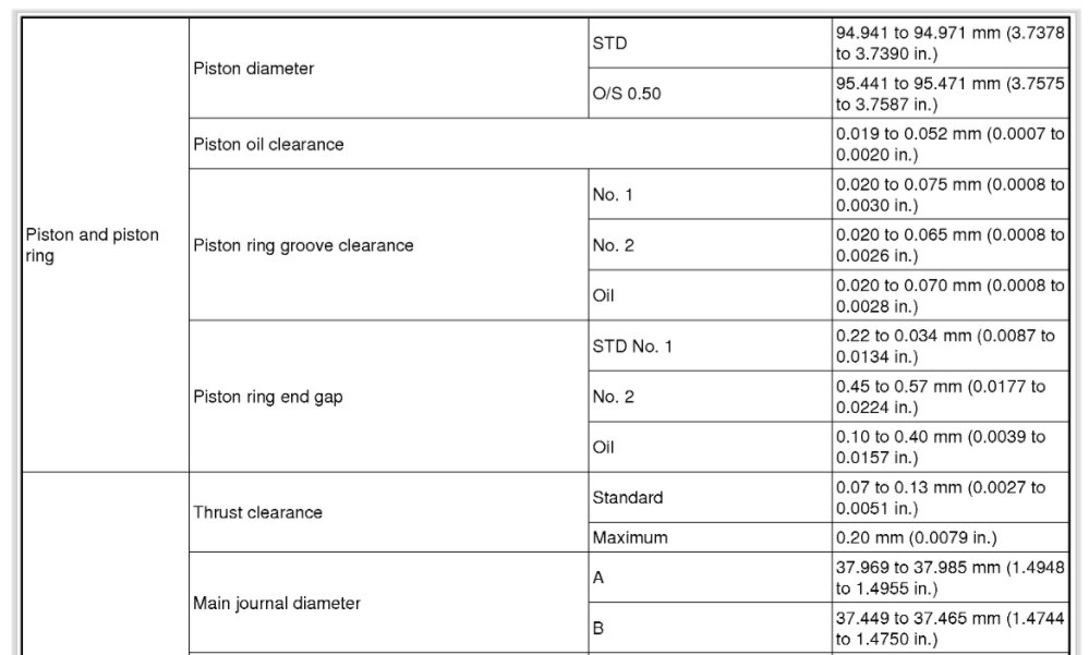

    Hey mates, I cannot seem to figure out the standard size of piston ring I need for my 2008 2.7l 4 cylinder 16v engine

    If your rebuilding yourself, I would guess it would be in the factory service manual

    From Alldata
