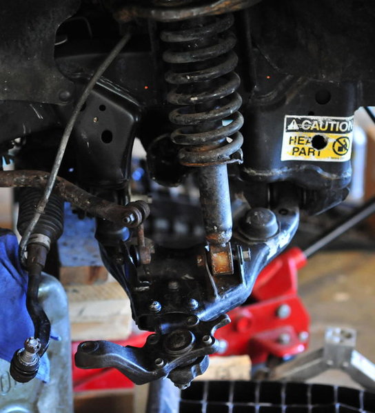

    I'm going to break out the Sawzall in the morning if no one has any helpful suggestions on getting this miserable bolt out of the lower shock mount. Seems to be seized to the bushing inside. Ive tried beating the ever lovin' shit out of it with a 3lb maul and as you can see from the picture, all that accomplished was to bend the mounting tabs.

    Pugga

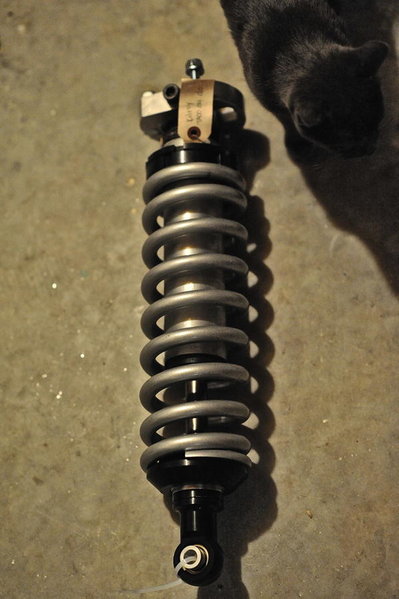

    This is what is replacing the stock equipment along with Camburg UCA's.

    Yeah, I'm not over thinking so much as not wanting to tear up the rear mounting tab. If you look at the picture in the original post, you can see that the shock is up against the rear tab so when I take the SawZall to it (as I will first thing tomorrow), I'm going to tear up the inner face of the rear tab. Just wanted to avoid that if I could. I will need to cut the bolt on both sides of the lower shock mount.
