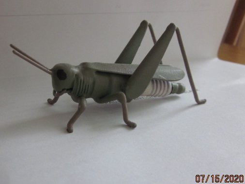

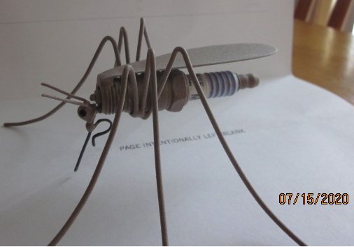

    Yes, you a right. I grew up working on cars, motorcycles, and other mechanical things, sometimes making things myself. With a welder still in my garage, I still do some welding repair and fabricating. Sometimes even getting a little creative. Made from '87 Ford Ranger 2.9l spark plugs, all hand made and formed. My very first one ever made was a project in my high school metal shop class where I learned to weld. Granted, it didn't look like either of these but, it was worthy of a grade.
